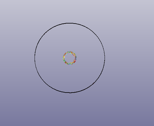

      I displaced some beam elements axially in a first step and now I want them to springback in the second step. I am using the dynain method so I have defined the following card:
      *INTERFACE_SPRINGBACK_LSDYNA
      $#    psid      nshv     ftype         _    ftensr    nthhsv     rflag   intstrn
               5         0         0         0         0         0         0         0
      Here is the material model:
      *MAT_SHAPE_MEMORY
      $#     mid        ro         e        pr
              63 6.4500E-9   51700.0       0.3
      $# sig_ass   sig_asf   sig_sas   sig_saf      epsl     alpha      ymrt
           600.0     670.0     288.0     254.0     0.063       0.0   47800.0
      The second model seems to be set up correctly. I copied over the *PART, *SECTION, and *MAT keywords and also included the *INITIAL_STRESS_BEAM card:
      The model runs successfully. In the second simulation step. But no springback is seen. No deformation of any kind is registered. They should springback to the diameter of the red shell that surrounds the beams.
      Is there a card I need to apply to get the stresses to be applied in the second simulation?

    • Ben_Ben
      Hi Reno,
      Yes I copy the contents of the dynain file to the 2nd simulation input file and then I copy all the part a material data from the 1st sim file. And yes I have seen the appendix X.
       I can see all the initial stresses in my .k file for the 2nd sim, so I can't work out why its not springing back. Are there any limitations to using dyna with beams? Or is there a step I'm missing?

    • Reno Genest
      Hello Ben,
      I got a reply from the developer and there is currently limited support for *MAT_SHAPE_MEMORY and dynain.lsda. You would have to use the latest DEV solver. If you have access to technical support, you can file a case and we will send you the latest DEV solver for you to try.
      customer.ansys.com
      Reno.
