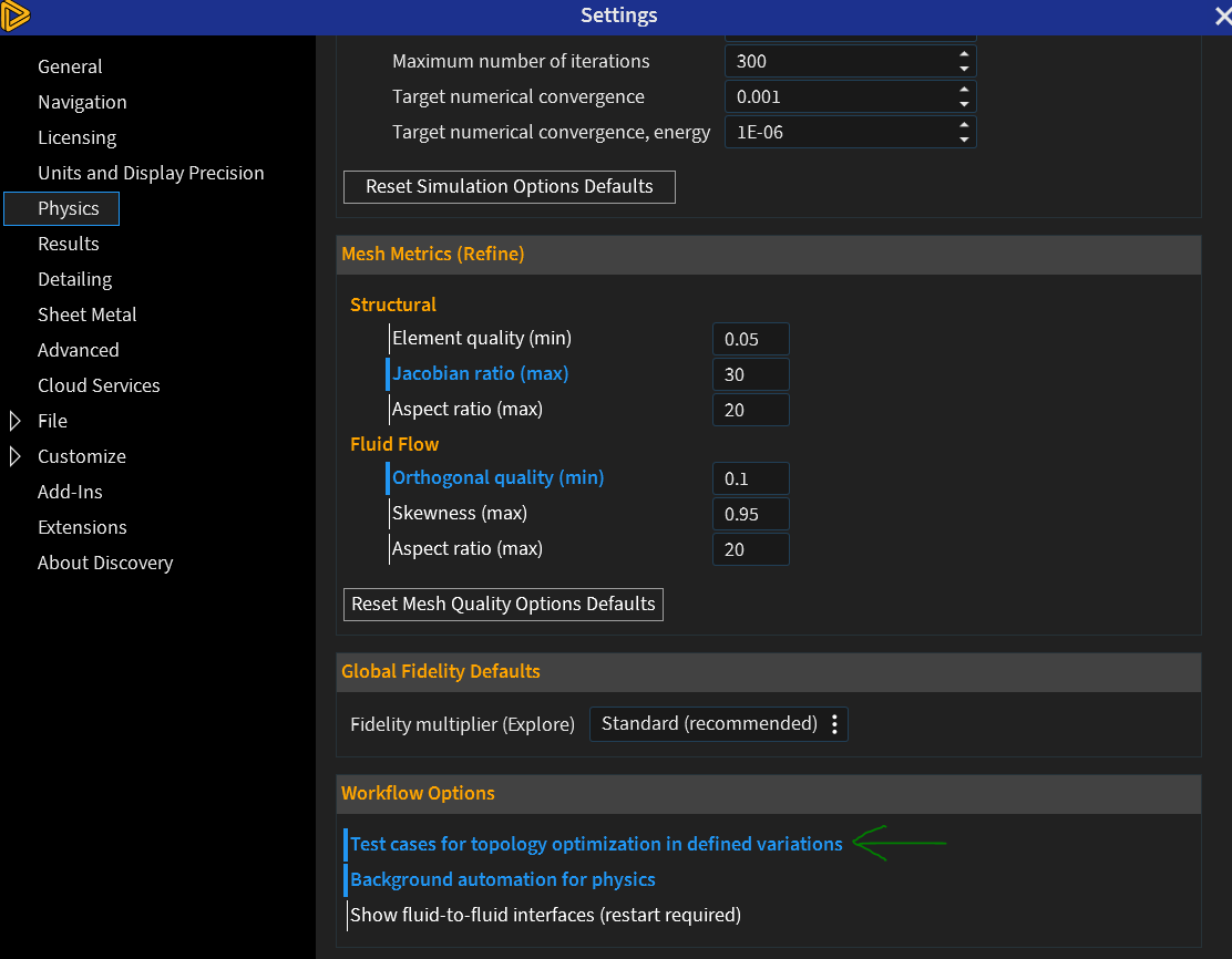

SubscriberIs there a way to include multiple simulations in a Discovery topology optimization?
I would like to consider multiple scenarios with different support approaches and I don't see a way to enable and disable supports with parameters as is suggested by the current documentation (https://ansys13.ansys.com/KnowledgeArticles/Discovery/Knowledge_article_Topology_Optimization.pdf)

SubscriberHello,
You can change the workflow from here:
Refer to this tutorial to understand the older workflow: Discovery Quick Tip – Multiple test cases topology optimization (old workflow, 2022R1 and before) | Ansys Knowledge

SubscriberThat's exactly what I was looking for. Thanks for the help!
