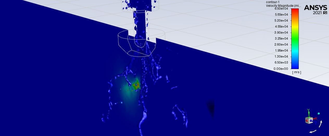

May 18, 2021 at 1:52 pmsmarx2 SubscriberI am using R2021 VOF-to-DPM for simulating a nozzle, and am having my simulation error out due to high courant number. I tried smaller time steps, coarser mesh, etc. but found that the problem continues. I decided to plot the courant number and it showed that my courant number was exceeding 1000. So I then plotted my velocity magnitude to see what was happening. In a configuration where I wouldn't expect more than 100 m/s velocity at any given point, the simulation is showing up to 65,000 m/s (image attached is the plane parallel to the vee cut of the nozzle and the iso surface of multiphase interface). Any ideas on what I'm missing or what's happening? May 18, 2021 at 3:33 pmRob Forum ModeratorThat suggests the model was diverging before that time step. If you go back some steps are you seeing any convergence issues? Also check the mesh in that region, look for cell quality, cell size change and whether you're resolving the flow.

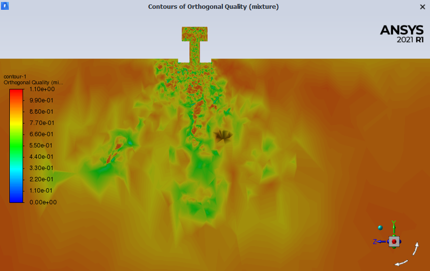

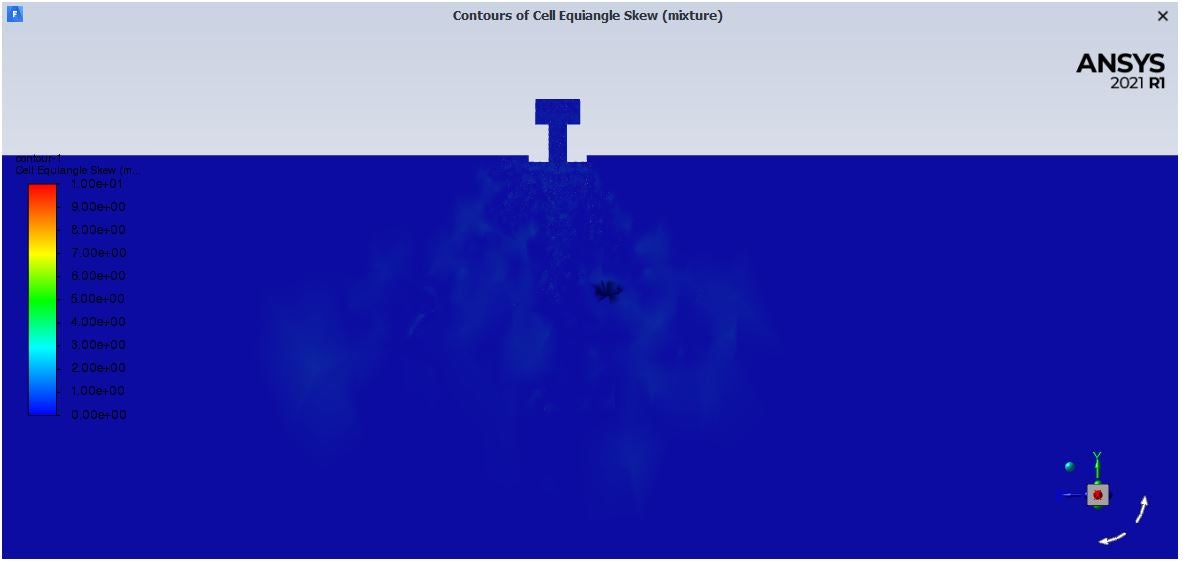

 May 18, 2021 at 3:57 pmRob Forum ModeratorIf it's a hex mesh quality should be fine as the adaption should turn it into smaller hex cells. If you look in the reports or contours there are skew metrics under mesh: check what the ranges are.

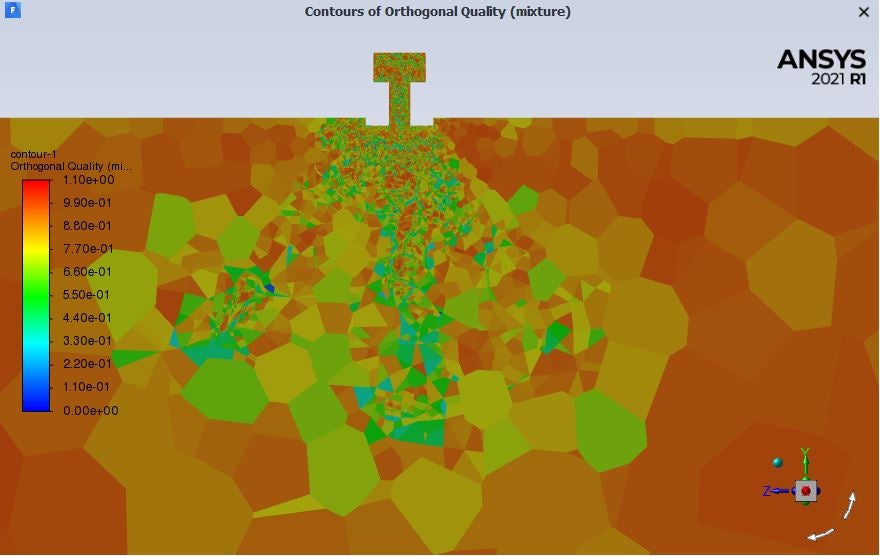

 May 19, 2021 at 2:57 pmMay 19, 2021 at 3:17 pmRob Forum ModeratorPossibly, turn off node values and alter the range to see what is going on in that area.
 May 19, 2021 at 3:29 pmMay 20, 2021 at 7:41 amaitor.amatriain SubscriberCould you please post some mesh pictures? For example, the initial mesh, the mesh just before Co<1 and the mesh just after Co>1. As Rob wrote, it is interesting to detect that transition to see what is happening. Just some data with Co>>1 does not help to detect the problem.

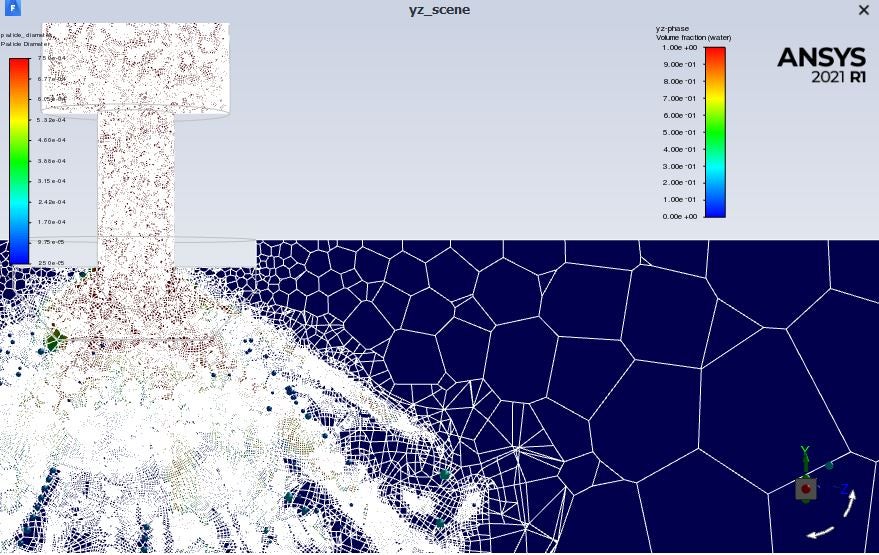

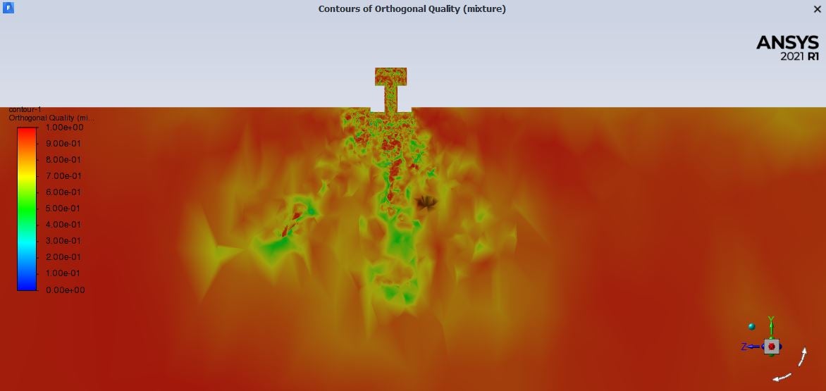

 May 21, 2021 at 2:44 pmsmarx2 SubscriberAitor and Rob It appears to have to do with my adaptive grid criteria. I attempted to re-mesh the domain and re-run the model. The Courant number again spiked, and did so as the interface reached the larger cells.
 For the model, my minimum droplet size is 50 microns, so I calculated that to have two cells across with 8 levels of refinement, my maximum cell size is 6.4mm (.05mm/2=.025mm... .025mm*2^8=6.4mm... hopefully I did that correctly).
 Could my issue be a misunderstanding of the adaptive grid criteria?

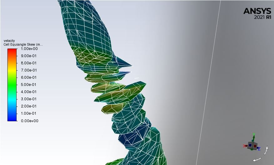

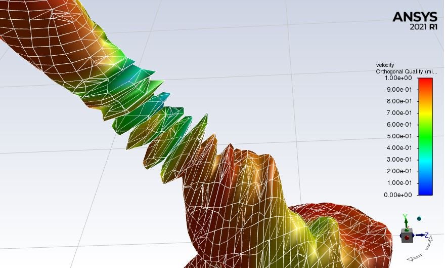

 Here's an image of the mesh during adaptation (Courant#~1):

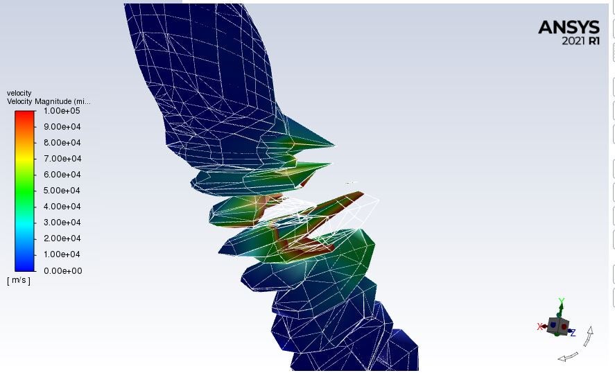

  Here's a zoomed in image of the interface mesh after the Courant number went over 250: Here's a zoomed in image of the interface mesh after the Courant number went over 250:
    Here's images of the interface when Courant#~1: Here's images of the interface when Courant#~1:
 I'm happy to post more pictures. Not sure what's helpful... thank you for the quick responses and aid in this issue.
 May 21, 2021 at 3:18 pmRob Forum ModeratorYes, that's the refinement+coarsening to many levels messing with the Poly mesh: it's because it's refined a lot then coarsened repeatedly so the mesh is no longer what you created. We've seen it before but that's about the worst I've seen, even in testing. Easiest fix is to use poly+hexcore or reduce the max refinement level: the former works as the hex mesh doesn't distort.

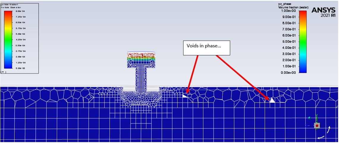

 May 21, 2021 at 6:43 pmsmarx2 SubscriberRob I attempted to use the Poly-Hexcore meshing method. I reduced my max cell size to 1.6mm so that I could use 6 levels of refinement. After everything was set up and initialized, my volume fraction plot appears to have gaps in a couple cells (below). When I tried to run calculations, I received a floating point exception (which I assume is due to the missing cells). Do I need to try to re-mesh the domain? Also, please feel free to let me know if I misunderstood any of your recommendations.

 May 24, 2021 at 7:23 amRob Forum ModeratorThe gaps are just a surface display glitch, the facet isn't in the surface so you see white "holes". The solution is fine, and it's been an occasional issue since iso surfaces and tet mesh first came out.
