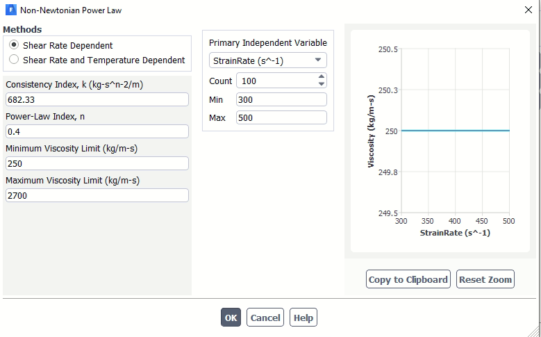

      I am modelling the melt flow behaviour of a metal powder filled composite FDM 3D printer filament in a 3D printer nozzle. I model it as a laminar flow with 2 phases. The primary phase is the polymer and the secondary phase is the metal powder. I use non-Newtonian-power-law for the viscosity of the polymer. For the boundary conditions, I use velocity-inlet, pressure-outlet and no-slip condition at wall. The initial temperature of the polymer and metal powder is 333K and the wall temperature is 543K. For the solution methods, I use Phase Coupled SIMPLE for pressure-velocity coupling scheme ad second order implicit transient formulation, least square cell based for spatial discretization of gradient, second order for pressure, second order upwind for momentum, and QUICK for volume fraction and energy. From the literature, the viscosity should be increasing with increase in powder volume fraction.nThanks.n

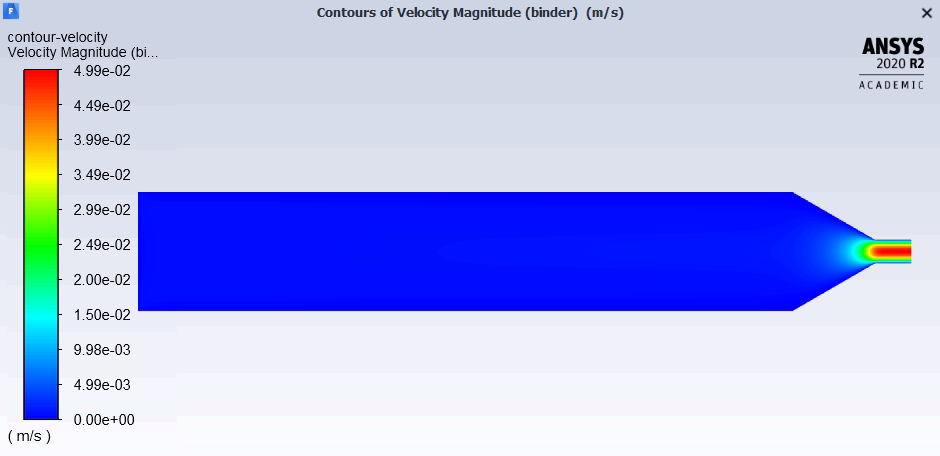

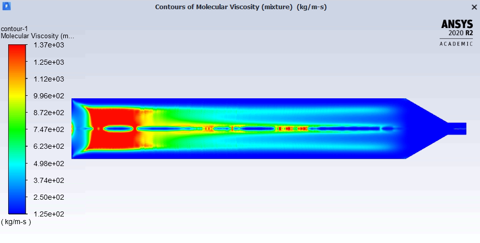

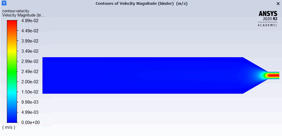

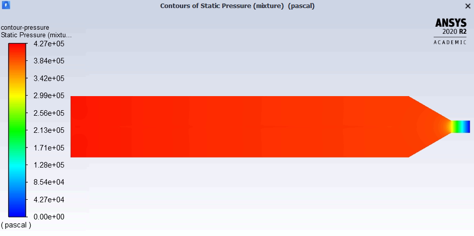

    • H_E

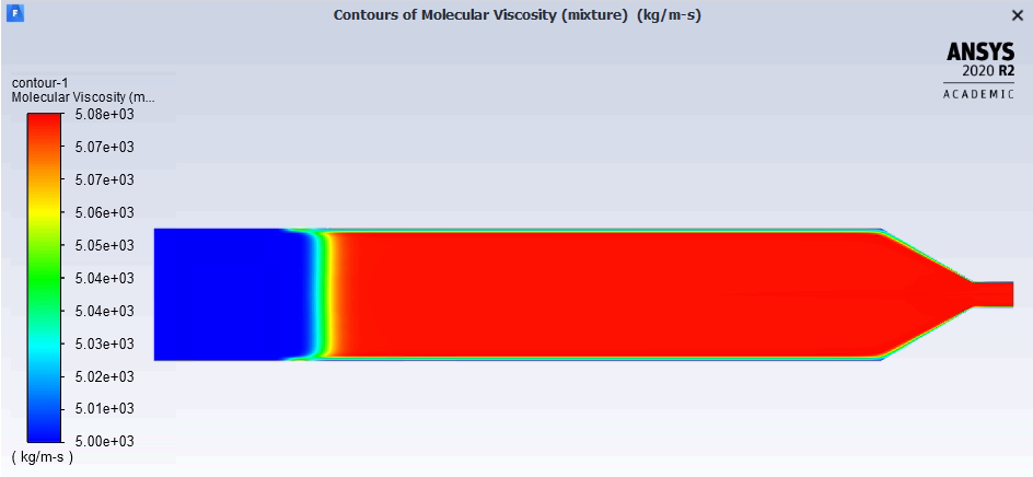

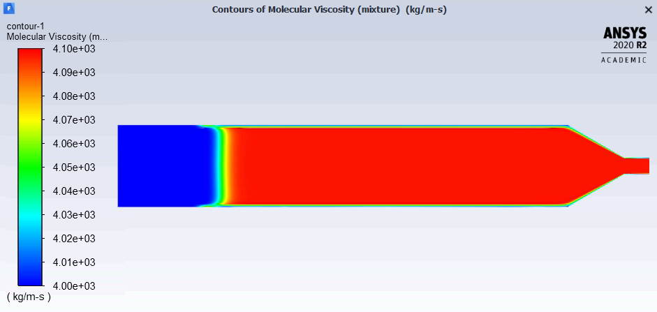

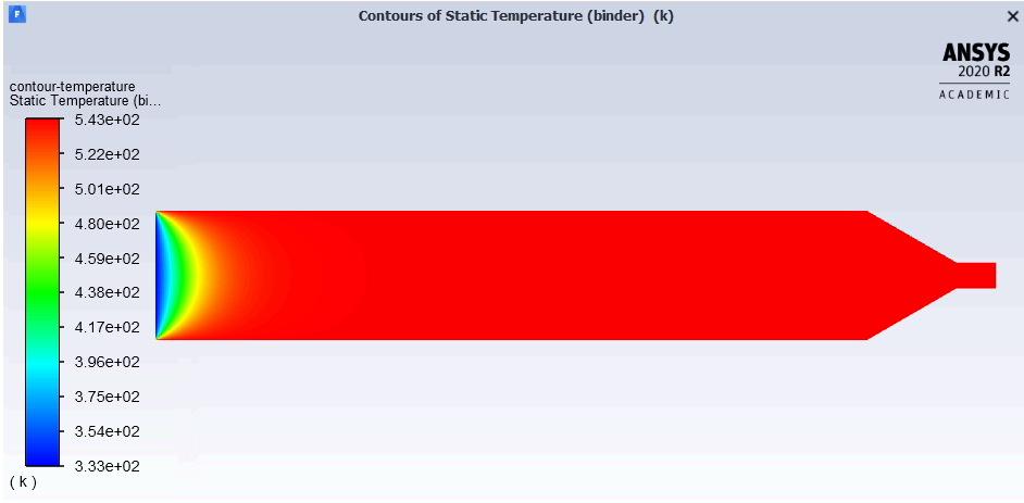

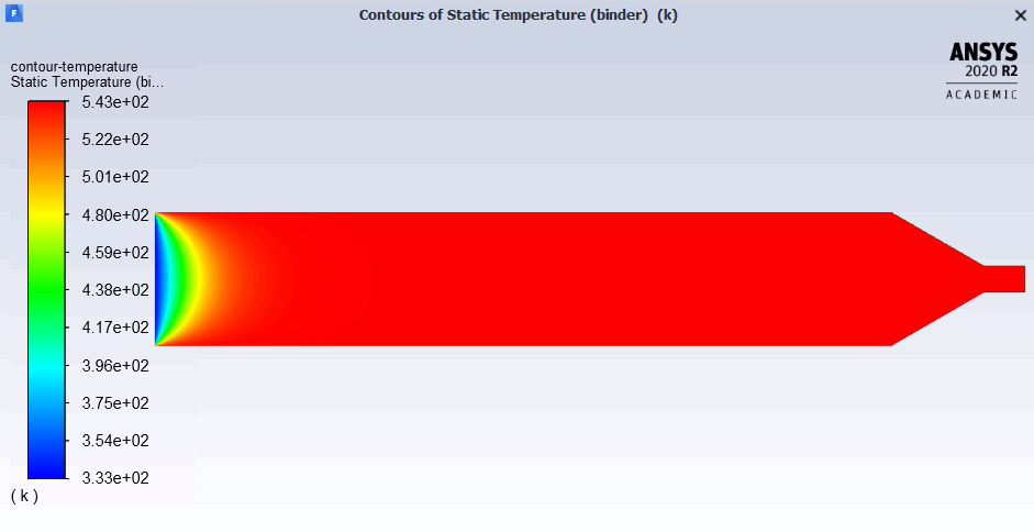

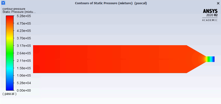

      Hello Aitor,nBelow are the contour results I obtained with powder volume fraction of 0.6.nBelow are the contour results I obtained with powder volume fraction of 0.5.nThanks.n

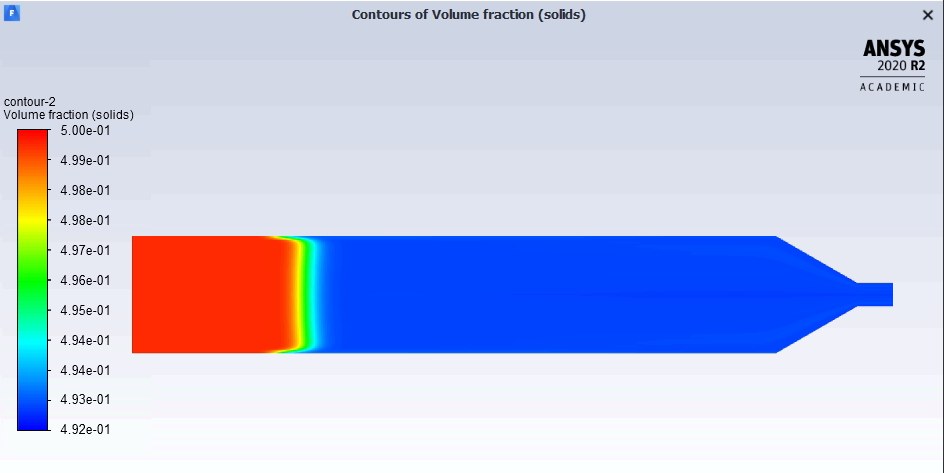

    • Aitor
      Hello H_E,nI do not understand how do you fix the volume fraction. Do you mean powder volume fraction at the inlet? Could you show the contours of powder volume fraction?n

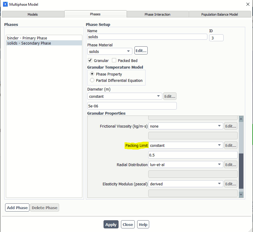

    • H_E
      Hello Aitor,nI fixed it in packing limit in the granular phase setup in multiphase model and at the inlet boundary condition.nn
    • Aitor
      Hello H_E,nI have not used the Eulerian Granular Multiphase Model, but I understand that the packing limit is a limitation of the volume fraction of the granular phase based on the validity of the model.nI imagine that the contour of volume fraction in the case of 0.6 (inlet) will be similar than the one of 0.5 (inlet). If this is the case, I do not understand the contour of molecular viscosity. Assuming constant powder viscosity, which is the expression for the viscosity of the polymer? Have you checked if it is correct?n
    • H_E
      Hello Aitor,nYes, the contour of volume fraction in the case of 0.6 is similar to that of 0.5.nI'm using non-newtonian power law for the polymer viscosity.nn
    • Aitor
      Hello H_E,nI have no experience with the modeling of viscosity for non-newtonian fluids, so I cannot help you with that. However, it may be interesting to start with a constant polymer viscosity, to then switch to advanced models. n
    • H_E
      Hello Aitor,nI changed the viscosity to be constant (10000 kg/ms) but the viscosity of the melt with higher powder volume fraction (0.6) still lower than that of 0.5.nFor powder volume fraction of 0.5,nFor powder volume fraction of 0.6,nn

    • H_E
      Hello Aitor,nThese are what I setup for the 'solids' in multiphase model window.nWhile for the viscosity of 'solids' under material properties, it is not used for the solutions as written in Ansys User Guide. I had tried to modify it and it really shows no difference in the solutions.n
    • Aitor
      I see that powder viscosity is not constant. I would recommend you to start with simple cases as constant viscosities, so that the results can be intuitively understood. This would allow you to detect possible errors in the setup.n
