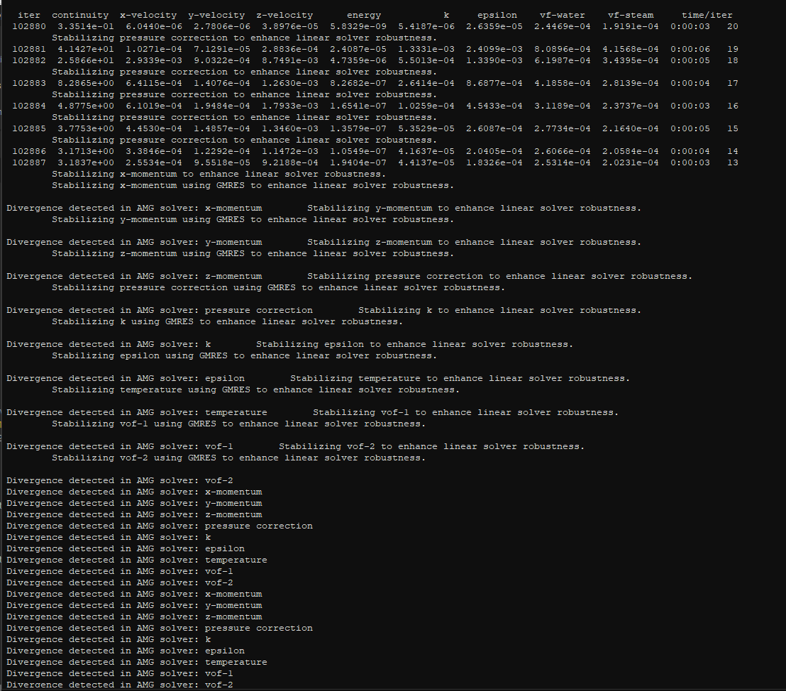

SubscriberHi everyone, I'm currently running a multiphase VOF problem with three phases, implicit formulation for volume fraction parameter, implicit body force activated, a polynomial function for the surface tension coefficient for each of the phase pairs with surface tension modeling turned on. For the flow a k-epsilon viscous model is used with enhanced wall treatment, thermal effects and curvature correction activated. For one of the fluids I have a polynomial function with temperature as the variable. I've been running into an issue where I'm receiving a floating point exception around when the fluid gets converted into the other fluid T=
This is the console message I received before the floating point exception. Any assistance would be very helpful

Ansys EmployeeOkay: first start simple and use a plain SST turbulence model (without any additional sub-models). Use a constant surface tension and try again. You need to find out the reason for this behavior: it actually starts diverging at the beginning of the time step.Â
Can you describe bit more the problem you are trying to model?

SubscriberHi, soo after further troubleshooting it seens ti be a problem with Enhanced Wall Treatment in the K-Epsilon model. Would you have any insight as to why that is?

SubscriberHi, Thanks for the reply. Soo I've attempted to run the simulation with a constant surface tension previously and received the same error. I recently just attempted the k-epsilon model without any additional options (no enhanced wall treamtmant and thermal effect) and a constance surface tension now the issue seems to have gone away, but I'm not getting the results I needed. I'm currently testing if the material I'm using is causing the issue

SubscriberI got the same problem "floating point" and it was due to inflation.
When I removed inflation, no floating point appeared.

SubscriberAlso, if I used inflation I reduced the time step and now is working
