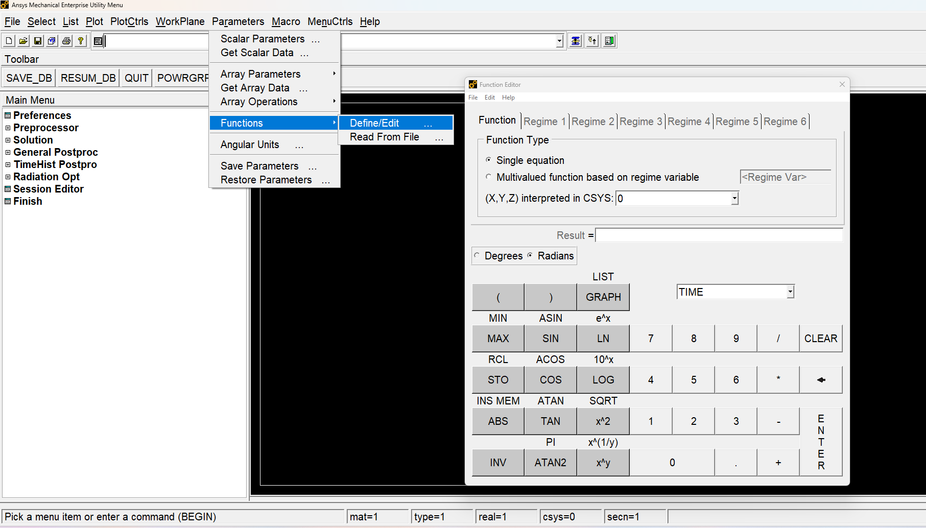

    • Chandra Sekaran
      This function was built in MAPDL function builder GUI and then these commands were taken out of the log file in MAPDL. The function builder in MAPDL support multi-regime functions. For example you could have different equations for different Z value ranges. Perhaps that is what you need. Or if your equation can be modified to add in a Z parameter that can also be done.
      Here are steps involved.
      1.            Go to function editor in MAPDL and create the equation. For example “0.01*X*TIME^2” . Save the function to a file.
      2.            In MAPDL import the saved function as a table parameter using GUI. It will ask for the name of the function. Let us say I call it “PRES”
      3.            Then you use %PRES%  like you would with any other table array in SFE,SFA, BF etc commands.
      For use in Mechanical,  do all the way to step 2 above in MAPDL. Then look at the log file and copy the function definition (shown below in yellow highlight). Manually add the SF command to apply the load.

    • Sara.Ranjbareslamloo
      I already did the procedure you mentioned to get the command, but it's just for one laser track and I am not able to extend it in vertical and horizental direction. my final goal is simulate like this toturial Additive Manufacturing AM, Laser Metal Deposition LMD horizontal advanced model 2D Gauss heat source - YouTube.
