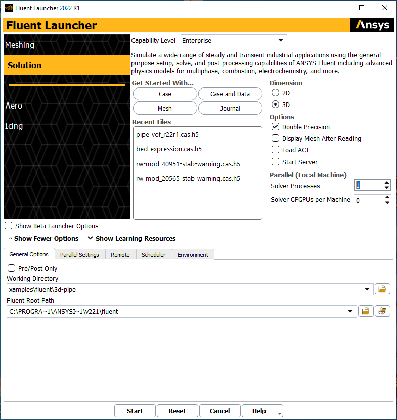

SubscriberWhat is this new Multi-GPU Fluent Solver in 2022R1 update. How to actually use this feature?
April 11, 2022 at 1:43 pmApril 11, 2022 at 4:14 pmshashidhar0605
SubscriberIs there any link to the documentation on Multi-GPU Fluent Solver in 2022R1.
Do we need to select Solver GPGPUs per Machine also?
Should I select GPU(Beta) for using the Multi-GPU Fluent Solver?
April 11, 2022 at 6:48 pmAmine Ben Hadj Ali
Ansys EmployeeCheck Beta Features Manual.
April 12, 2022 at 4:54 amshashidhar0605
SubscriberI have selected Capability Level Enterprise and show beta launcher options are on. I am getting the following message
"Enabling this option makes beta workspaces and Fluent Launcher beta options visible, but it does not enable beta features in the resulting Fluent session.
Do you want to proceed?"
Where can I find the Beta Features Manual? Any link?
What to do? I want to test the new multi GPU capability

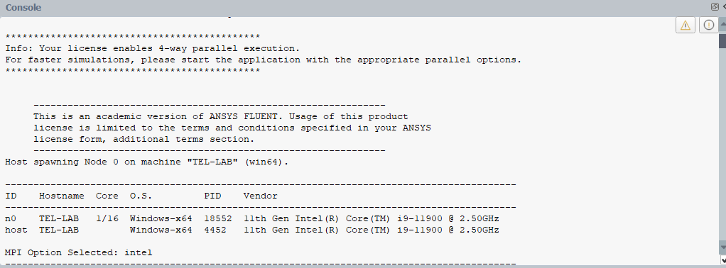

I opened the fluent from the command prompt as mentioned in the Beta Features Document
I got this message on the console
Info: Your license enables 4-way parallel execution.
For faster simulations, please start the application with the appropriate parallel options.
It says my simulation can be made much faster. How to set the appropriate parallel options to enable 4 way parallel execution?

Forum ModeratorAn Academic licence isn't Enterprise. Turn off the gpu stuff and launch Fluent normally. Set solver processes as 4, that's as many as you have without buying HPC packs. If you have Student you have a maximum of 4 cores and 512k cells. Research level licences remove this limitation, but your University will be providing them on the campus system.
