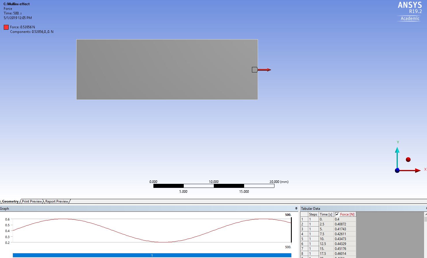

I am trying to evaluate the mullins damage variable over time in a soft tissue. I have created a new material using Mooney-Rivlin parameters and have introduced stress-softening using Mullins effect. My geometry is a simple rectangular shaped plate. One end of which is fixed and the other end is subjected to a time varying cyclic force. I have specified this force as a function of time in the loading conditions.
When I run the simulation, I get an unconverged solution and couple of warnings. I also ran the simulation with just a constant ramped force of 1N and it worked fine.

This is the first time I am using a non-linear material and I am not very sure how troubleshoot this problem. Any help would be great! thanks!
