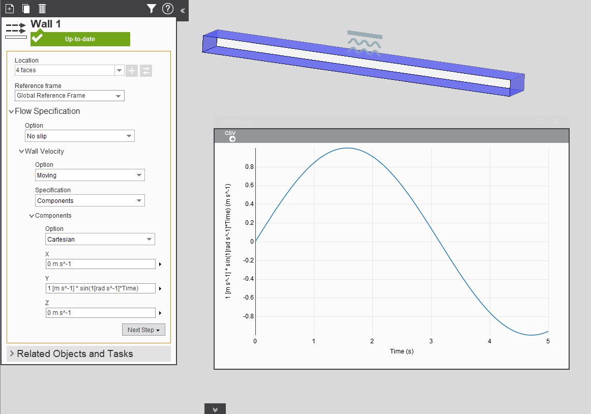

      I am trying to evaluate the 'flutter derivatives' of a very simple 'bridge-like' section geometry, based on the works of ScanlaN & Tomko (1971).
      For that purpose, I need to move the wall of the immersed body with periodic (either translational or rotating) motion and check the forces on the body at specific time instants. It is a Time-dependent simulation obviously.
      I set up a simple case in AIM where I try to model the periodic vertical body motion, but it seems nothing happens, i.e the body doesn't seem to move. Please check the attached screens and animations, also the link for the archive.
      Please help me to understand the possibilities and limitations of the moving wall function, especially in the sense of 'Time-dependent' Fluid simulation.

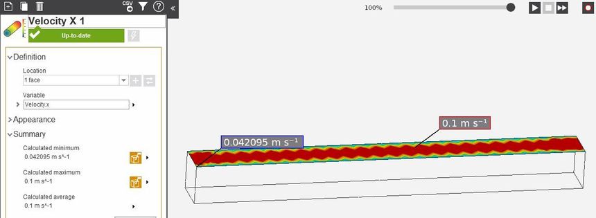

      For a stationary wall with no slip condition, the fluid particles adjacent to the wall have zero velocity. But if the wall is non stationary in practical application, it would impart some velocity to the neighboring particles. Moving wall function is to capture such scenarios.
      Please note, the use of this feature doesnt' end up in a visibly moving wall, but if we zoom in on the faces where wall is defined,  we must see the particles to be moving with the specified velocity at any time point. This is the velocity that the wall imparted on these particles due to no slip condition.

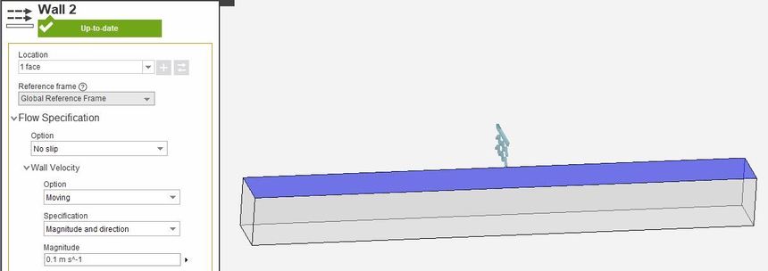

        steelxpert I performed a dummy test and applied a velocity of 0.1 m/s on wall. After solution , I checked velocity contour on same wall surface and it was in agreement with provided inputs.   You can perform something similar to identify the velocity of fluid particles at the wall surface. A time dependent or steady solution depends on what is your application. For a continuously rotating wall surface, you might be interested in steady state but if the wall velocity changes in the duration, you may need to go for time dependent solution. With this explanation, i think there is no further value addition in transferring the model. Thanks & Regards, Gaurav
