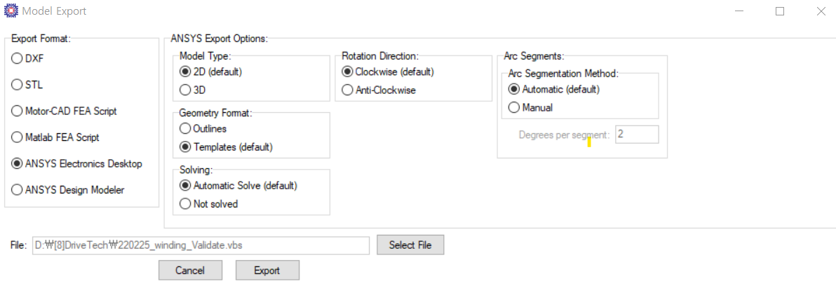

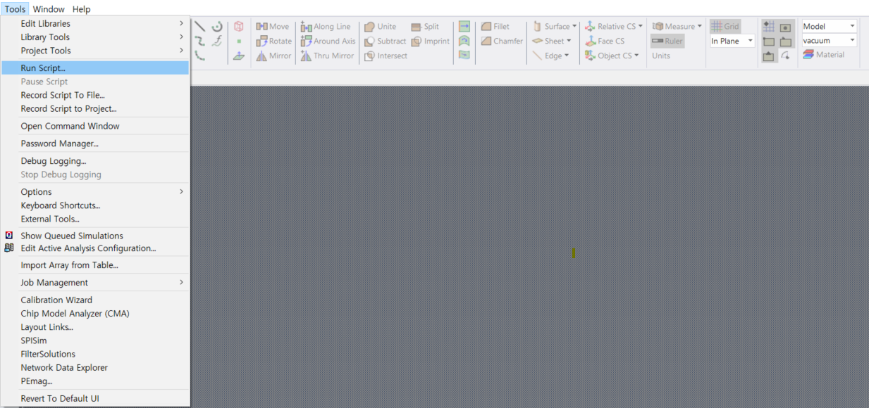

SubscriberTo import the geometry Motor cad to Maxwell, you need .vbs file.
(In Motor CAD) File > Geometry Export > Ansys Electronics Desktop ( The exported File name will be xxx.vbs )
And then, you have to open the AEDT (Ansys Maxwell) and (In Maxwell) click, Tools > Run Script > Open the vbs File.
It will run the script to create Motor CAD Geometry in Maxwell.
