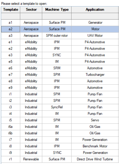

Only the listed configurations in motorcad Help can be analyzed. you can see the list when you go to File>open template
