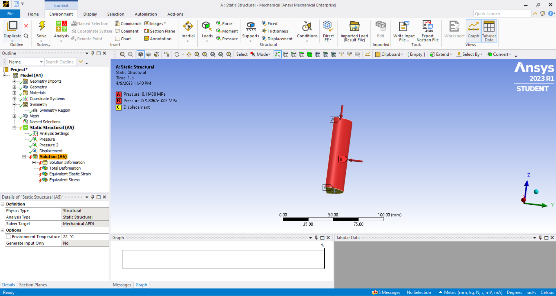

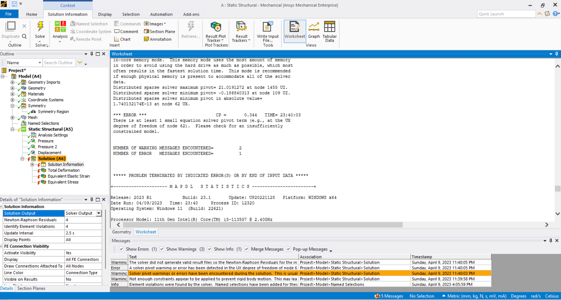

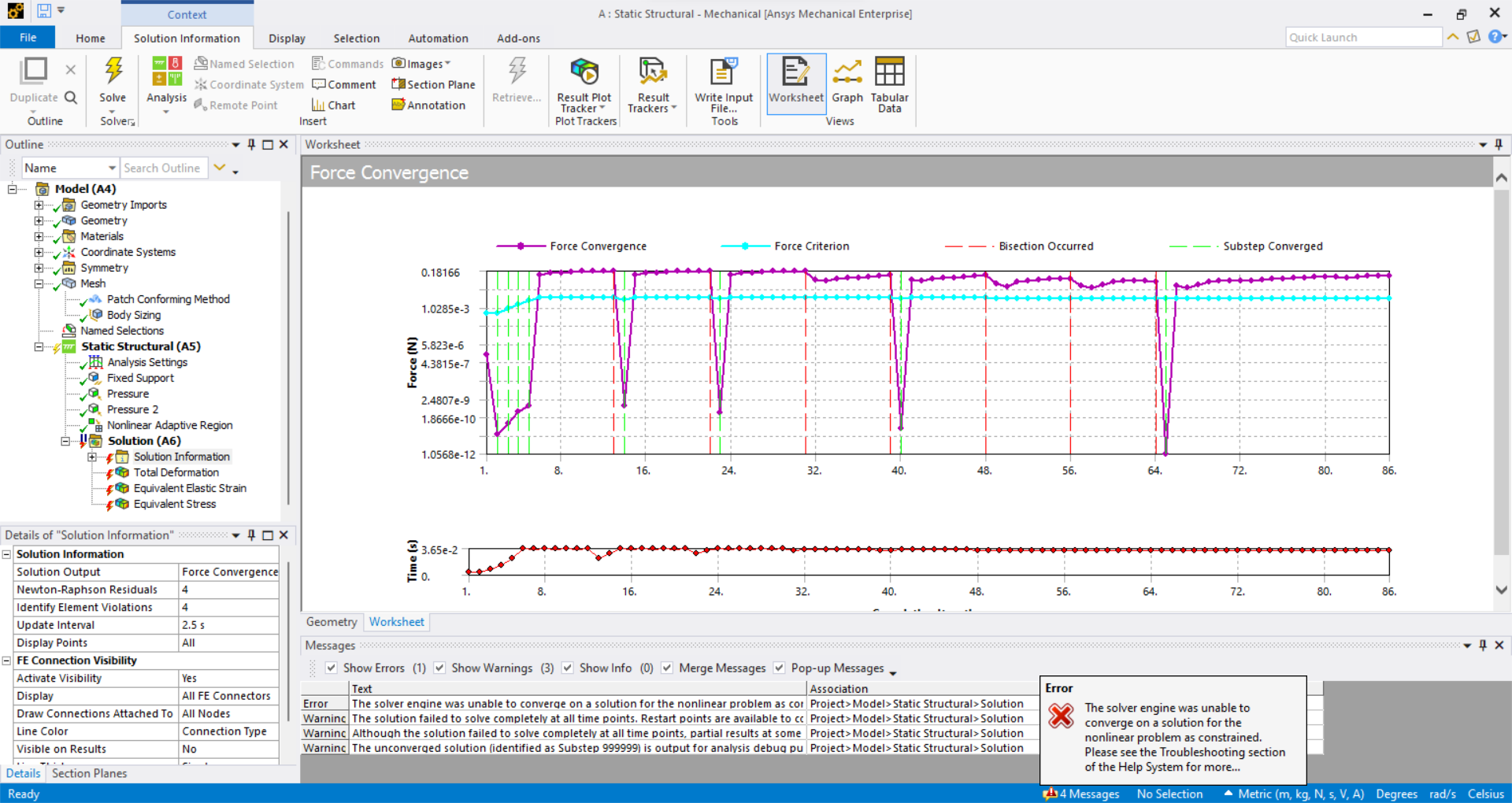

I am trying to simulate an unconsolidated undrained triaxial compression test through static structural analysis, however, the software keeps on telling me that it doesn’t converge to a solution. My goal is to create a similar stress-strain curve in the software with the experimental results that I have. What I did is that I created a Soft Clay material with a Mohr-Coulomb model and after that, I created the cylinder model under triaxial compression but I am not sure if I used enough boundary conditions. I would also like to add that this is nonlinear.Â
The following screenshot is what happens and I can't seem to move forward from this.
I am not sure what data I should show but if anyone can help I am willing to give what is needed for your understanding.Â

Fixed Support may be hurting the convergence. I assume that is at the bottom of your model. If you have two vertical planes of symmetry and two faces with applied pressure that push the model onto those two symmetry planes, the bottom only needs a simple Displacement boundary condition to set the vertical DOF to 0.0 and leave the lateral DOF free. Then you can delete the Fixed Support.
Peter-

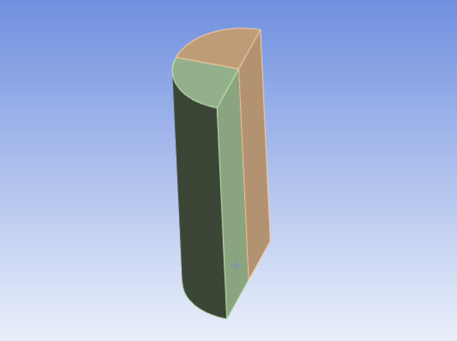

Since you have only one symmetry plane, there is no constraint to prevent motion along the X axis.
Split the body with a plane at 90 degrees to the first symmetry plane through the center of the circle. That symmetry boundary condition will prevent motion along the X axis.

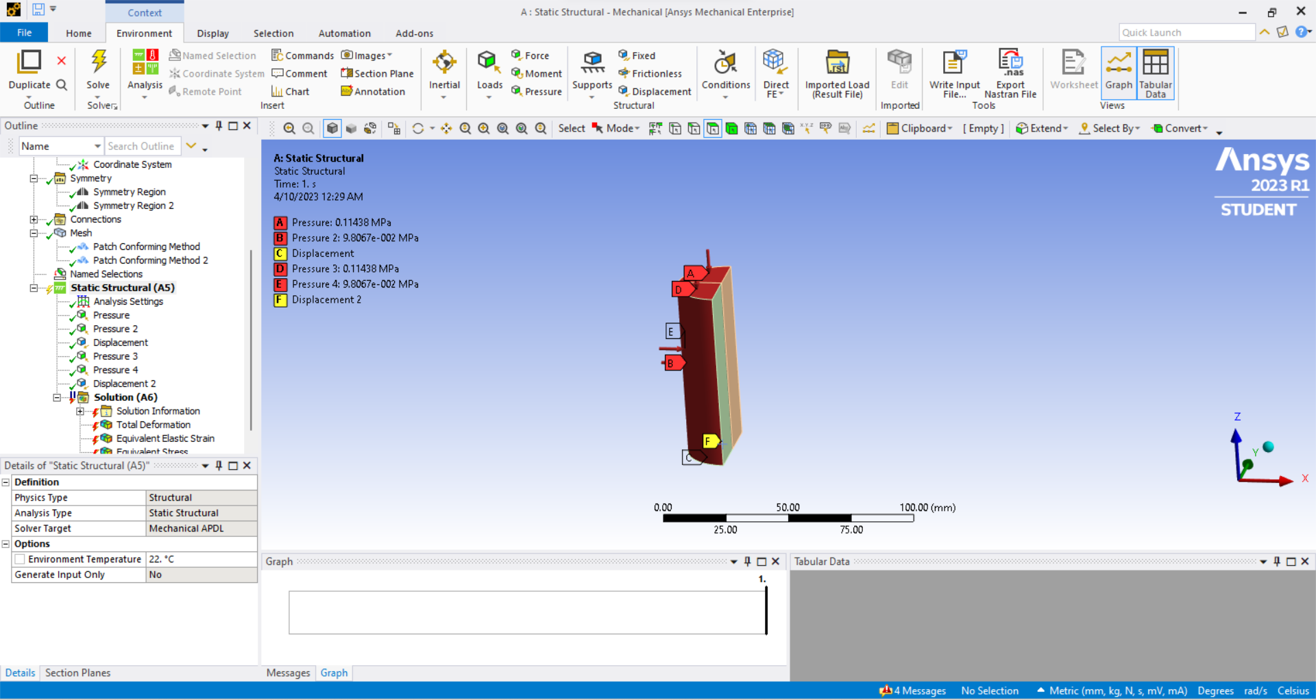

SubscriberHello Jo,
In Mechanical, suppress the brown body (or in SpaceClaim, suppress for Physics).
In the 1/4 circle that remains, the face that has a normal on the X axis has a Displacement of X = 0 and Y, Z are Free. The face that has a normal on the Y axis has a Displacement of Y = 0 and X and Z are Free. This is what the Symmetry regions do for you. You don't need both Displacement and Symmetry, but if you use Symmetry, you must have two separate ones and set the Normal axis correctly in each one. There are often three ways to do the same thing so Frictionless Support on any of those three flat faces is equivalent to the Displacement or Symmetry methods to support those faces.

SubscriberHello Peter,
I understand it clearly now. However, when I placed the pressure on the 2 faces, it still doesn't converge. What I did is I replaced the pressure with a displacement at the top face and indicated the expected displacement from the experimental results that I have. Fortunately, it gave me results but I am not sure if it is reliable. I would like to ask if what I have done is okay or should I stick with applying the pressure.Â

peteroznewman
SubscriberDisplacement is a good substitution and you can calculate the pressure from the reaction force and the area.
