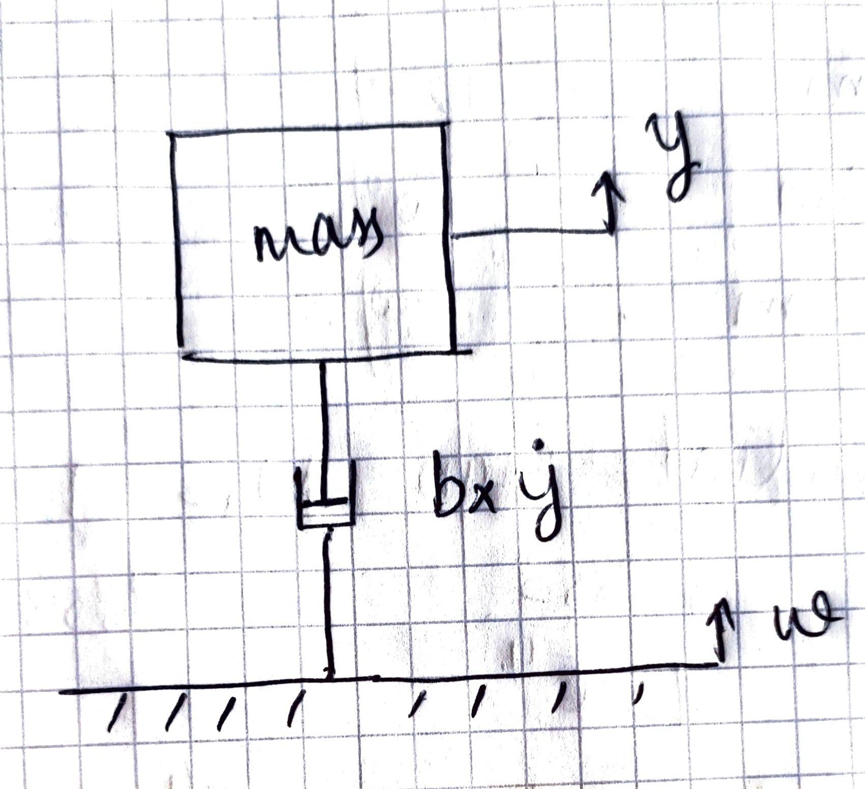

      I need to model a damper producing a damping force proportional to the absolute velocity of the mass(y°) , attached to a frame which is also moving (w°). I suppose spring elements can be used as dampers, but as I understand they use the relative velocity, which is not what I require. Kindly help, if there is any way to do that in workbench.
      Put the spring element between the mass and Ground. That will apply a damping force proportional to the absolute velocity of the mass. If the mass is moving in only one direction, you need only one spring aligned to that direction.  If you have a mass moving in other directions, you need more spring elements to provide damping in those other directions.
      • murali
        My doubt is, since both frame and mass are having realtive motion, won't the spring be considering the relative velocity (b x (y°-w°)) to calculate the damping force, rather than the absolute velocity of the mass alone?
          A spring/damper between the mass and ground measures the relative velocity between the mass and ground. Since the ground is stationary, that relative velocity is exactly equal to the absolute velocity of the mass.
          Another spring/damper between the mass and the frame measures the relative velocity between the mass and the frame as you have shown in your sketch. It is up to you if you want to have that spring/damper in your model or not. If not, then the motion of the mass is unaffected by the motion of the frame.

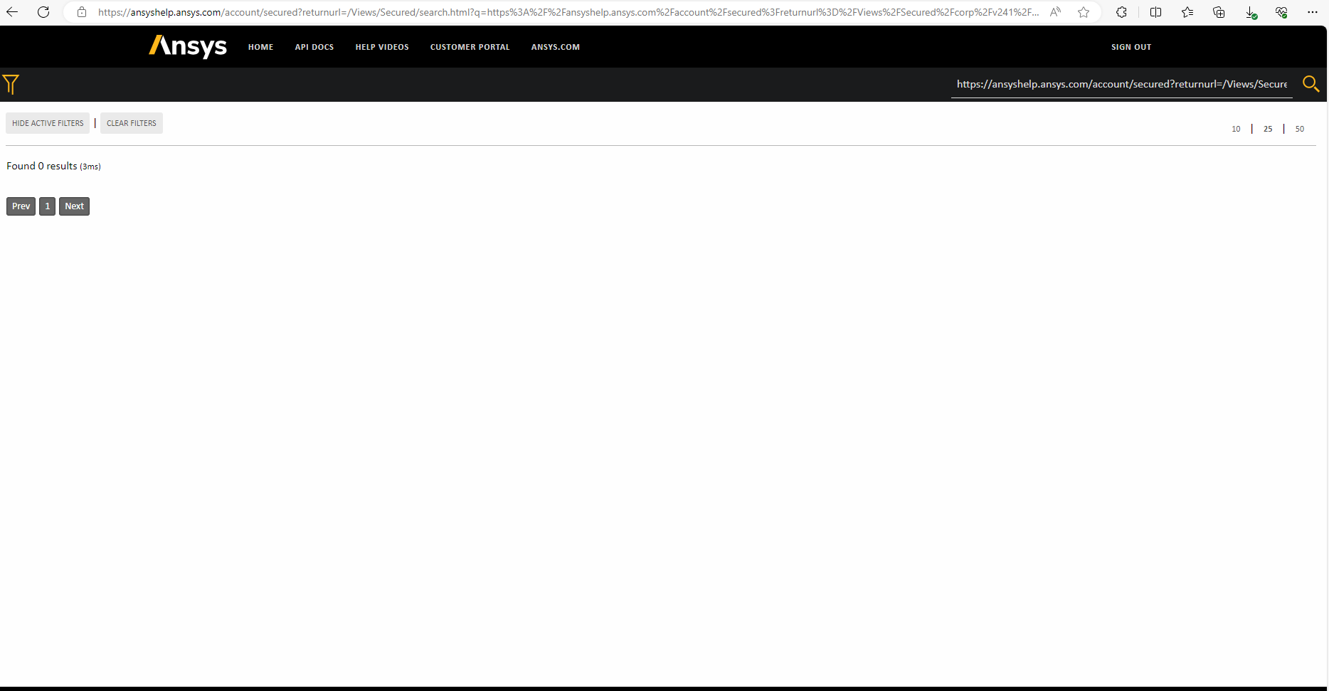

      • murali
        Unfortunately, the link pasted in ansys help tab shows no results. Same is the case with cople of other links from other discussions.

      Do not paste the URL provided into the Search field of Ansys Help, paste it into the Address field of the browser at the top of the window.
    • Erik Kostson
      Hi
      See here how to access the help links we provide (as in the above post):
      /forum/forums/topic/how-to-access-the-ansys-online-help/#:~:text=Here's%20how%20you%20can%20access,on%20the%20Ansys%20Learning%20Forum.
      All the best
      Erik

        Thanks for the details. My question was as to how to apply this to a spring element. Although workbench permits to give alpha and beta damping in material level and global level, how can we practically model a spring element as a damper so that it does not take the relative velocity but takes the the absolute velocity of one of the bodies it is attached to?
        As Peter mentioned, attaching it to the ground is sensible. But when the connection is between two bodies, how to achieve it?
