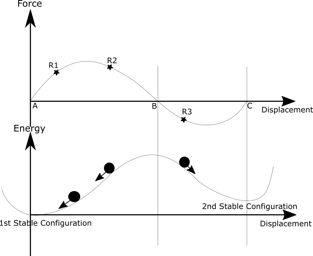

I have a problem modeling snap-through behavior in the static structural. I have a bi-stable structural. When I compress the structure the load increases until it reaches a maximum, then it decreases and becomes negative as shown in the below graph.
As indicated in the energy graph, I expect that if I remove the external force or the applied displacement in point R1 and R2 the structure return to its initial configuration (A). While if we remove the force in the R3 point it will settle at the second stable configuration (C). Now, in my model, if I remove the force at point R1 it return to A configuration (as expected) but if I remove the force at point R2 the structure will continue deformation and will eventually rest at C configuration.
I have tried different stabilization method; Constant, Reduced, Line search and Arc Length and the same behavior happens with all the method while if I do the same simulation in the Explicit Dynamics the response is as expected. I wonder if there is any way to correct this problem in Static Structural.

SubscriberHello ,nHere is the structure at the end of step 1, a 5 mm downward displacement of the center post, then you deactivate that constraint in step 2.nHere is the structure nearly at the end of step 2. The arms on the left have passed through each other. You need to add Frictional Contact to prevent this. In Explicit Dynamics, self contact is automatically used in the simulation.n

SubscriberTake a look at the attached 2D Plane Strain version of your model.nI replaced the Displacement with a Remote Displacement. This lets me plot both the reaction force and the reaction moment. Maybe the problem with your 3D model is the reaction moment may have changed sign at point R2 on the force reaction plot, and it was the moment that made the part continue down.nSeptember 29, 2020 at 10:45 pmhamednik

SubscriberHello Array ,It makes perfect sense to me that the center keeps going down in step 2 after reaching point R2 in step1. The reason is that the peak reaction force has been passed. At the start of step 2, when you deactivate the displacement constraint, the solver replaces the displacement constraint with the reaction forces, and then ramps those forces down to zero. Continuing to move down is the only direction that allows the force to be reduced to zero. An increase in force is required for the center to move up from the -15 mm point. That is not permitted in the deactivation of the constraint.nJust because there is a lower energy state on the other side of that peak doesn't mean you can get there from here. Continuing downward after deactivating the displacement at R2 is the correct behavior of the system.nIf you were in a Transient Dynamics analysis, and pushing with a force instead of a displacement, the system would snap through to the low state as soon as the peak force was passed.nSeptember 30, 2020 at 3:25 amhamednik

SubscribernAs I explained earlier, your original post contains an error for the stable states of the structure and how the force relates to those states. I have a revised graph that I believe is more representative. The peak force corresponds to a peak energy. A zero force crossing corresponds to a zero tangent on the energy. So from R1 the system would return to the 1st stable config, but from both R2 and R3, the system would move to the 2nd stable config.nOctober 7, 2020 at 3:23 amhamednik
SubscriberThanks again for your time and response . I am not sure how you got this energy graph but I don't think it is correct actually. Two main reasons: nFirst, in the force-displacement curves (obtained from both static and transient analysis) we have three points with zero force reaction. These points indicate zero tangents (both local minima and maxima) in the energy curve so we must have not more than three zero tangent in the energy curve. But in your case we have five points.nSecond, I have fabricated this sample and experiments confirm only two stable configurations.nFor this analysis, I believe the problem with Static Analysis (as you mentioned) is that it ramps down the force when I remove the applied displacement. But I don't understand what is the problem with the Transient Analysis. It predicts more accurate results if we relieve the displacement at R2 however for R3 it doesn't work out. (you may check the files that I attached for the transient in the previous post).nI think, the problem might be the kinetic energy in the system which is not damped or stabilized. But if I change the value of structural damping to anything but zero, the solution won't converge.nOctober 7, 2020 at 11:22 ampeteroznewman
SubscriberI was just freehand sketching the energy graph and I agree it is wrong. Better to plot data!nIt's not a problem with Static analysis that it ramps down the force when you remove the applied displacement, that is exactly how it is supposed to work.nAs I explained above, in a Transient analysis, where you push down with a Force, as soon as the force passes the peak value, it will snap forward. The problem is that you are using a Displacement in a Transient analysis, then suppressing the constraint. Stop doing that. If you don't want to apply a force, you could introduce another body on a translational joint, and have that body use frictional contact to push on the center post.nYou were moving the displacement so slowly so I don't think there is any significant kinetic energy in the system. Did you perform a Modal analysis to learn the natural frequencies of the structure?nOctober 7, 2020 at 3:15 pmhamednik

SubscriberDear Peter nFollowing our discussion here. I could solve the problem thanks to your instruction and by chosing non-zero value for Damping vs Frequency. However, now I am trying on the problem from another aspect where I need to add another loadstep in which the Damping must be zero but as far as I can see, the value of damping cannot be changed in different load steps. I wonder, if there is any way to do this?The problem is simple, I need to change the value of Damping Controls at different steps but in workbench the value is the same for all load steps. I appreciate if you can help me with this.nnThanks;nHamednViewing 22 reply threads- The topic ‘Modeling Snap-through behavior in the Static Structural’ is closed to new replies.
