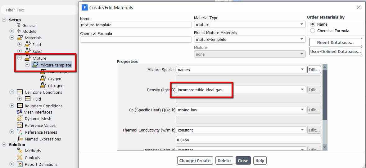

      Thanks for the quick response and your help. Where should I set the density as the incompressible ideal gas?
      I can set the density of air in "Fluid" as Incompressible-ideal gas. However, that option is not available for air in the mixture-template under "Mixture".  Any help?
    • Karthik Remella
      Administrator
      Are you able to see this?

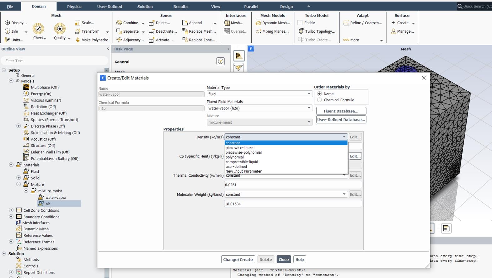

      (1) I don't have any option to choose density as incompressible. Please see the attached picture.
      (2) "make sure you use air & water vapour...." Do you mean air first and water vapour 2nd? I thought it was the other way around.
      (3) can I set my operating density as a constant value?
      Check the mixture density, and make sure it's set as volume mixed. The mixture setting can override the available species options
      Water-vapour first, air second: most common species is always last.
      Yes, it's in the operating conditions panel.
