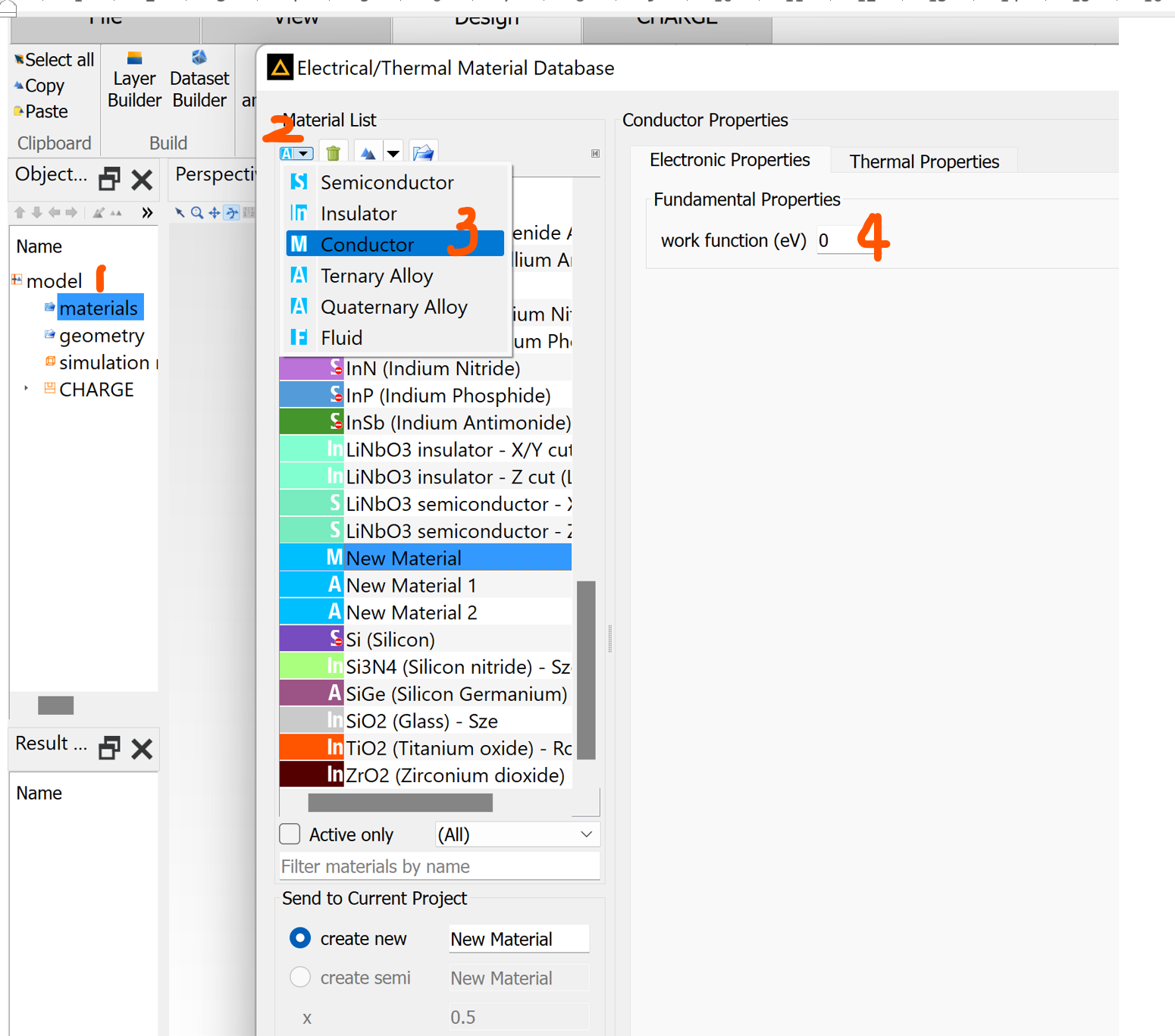

      For any materials that are not in the material database, you can add them to be semiconductor, metal or insulator.
      Please refer to
      Material Database in Finite Element IDE (CHARGE, HEAT, DGTD, FEEM, MQW)
      Creating and modifying electrical materials from a script
      addmodelmaterial - Script command
      addmaterialproperties
      Tips for creating a new alloy material
      Tips for creating a new semiconductor material
      Metals (conductors) are simple as they only need to know its work function.
      If you want to simulate it as semiconductor, you will need to have some semicondutor properties for it.
