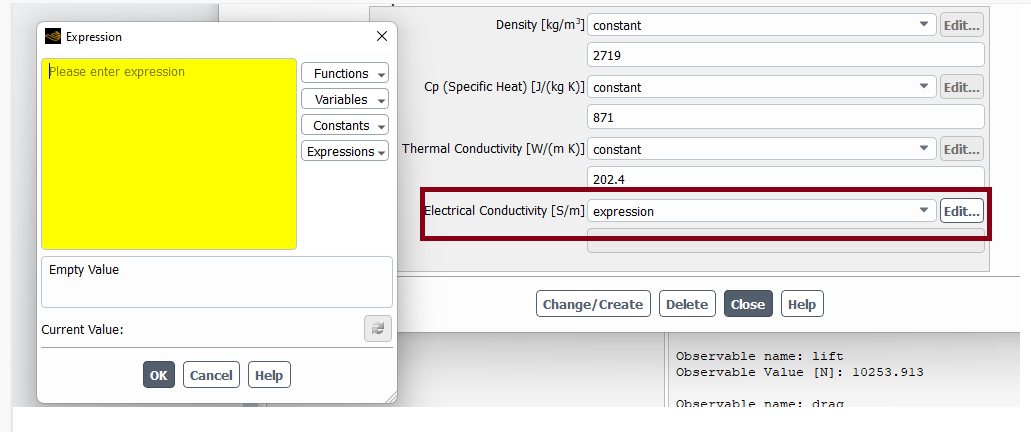

      how can I write an expression to incorporate this resistance into the conductivity for aluminum in fluent. thanks
    • Murari Iyengar
      Hi, Under Electrical Conductivity options, you can select Expression and then input the expression as required.
