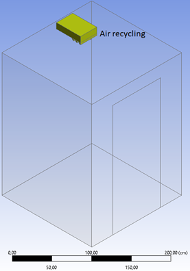

SubscriberI would like to ask a question about the modeling of my problem.
I want to simulate the dispersion of decomposing tracer gas in a cold storage chamber. I already have the boundary conditions for the mass flow rate of the tracer gas and the air circulation, as well as kinetic data for the gas. The problem arises in modeling this air recycle, which must have conservation of the tracer gas, not being able to set only the mass flow inlet condition in the diffusers and the pressure outlet condition in the fan. I would like to be able to simplify this region where the recycling occurs, between the fan and diffuser, but I do not know how to do this, is it possible through a UDF? Or do I have to model this recycle region, then I get into the problem of how to find the fan's characteristic curve since the only information I have about it is the air mass flow rate. Below are some figures to better visualize the problem. Any ideas or guidance are welcome.

April 18, 2022 at 1:56 pmIonatan
SubscriberThe recycle region is not of great interest, I just want to conserve the species, where all the gas that comes out of the fan goes back into the diffuser, how could I simplify this part to get this result?
