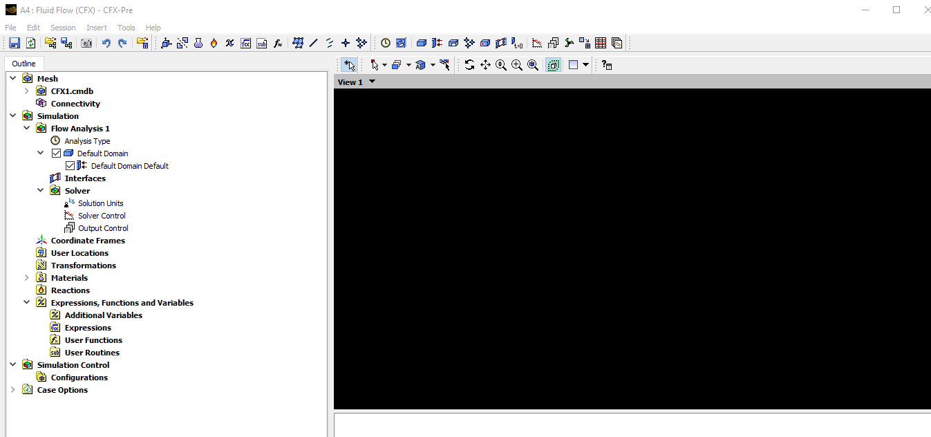

      Good morning! I have been trying to use cfx fluid flow and when I load the generated drawing to the CFX-Pre the screen turns black and the drawing does not appear. How can I solve this?
    • Nikhil N
      If you are running this case on a remote systen, try setting an environment variable.
      • Name: QT_OPENGL
      • Value: desktop
      You will find an ocean of resources on the internet on how to set an environment variable.
      Else, have a look at this forum discussion: Why my ANSYS-CFX 19.2-R2 student version shows me a black graphic window?
      Nikhil
    • Nikhil N
      To add, make sure you have latest graphics driver for your graphics card installed.
