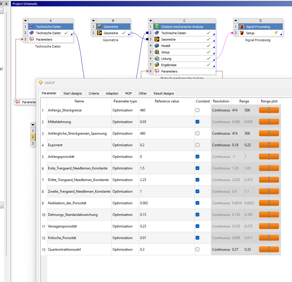

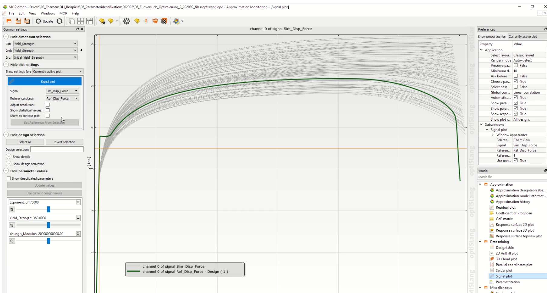

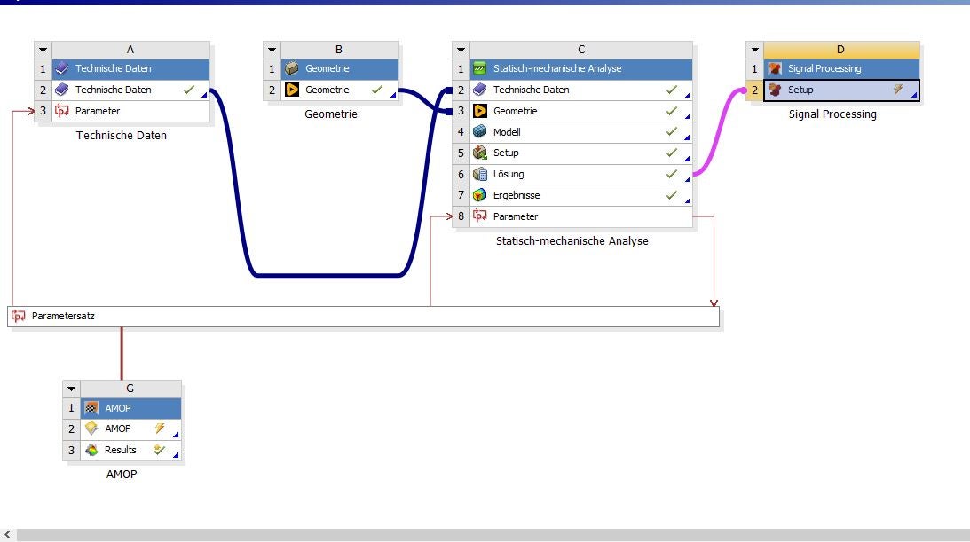

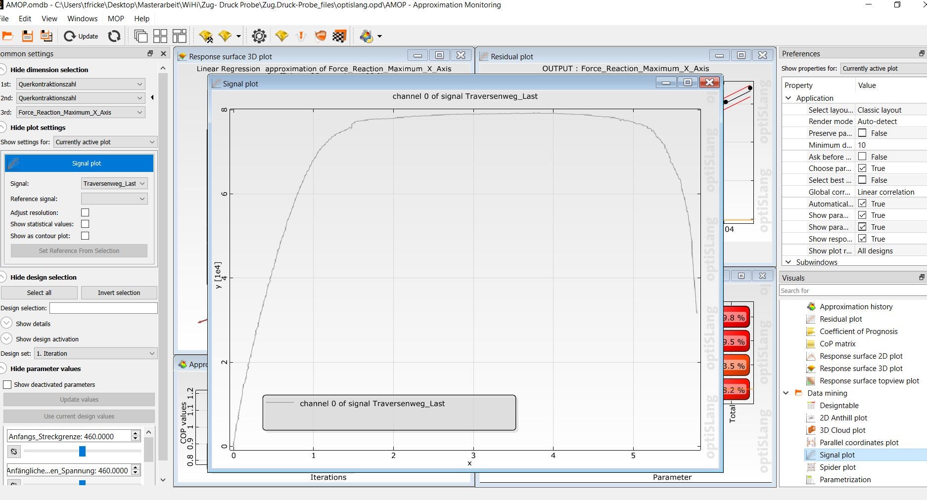

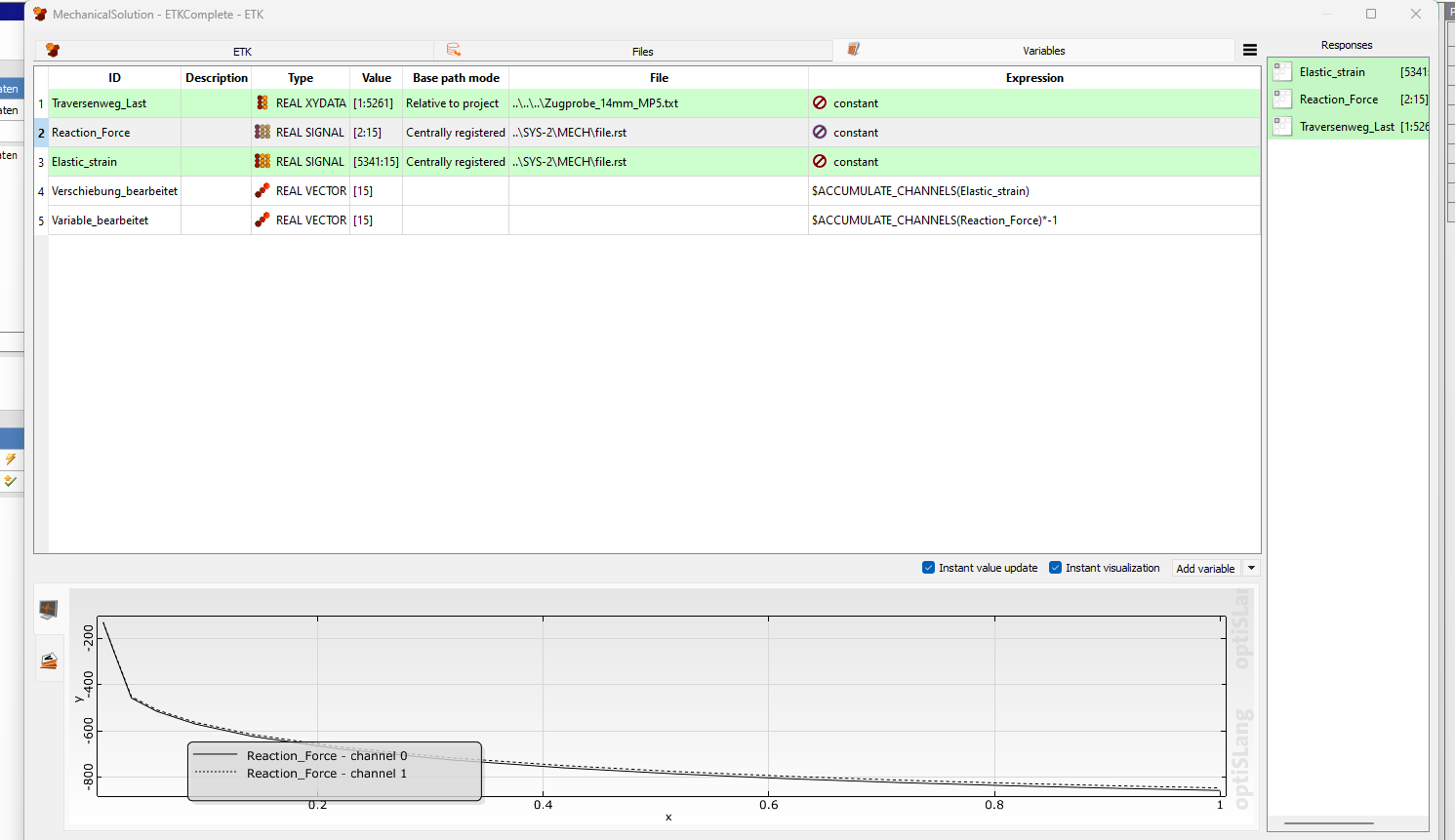

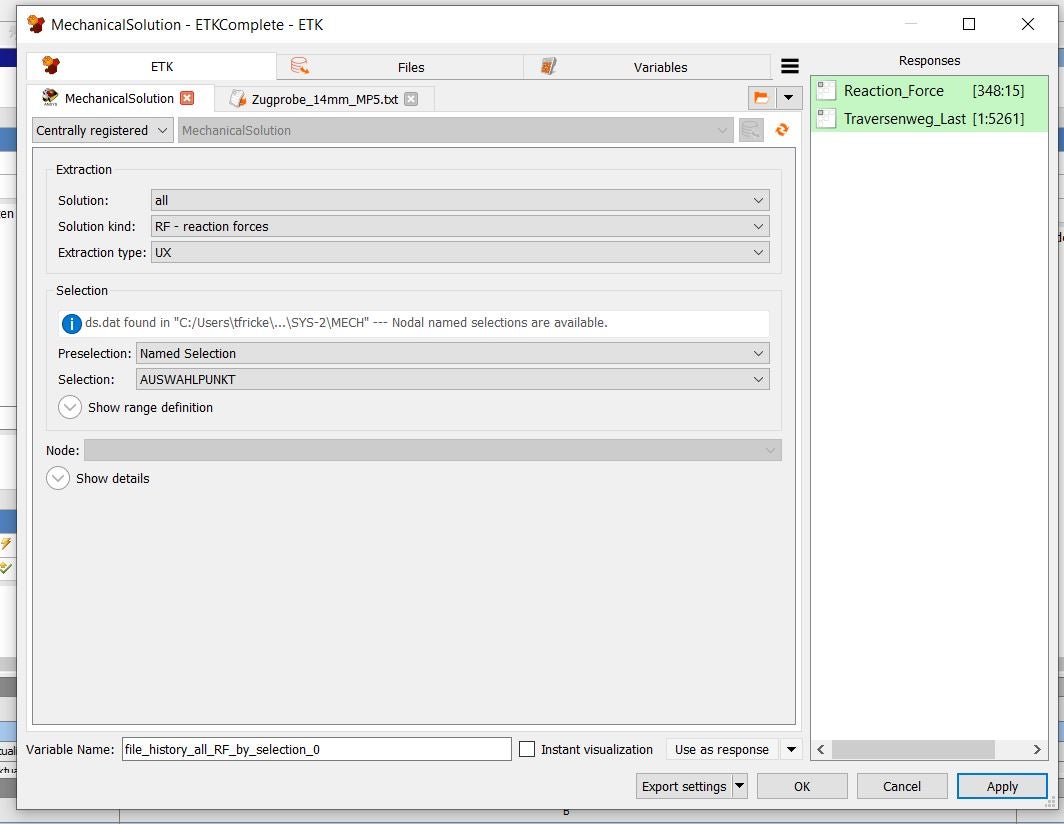

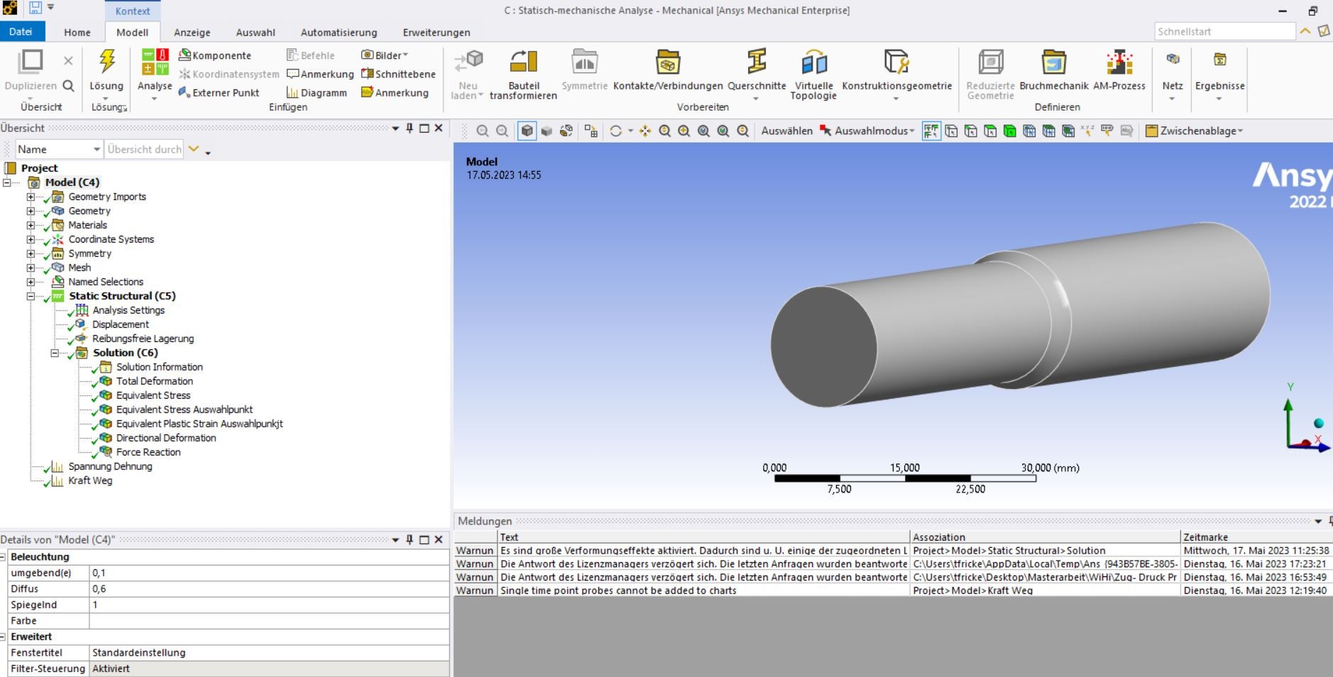

May 17, 2023 at 1:25 pmTim Fricke SubscriberHey guys, I've been sitting at the pc for 3 days trying to reproduce the material curve from the tensile test with a material I created myself in Ansys. Unfortunately, I can't get it to work and I'm slowly getting desperate :D The model in Ansys works. I was also able to load the curve from the experimental test into the signal processing (see picture).
 I would now like to display various force-displacement curves in Optislang with a parameter study. So I can slowly approach the experimental curve.Unfortunately, I can't get other curves to be displayed in the signal plot apart from the test curve. What am I doing wrong or where is my mistake? Best regards Tim

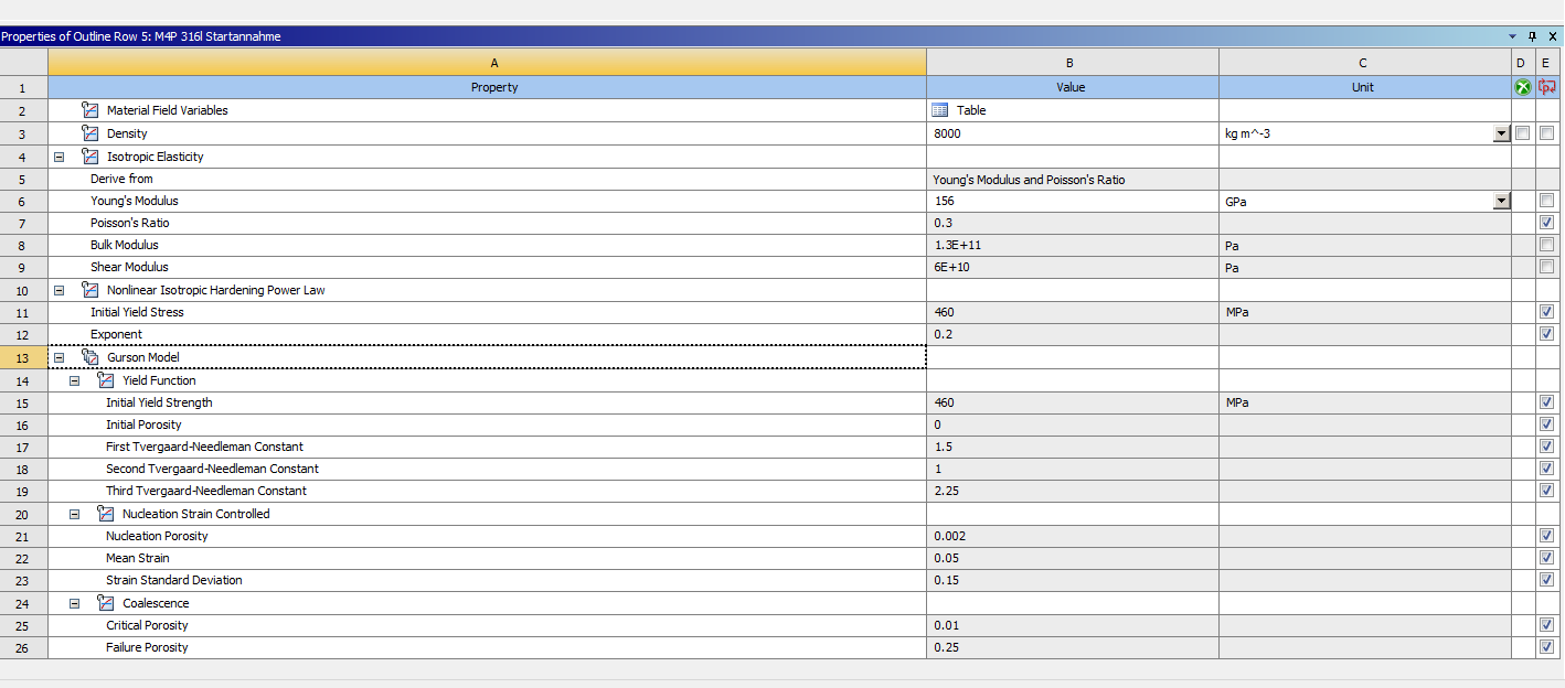

May 18, 2023 at 8:39 amAshish Khemka Forum ModeratorHi Tim, The stress-strain curve from analysis should be the same as the input material properties under engineering data. For a variation in load deflection curve are you modifying the material input as well? Regards, Ashish Khemka

June 30, 2023 at 2:31 pmMarkus Ansys EmployeeHi Tim,

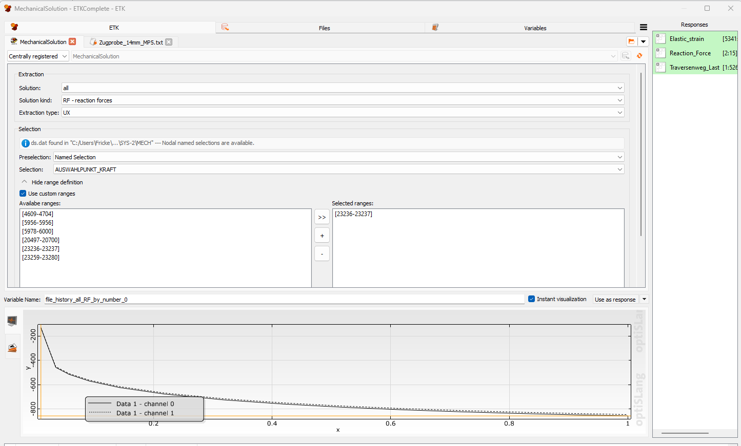

 I think the man reason for seeing only one curve is the "Base path mode" in the "Variables" tab in the Signal Processing.
 This is set to "Centrally registered". I would suggest the following:Â
 Can you 1) open the Signal Processing and 2) change that "Relative to project" by double clicking in the cell.Please run it again, check the signal plot again and see if it is working now. (By the way, you can use the calculator to extract values and derive new responses for the calibration,
 e.g. here the calculator is used in a tutorial: Calibration of a Damped Oscillator (ansys.com)
 I hope this helps,Markus
