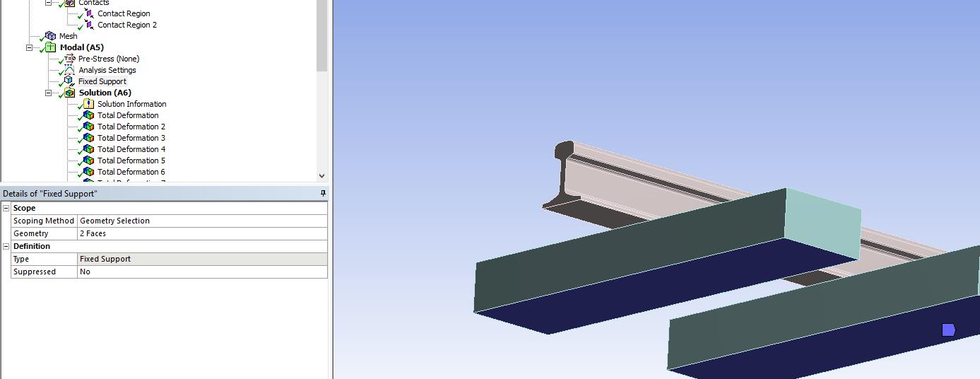

      Hi All,
      Hope you are well
      I am using Workbench to get the natural frequencies for the rail as is it shown in the below screenshot
      I have tested the rail in Free-Free boundary condition in the lab where it is supported by foam and modelled it in Ansys workbench in Free-Free condition (without any restrictions on the boundary condition) and I got similar result with error percentage (difference) from 1% to 4% for the first 5 modes . when I modelled the rail where it is placed on hard wood sleepers (where it is placed in the lab, second boundary condition) the model result are completely different from the experiment result.
      Can any one please help me wither is my boundary condition in Ansys is wrong or there is a problem in my contact (connection between the rail and the sleepers).
      current Boundary condition : Fixed support

      It would be easier to give an opinion if we can know the experiment settings. For example:
      • Is the rail fixed to the wood? or it is resting on the wood and there is no bonding in between?
      • Are you measuring the natural frequency of only the rail or the whole system (rail + wood)? In the current simulation you have, you will get the natural frequency of the whole system.

      * The Rail in the lab is just resting on the wood sleepers, and the sleepers is resting on the ground.
      * I am measuring the whole system natural frequencies
      I have already measured the rail in Free-Free boundary condition (without sleepers) + no restrictions on the boundary condition in ansys
      Best regards
    • Wenlong
      In this case, I would suggest frictionless or frictional contact instead of bonded contact. And you probably need to change the fixed boundary condition as well.

    • AbdulahALMUTAIRI
      Thank you
      But what should I put the boundary condition ? Other than fixed from bottom of the sleepers?
      Regards

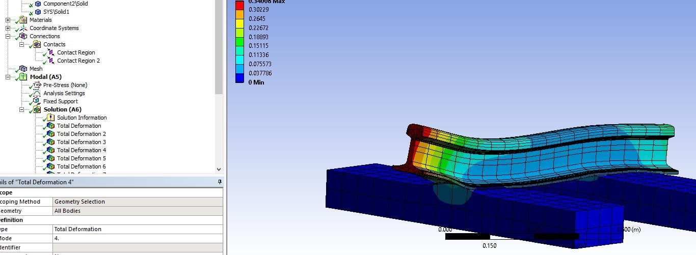

      Modal analysis is a linear analysis. That means ANSYS has to convert a nonlinear contact into a linear contact to do the modal analysis. Therefore a frictional contact that is closed is automatically converted into a bonded contact to do the modal analysis. That is why you get the unrealistic simulation result you show in this image.
      It would be easier to match lab data to simulation data if instead of a wide flat wooden sleeper, you put a narrow rod under the rail. Then in the simulation, you could split the face where the rod touches the rail, and make that split line a remote displacement and constrain just 3 DOF and leave the rest free. Then you don't need the sleepers in the model at all.

      Oops, Peter is right. Frictionless and frictional contacts are nonlinear contacts, and in modal analysis, we can only have linear contacts.
