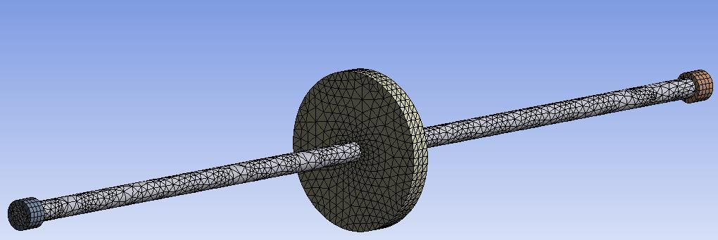

      this is a model I made on ANSYS and for this model, I did mesh refinement 2 times but still obtained the result in order of 48 Hz.
      What are the supports at each end of the shaft in the ANSYS model?
      What are the supports at each end of the shaft in the theoretical calculation?
      Fixed supports will give different natural frequencies than pinned end supports.

      The shaft is simply supported in the theoretical calculation but in ANSYS I don't know how to simulate the simply supported condition so I made two small rings around the periphery to simulate inner race of the bearings and fixed those rings.
      I'd be more than happy if you could help me with supplying the simply supported end conditions.
      Delete the two small rings. Make sure the shaft length is equal to the theoretical length.
      Supports > Simply Supported, pick one end face of the shaft.
      Supports > Simply Supported, pick the other end face of the shaft.
      Now the shaft is free to spin on the axis, which gives one natural frequency.
      Supports > Fixed Rotation, pick one end face of the shaft and keep X Fixed but set Y and Z Free (if the shaft is on the X-axis).
      This gives another natural frequency.
      Supports > Fixed Rotation, pick the other end face of the shaft and keep X Fixed but set Y and Z Free.
      This gives a third natural frequency.
      If you Fix the Y and Z rotations at both ends, that turns the BCs into the equivalent of Fixed Supports and you will get a fourth natural frequency.
      Does the theoretical result use an actual disk or a point mass of 3 kg?
      There is a different natural frequency for an actual disk with a mass of 3 kg and a point mass of 3 kg.
      To make a point mass at the center of the shaft, you have to split the shaft at the center to create a face in the middle. Use shared topology to reconnect the two pieces. Then insert a Point Mass on that face at the center.  This will shift the natural frequencies of all the above results.
      If the theoretical result uses an actual disk, specifying that the disk has a 3 kg mass is an incomplete specification. You need to know its diameter also. Without that, I can make a large diameter, thin disk or a small diameter thick disk that both have a 3 kg mass, but they will each give different natural frequencies.

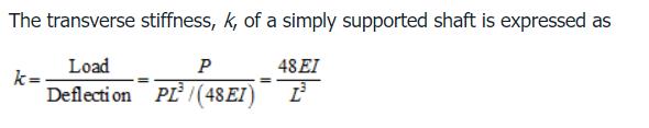

      for theoretical calculation, I have used [12EI/(L^3)] to calculate the stiffness and natural frequency is obtained by sqrt[K/M] and for my case, I obtained the natural frequency value as 81.22 Hz. (I have used K = [12EI/(L^3)]  for the case of bending frequency).
      Here is a reference on Jeffcott rotors.
      Where did you get the formula for K?  This reference says K = 48EI/L^3
      It says the shaft is massless, your shaft has mass.
      It says the rotor point mass is eccentric from the shaft with a distance of e, where is your eccentricity?
      It says the prevalent vibration is synchronous whirl, which means it is equal to the rotor angular frequency of 50 Hz from the 3000 rpm you stated above.
