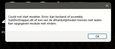

SubscriberHello,
I have installed (SpaceClaim 2024 R2 version) on a pc, but am getting the following error when trying to startup SpaceClaim:
(Translation: Could not load file or assembly SubDivWrapper.dll or one of its dependencies. The specified module could not be found.)
I have checked this file and it is in the installfolder.
I gave full rights to the install folder aswell.
What can i do to fix this?

SubscriberHello Paul,
This is an unusual issue. Is it feasible for you reinstall it? It could be possible that the installation was failed, or was completed with error.

SubscriberHello,
I tried to reinstall it and also checked the installation log, but there is no error mentioned.
