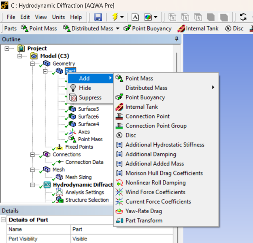

Please can you confirm which Ansys version you're using?
Mike
May 14, 2025 at 2:46 am
quoctran0606
SubscriberÂ
I am using Ansys 2023 R1 version
May 14, 2025 at 8:00 am
Mike Pettit
Ansys EmployeeHello,
Moonpools were introduced in Aqwa at Release 2023 R2, so you will need to update your installation before you can use this feature.
Mike
May 14, 2025 at 8:35 am
quoctran0606
SubscriberThank you very much
