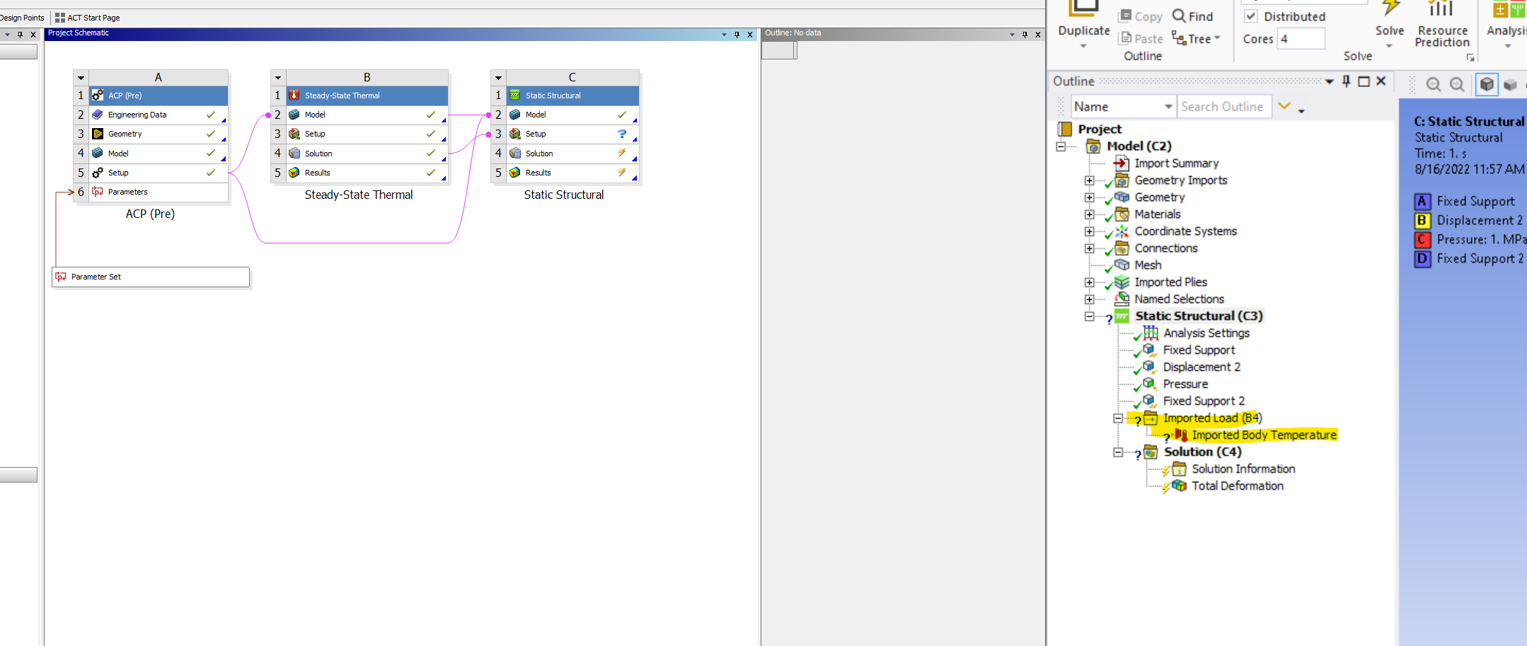

      I am trying to create a thermal and structural analysis for a composite vessel. When I import the thermal solution to static structural, the imported load is missing. It works the first time when I import, but after I updated something in ACP pre/thermal, it went missing again. Does anyone know why the load is missing, and how to prevent that, since I want to put it in parameter set.

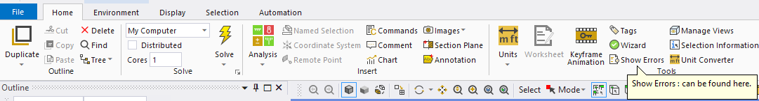

      Can you please click on show errors:
      and see what errors show up?
      Can you create a named selection for required bodies in system A4 and use that for scoping of entities for the imported load in Static structural?
      -Aniket
    • Wai
      I can't, since it is the solid model generated by acp pre.
