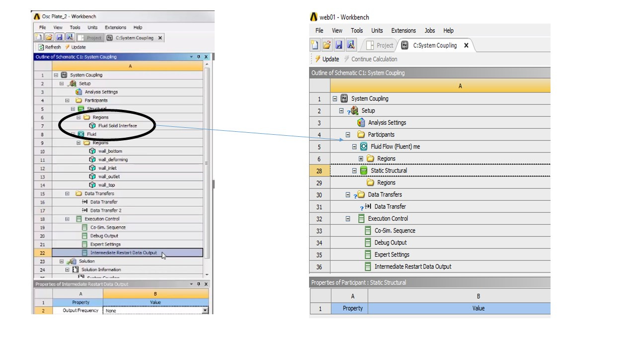

SubscriberI am not sure, I was watching the you tube tutorial (https://www.youtube.com/watch?v=FN2MfWBv3Sk&feature=emb_logo)on the system coupling, I found that they have option of fluid solid interface within structural region(left image) but during my simulation, I was missing them(right image), Did I done anything wrong ? why there is question mark on the setup and data transfer?
September 11, 2020 at 1:33 amKarthik Remella
AdministratorHello,nAre you able to create Fluid Solid Interface in your Structural simulation? Right click on Transient in the tree and select Insert > Fluid-Solid InterfacenThanks.nKarthiknViewing 1 reply thread- The topic ‘Missing Fluid Solid Interface in the region’ is closed to new replies.
