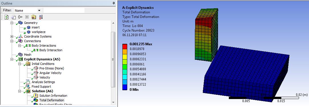

      Hello everybody,
      My simulation is not working as intended. It is not removing any chip.
      Details are below;
      I defined two materials; a milling insert as Ceramic Insert Al203 and the workpiece as gray cast iron. Gray cast iron is defined as perfectly plastic.
      I have defined friction between materials. Workpiece is fixed underneath. Insert has an angular velocity of 900 rpm and feed velocity of 0.03m/s.
      I attach the archieve file and a screenshot showing the problem. Thank you all for your help.

    • dinler
      Here it is. Insert deforms but does not machine the workpiece.
    • Sandeep Medikonda
      Is it even moving and making contact as intended?
      Why is it developing deforming in the picture, is it just due to the inertial forces from Angular velocity?
      Your boundary conditions are not being properly defined, use a constant velocity b.c as I show here and constrain all the other movements using the displacement boundary condition. In that post, I did it by constraining Z, where needed:

    • dinler
      Sir,
      I redefined the boundary conditions as below and made it work, one minor problem though. I want the insert to rotate in a circular arc(I defined -900rpm on insert) however when 2 bodies collide, insert slowly slips in +x direction. Is there anyway that insert only rotates and follow the arc, and all 5 DOF's restricted like revolute joint.
    • Sandeep Medikonda
      Dinler,
      You can always use a Remote Displacement to do this and try inserting an initial rotation velocity for the one degree of freedom that is not constrained.
      Sandeep

    • dinler
      Dear SandeepMedikonda,
      After changing velocity to angular velocity, It worked. Why it is not working with velocity though? Sorry if it is a newbie question. Thank you for your help.
