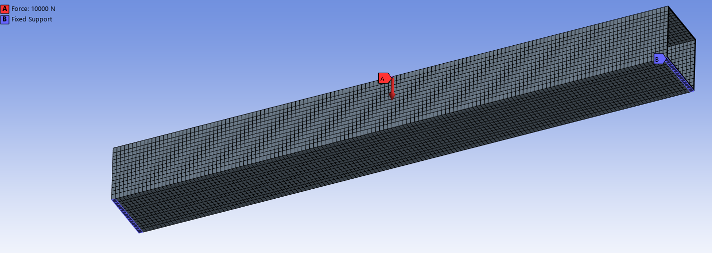

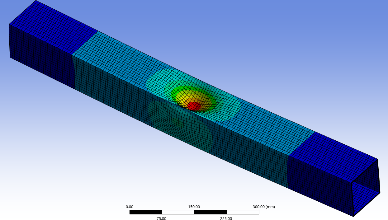

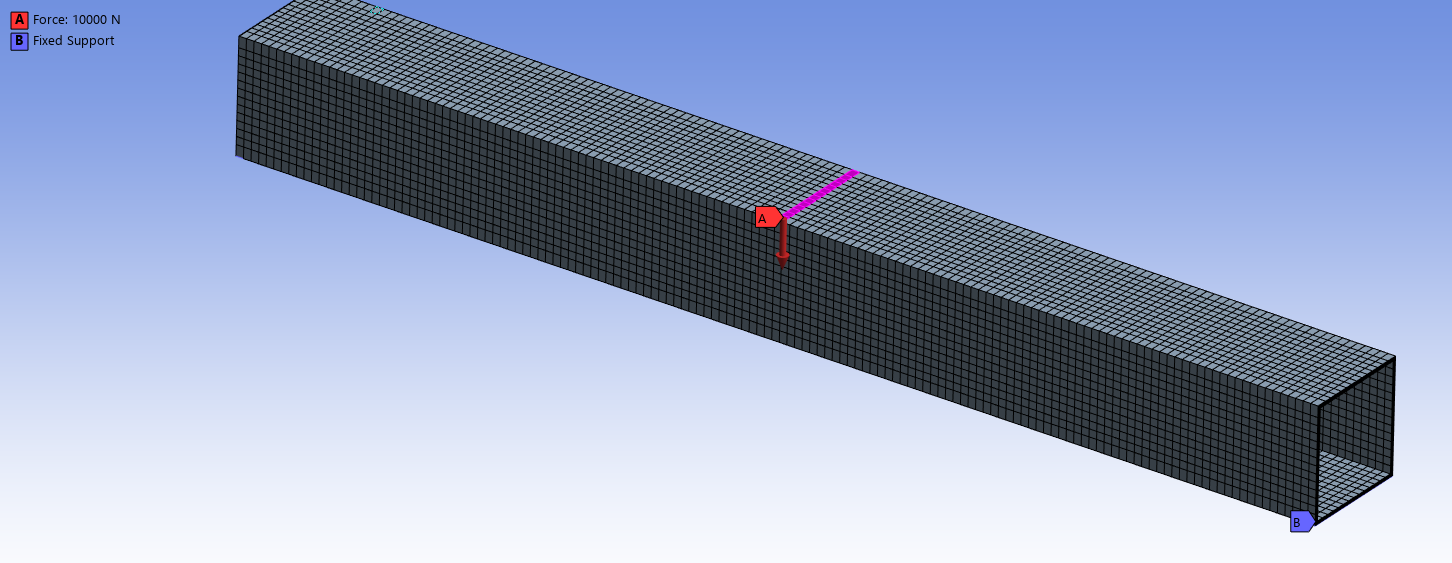

      Hi everyone,
      I'm currently working on a numerical simulation of a composite hollow square beam undergoing three-point bending.  I made the solid model in ACP and used static structural for the flexural test simulation. I applied the boundary conditions as shown in the figure. and the deformation results formed a "dimple" at the centre. Could anyone please explain whether this method is wrong for a 3-point bending test simulation? Also, why does this "dimple" formation occur ?
    • Ashish Khemka
      It looks load is concentrated and causing a sort of pinching. Please refer to the following video:
      https://youtu.be/Tl1S93BL8ow?si=3eyJ0APMQ7ZlYN8p
