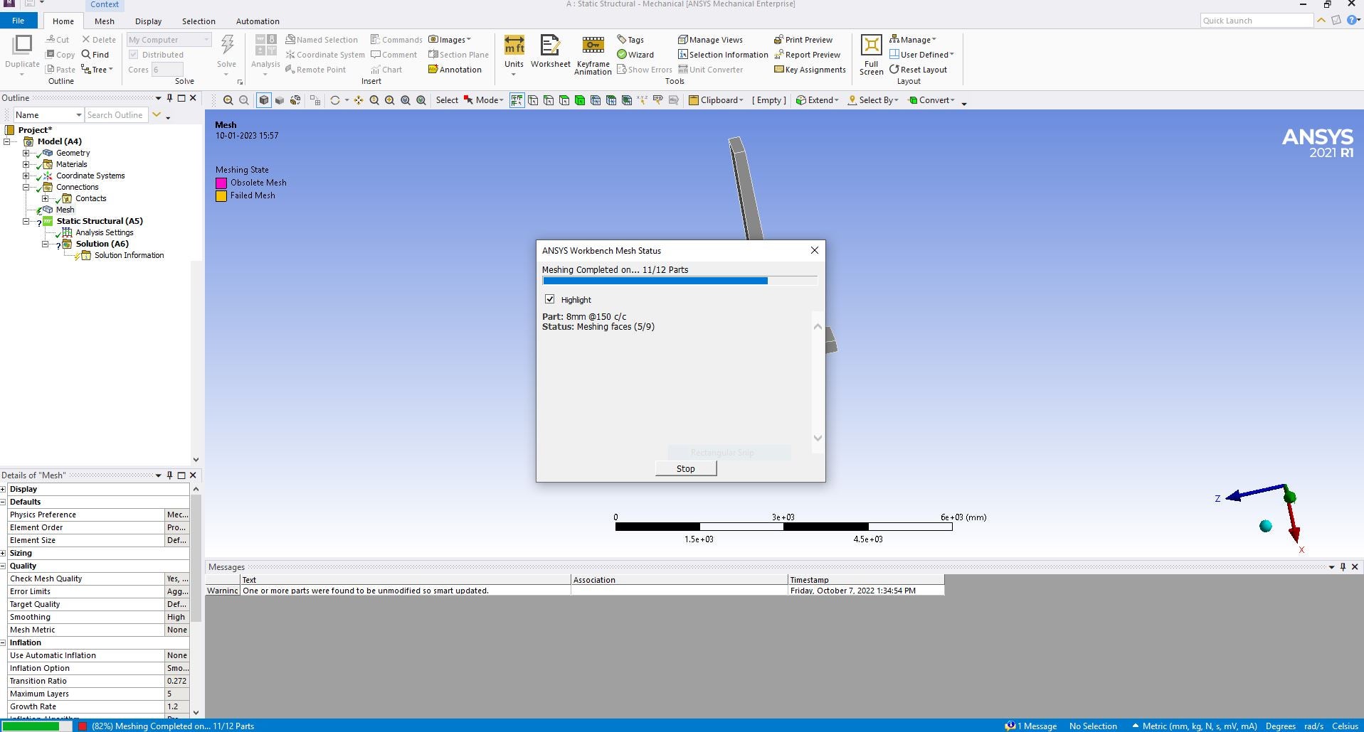

Meshing stuck at 82%
    • Abhishek Rizal
      ive checked for any geometry errors in spaceclaim, even though no errors are present meshing always gets stuck at 82%. I tried with coarse mesh same outcome. what do i do?
