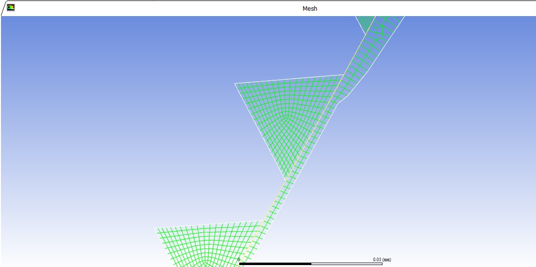

      hello dear all,
      I am doing meshing between two concentric circles. the distance between two concentric circles 5 micrometers. I have previous studies meshing I want to make mesh like that.
      I tried the inflation layer between two concentric circles but I want inflation between two circles. I have attached two two mesh images. and
      also attached
      the meshing archive file please check and correct me.
      Thanks in Advance.

      The Knudsen Number is fluid & domain dependent.  The characteristic dimension here is 5 microns; you need to find/calculate the mean free path.
      I would also suggest building the model at a larger scale: CAD faceting will give you problems as the gaps close to 5 microns. I'd build the whole device in mm (eg have a 5mm gap) and then scale when reading into Fluent.

      The suggestion from rwoolhou is to draw the geometry 1000 times larger by creating all the features in mm as if it were microns, and mesh 1000 times larger, pretending 1 mm is 1 micron.  When the mesh is finished, a simple scale factor is used when it is imported into Fluent that divides the geometry by a factor of 1000. Fluent has a better ability to handle very small dimensions than the Mechanical program.  This is a trick to work around the limitations of Mechanical.

      The problem you have is you're looking at massive differences in length scale. 5 microns adjacent to 300mm is going to push CAD tolerances even if you scale up. Similarly using VOF (if you need multiphase) at that scale is difficult as the surface tension forces (N/m) become massive.

      Fluent will scale whatever dimensions you tell it to. As it's accurate to many more significant figures than CAD (especially with double precision) it's been a route in for micro scale modelling for years.  Your problem is the range of scales in CAD: if you're not careful even with scaling the curve faceting will close up the channel.
      At 5 microns you're also into a flow regime that CFD codes aren't designed for. Yes it will work, but the resolution required may give time steps that are too small to solve in a reasonable time frame. You also need to read up on how your liquids interact with the material surfaces at that scale: CFD models assume a bulk surface property.
