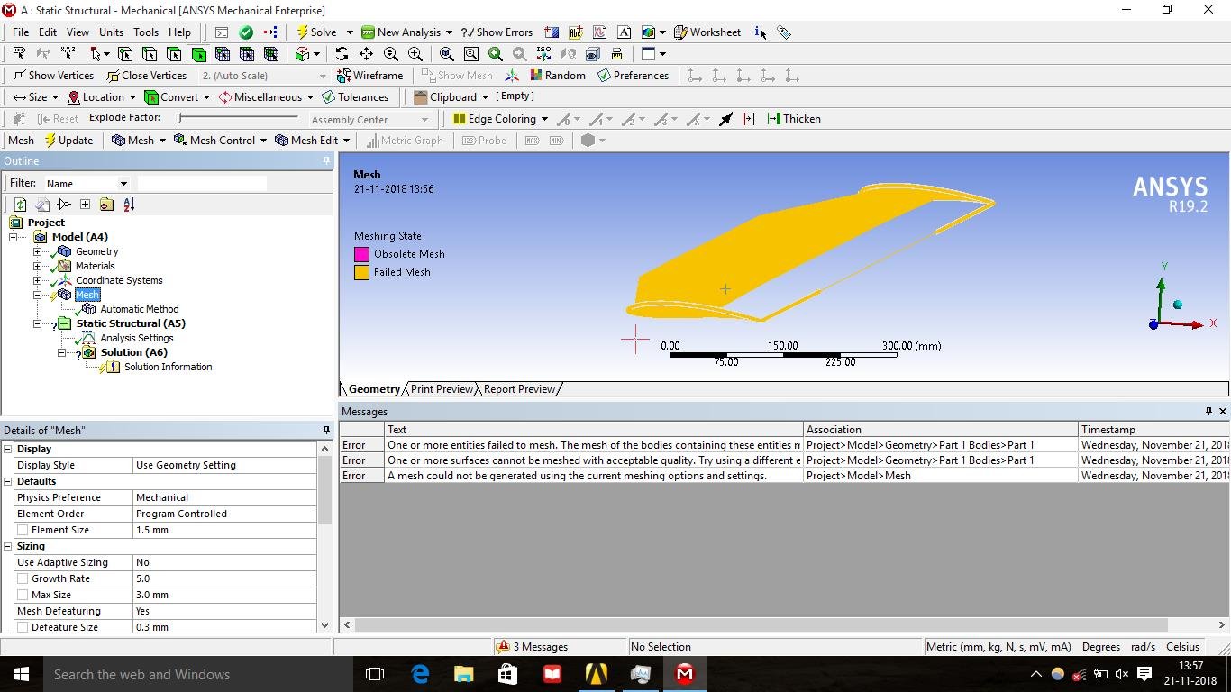

      I tried to mesh this geometry as given in the screenshot but it showed error. I do not know which setting i should used to mesh this geometry
      dimension of trailing edge is 0.03mm

      1. Turn off mesh defeaturing, currently mesher will remove any features below 0.3 mm
      2. Apply edge size on the trailing edge to capture it well.

      Thanks Aniket my problem is solved as you have given meshing techniques
