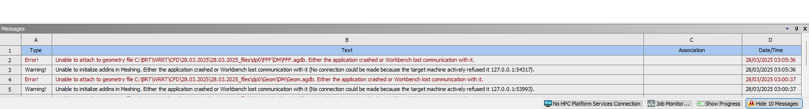

      After working in the geometry section of the Fluent block, whenever I open the meshing section it automatically crashes and gives the following meshing error:
      Here is the error message:
      I've tried using different STP files (different models for the same rocket), and tried uninstalling and redownloading ansys student to no avail. I'd really appreciate any help so I can finally open the meshing window without it crashing every single time. Thank you.

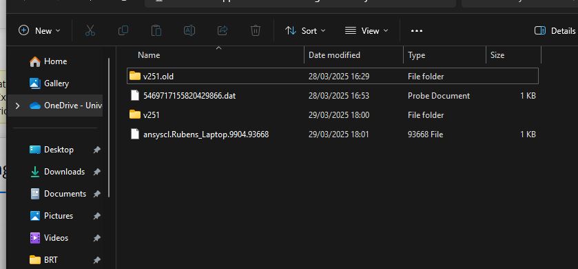

      Try renaming the %APPDATA%\Ansys\v{version} folder for the version you are using:
      Exit Ansys.
      Open File Explorer,
      In the Address bar, enter: %APPDATA%
      Open the Ansys folder
      If you are using version 2025R1 for example
      Rename the v251 to v251.old
      (other versions similar)
    • rjf55
      Unfortunately this hasn't fixed it either

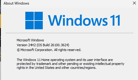

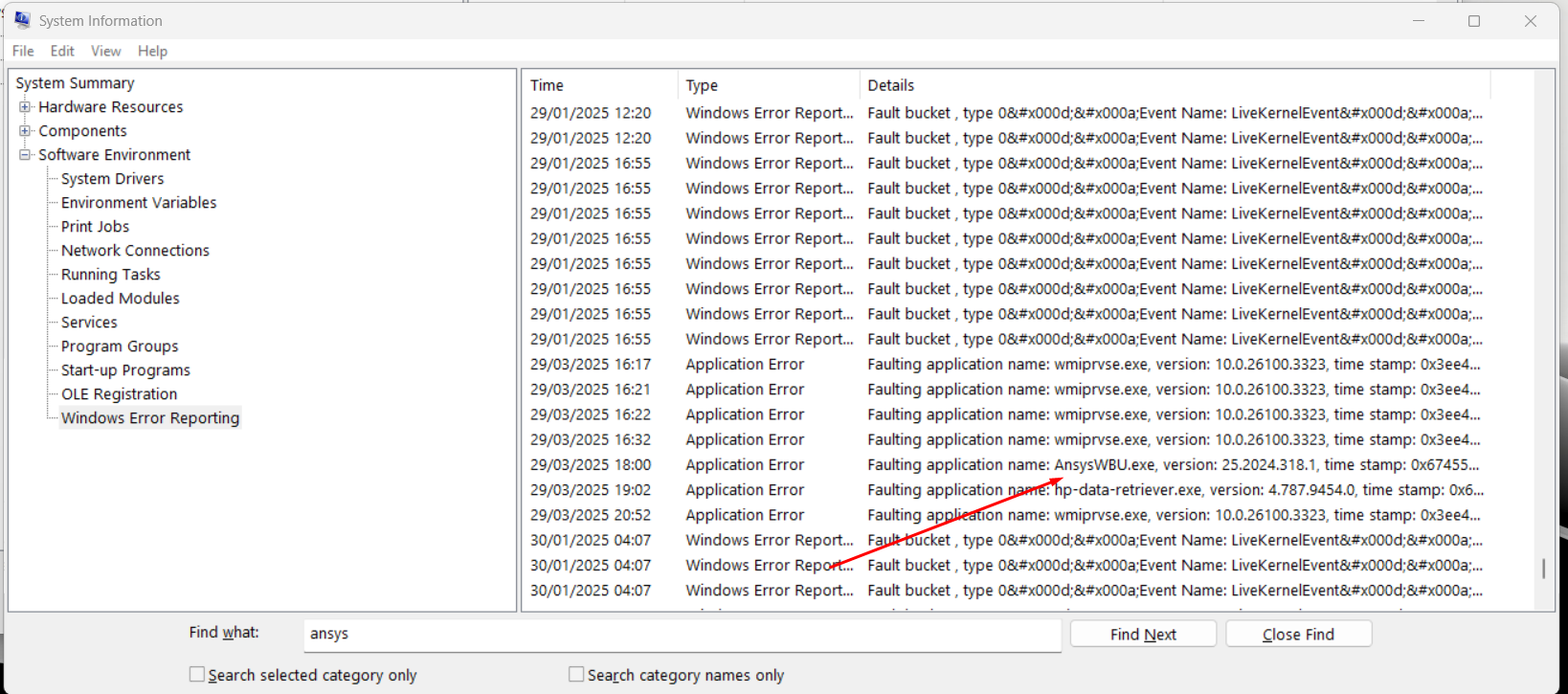

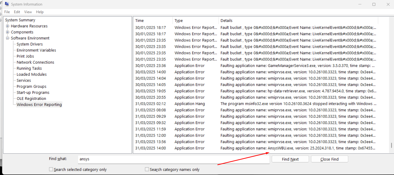

      What is the exact Windows version / Windows update version? (Run winver.exe)
      Run Windows System Information (Run msinfo32.exe)
       Software Environment > Windows Error Reporting
       Tip : File > Export to a .txt file for easirer searching and visibility.
       Look for anything relating to Ansys, such as AnsysWBU.exe etc.
       Make note of the .dll where the error is occuring.
    • rjf55
      Here's all the info you requested:
      Thank you very much.
    • Gary_S
      Windows 11 update 24H2 will not be officailly supported by Ansys until 2025R1 + Service Pack 2.

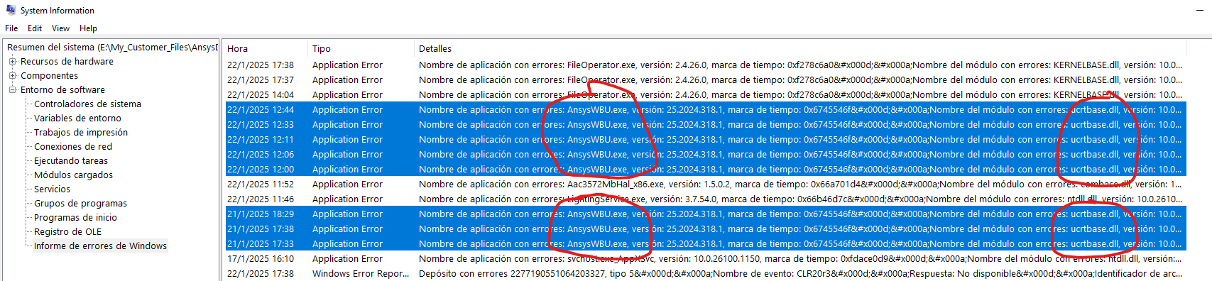

      For the System Information > Windows Error Reporting
      Here is an example of the information I was looking for...

    • Gary_S
      Please provice the infomation from the System Information > Windows Error Reporting.
      If we know the .dll where the crash is occuring, we may be able to provide more insight.
    • Gary_S
      Perfect.
      Q: Do essentially all of the AnsysWBU.exe errors refer to:
       Faulting module name: ntdll.dll, version: 10.0.26100.3624, time stamp: 0x01de64ae Exception code: 0xc0000374  ?

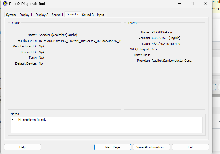

      If yes, the crash might be caused by the Realtek Audio driver package and / or Nahimic services.
      In your Windows Add/Remove programs, look for anything related to Realtek Audio or Nahimic services and uninstall it.
      Reboot. Then see if Ansys runs.
      • rjf55
        Yes, all of the errors are due to that line (ntdll.dll). I've uninstalled realtek audio driver and I don't have any Nahimic services. I restarted my pc but I'm still getting the same issue unfortunately

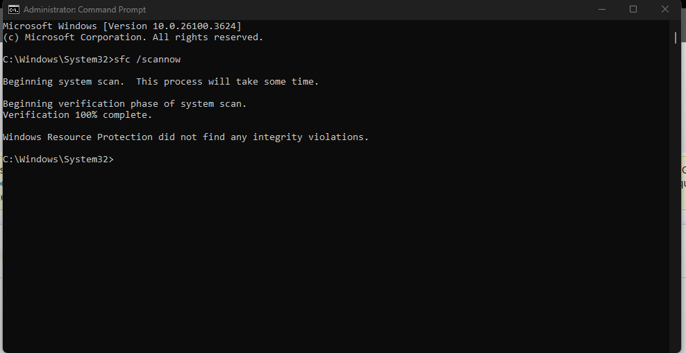

      Try Windows Update to see that all is current.
      Then:
      At a Command Prompt As Administrator:
      1. sfc /scannow
      2. Dism.exe /Online /Cleanup-Image /RestoreHealth
      3. Dism.exe /online /Cleanup-Image /StartComponentCleanup

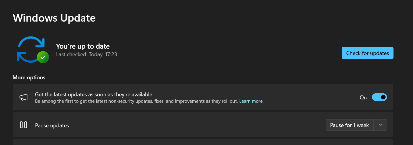

      • rjf55
        I tried all three commands and it still doesn't work unfortunately

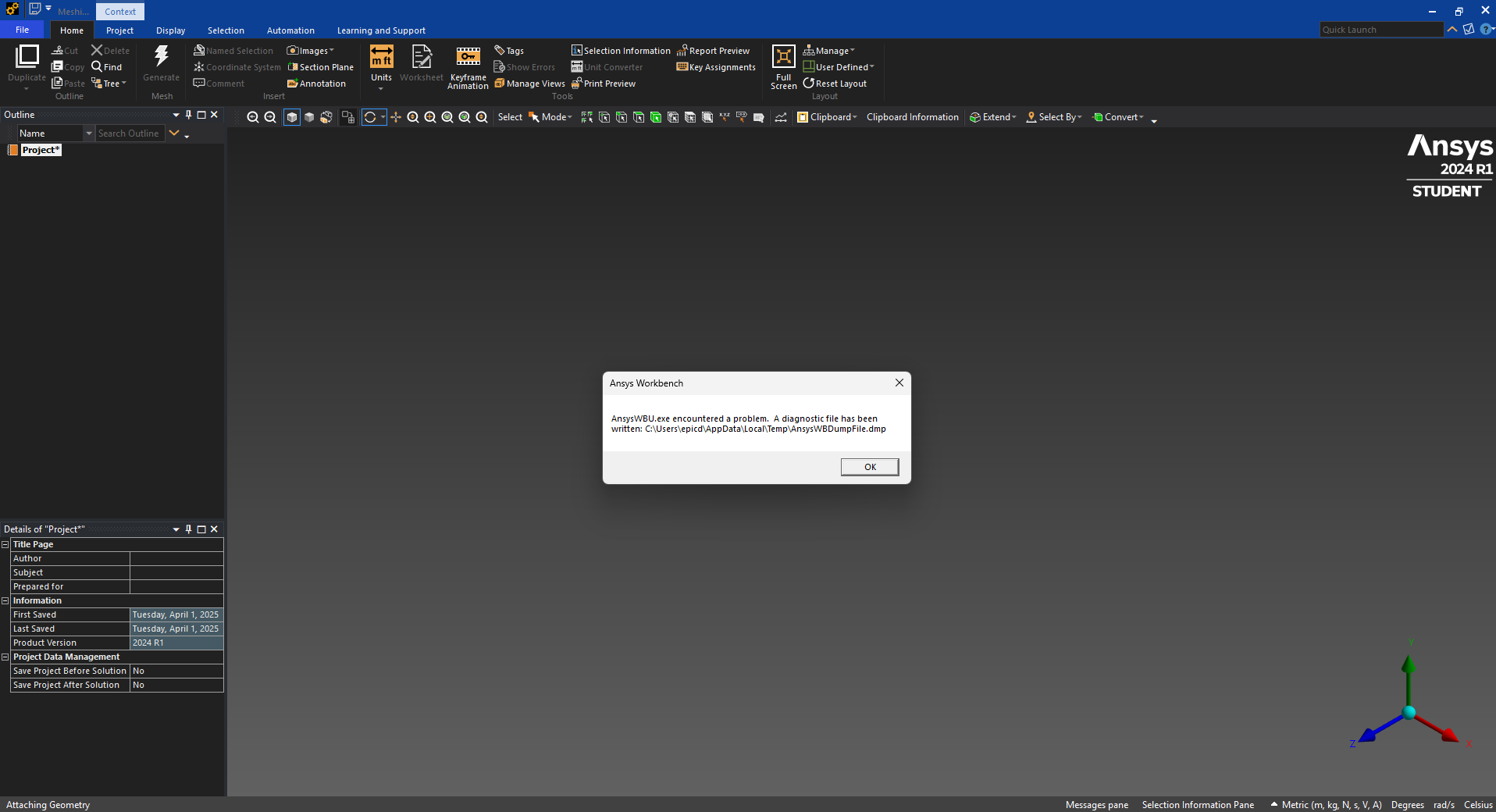

      Can you try installing one of the eariler versions 24.1 or 24.2?
      Download Ansys Student | Workbench-based Simulation Tools
      Reason for suggesting is that in 25.1, there is a known issue where STEP geometry import improperly requests a Parasolid rdpara license.
      It may or may not be related. If older versions fail in same way, it will at least give a clue.
      • rjf55
        I deleted ansys 2025 and all the files related (including in %appdata%)
        I then downloaded ansys 2024 R1 and I still get the same error

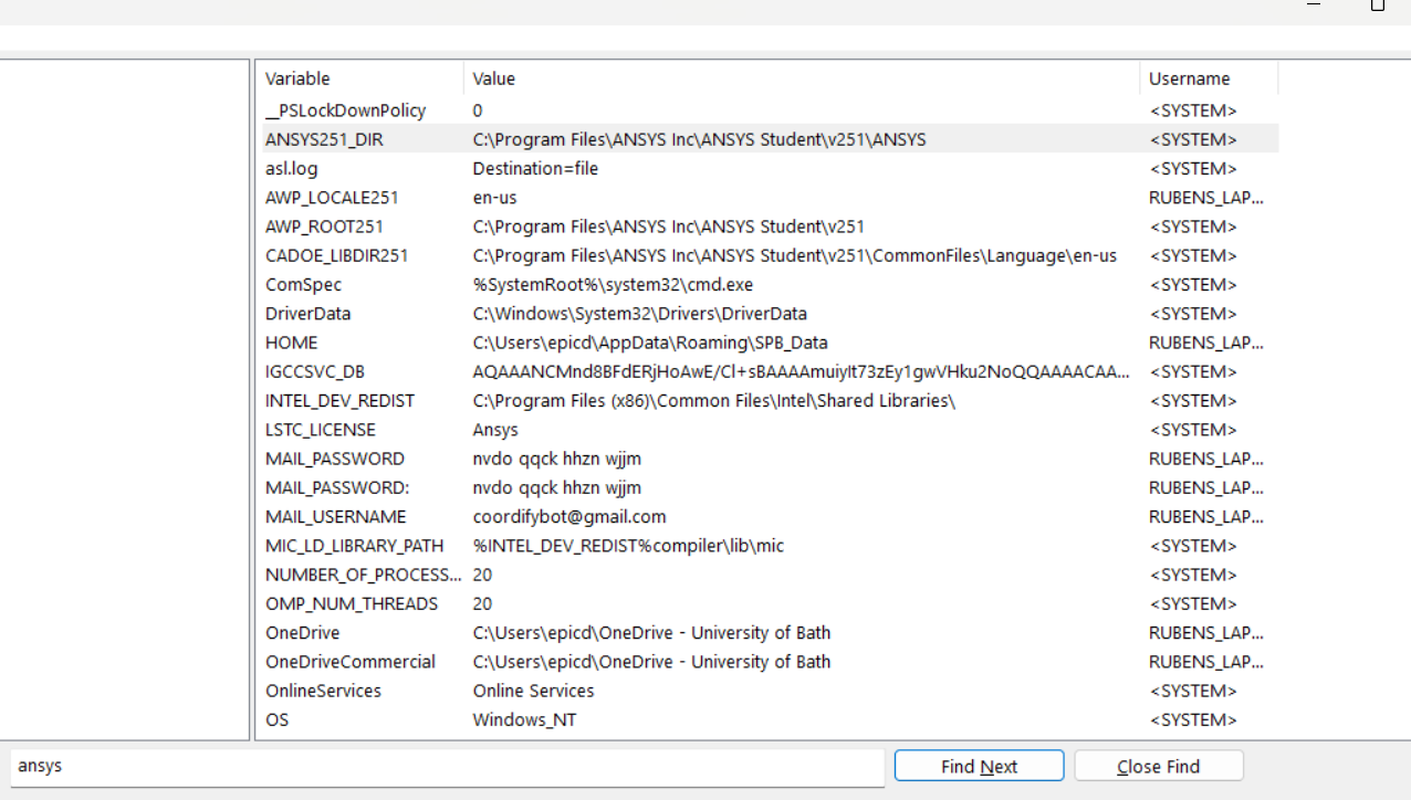

          If you want to look, see if it is the same error log entries as before… Similar to: AnsysWBU.exe … Faulting module name: ntdll.dll … Exception code: 0xc0000374
          At a Command Prompt,
          C:\> set >> env.txt
          Remove any lines that contain user information
           Copy paste the contents of the resulting env.txt and reply.
        • rjf55
          Yes, it is the same error with the same application name and exception code.
          Here is the env.txt file:

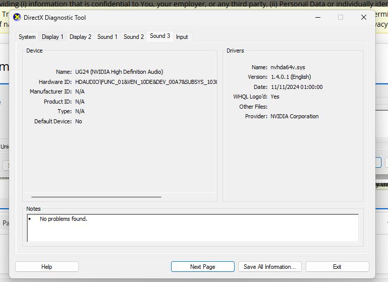

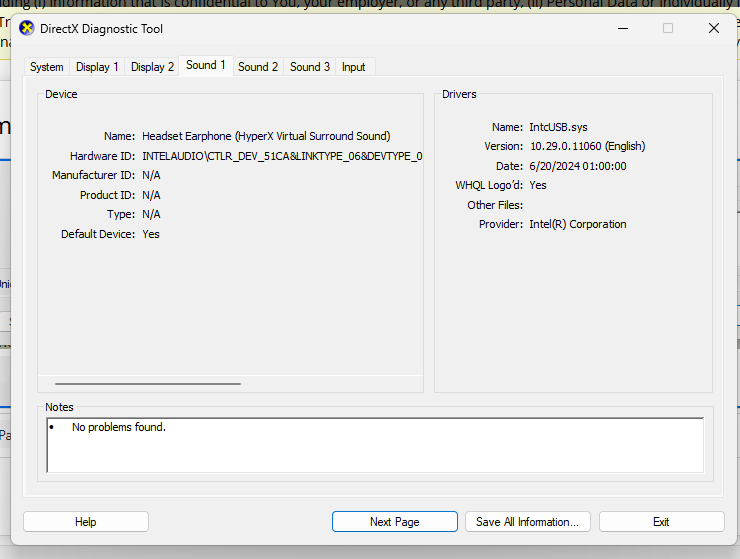

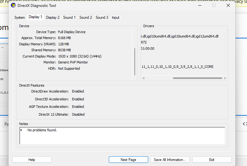

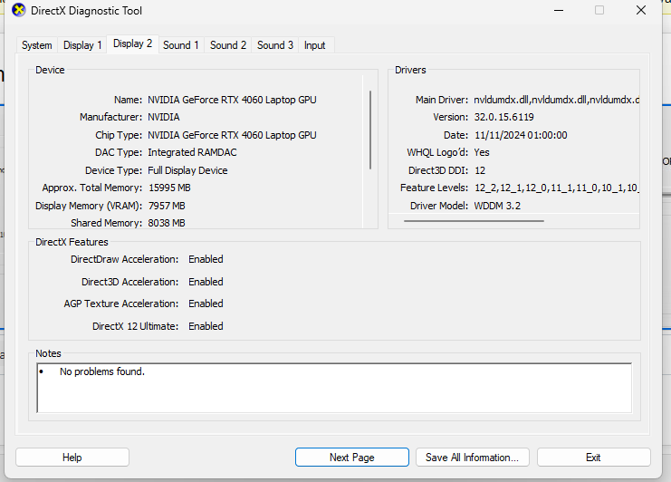

        • Gary_S

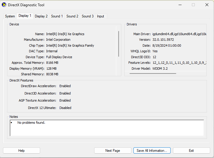

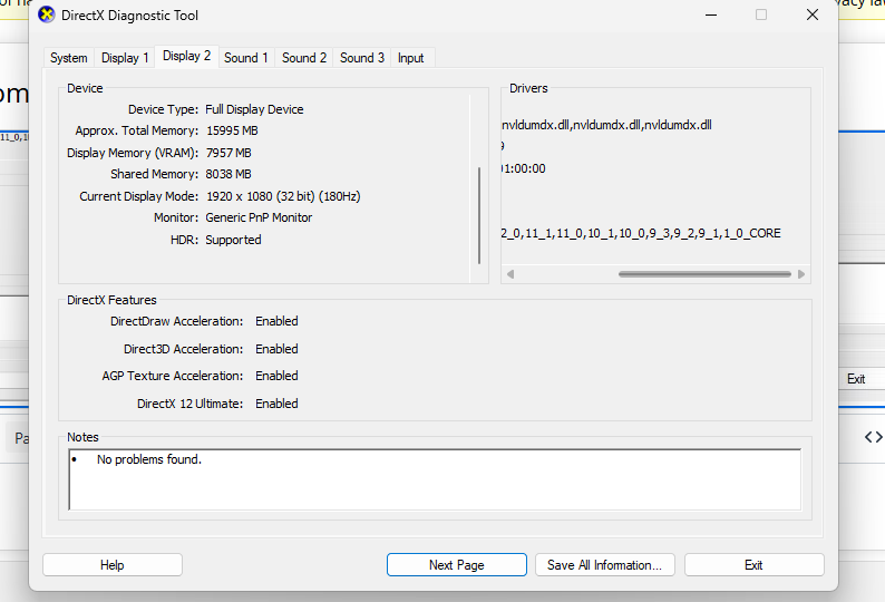

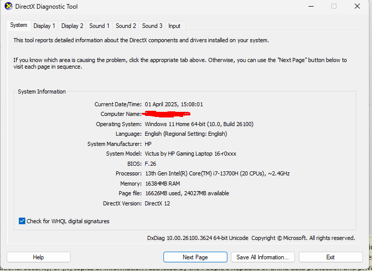

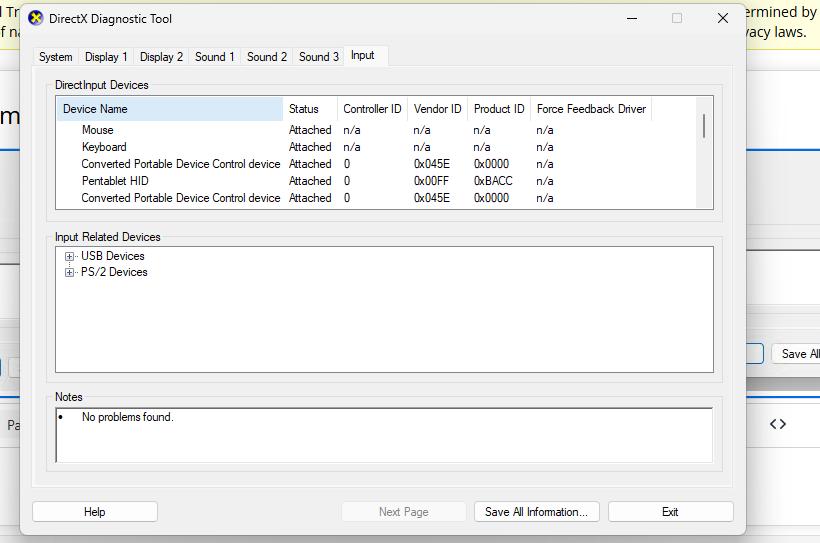

          Run: DxDiag.exe
          It will have tabs across the top Display1, Display2..
          Send a screen capture of each page.
        • rjf55
          Here's a screen capture of each page:
        • Gary_S

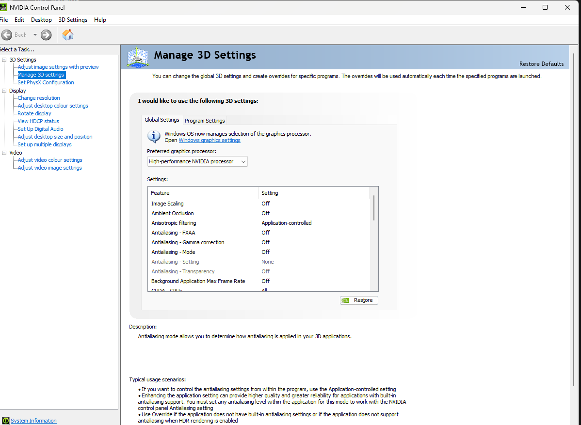

          I can see that your laptop has two graphics cards
          Try this and see if any difference.
          See if you have a Program "Nvidia Control Panel" in your Windows settings.
          Some computers have 2 graphics processors, often one is "Intel" and the other is an "nVidia"
           We need to set the Nvidia to be the "preferred" graphics adapter
          See if you can find "Nvidiacontrol panel.
            Control Panel > Nvidia control Panel > go to 3D settings > Manage 3D settings > Under Preferred Graphics Processor > choose Nvidia > Apply.
           Start Workbench and try again.
        • rjf55
          The preferred graphics card processor is already set to nvidia processor by default

      31/03/2025 14:00    Application Error    Faulting application name: AnsysWBU.exe, version: 25.2024.318.1, time stamp: 0x6745546f Faulting module name: ntdll.dll, version: 10.0.26100.3624, time stamp: 0x01de64ae Exception code: 0xc0000374 Fault offset: 0x0000000000115f55 Faulting process id: 0x5E50 Faulting application start time: 0x1DBA2452DFBFF6D Faulting application path: C:\Program Files\ANSYS Inc\ANSYS Student\v251\aisol\bin\winx64\AnsysWBU.exe Faulting module path: C:\WINDOWS\SYSTEM32\ntdll.dll Report Id: 32369405-5c93-457d-8971-cbde3227a2a4 Faulting package full name: Faulting package-relative application ID:
