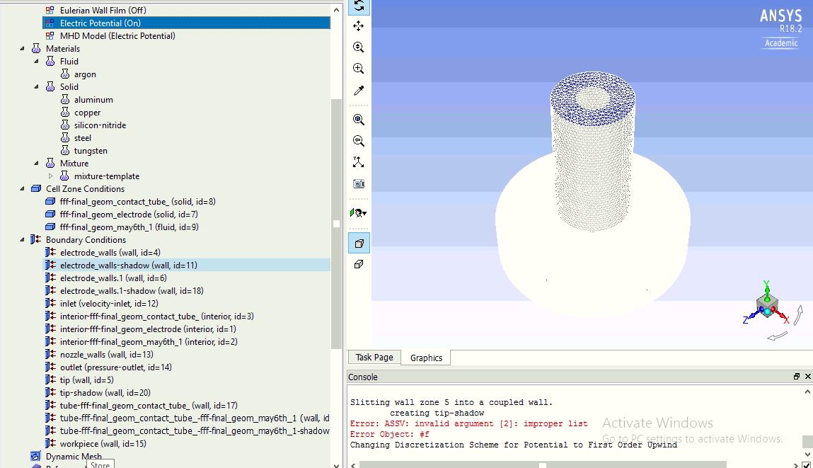

      Hello sir, I created a mesh and changed it to volume too. But I am getting something called "Shadow" for an already existing named selection and also I am not able to input electric flux while using the electric potential method, it only shows contact resistance. Before there was an input to the electric potential method. Also, I keep getting this message "Slitting wall zone 5 into a coupled wall". I have attached the image for reference.
      Thanks in advance.
      Wall & wall-shadow are the different sides of the same surface (think of a sheet of paper, you have "top" and "bottom" where one side has writing on it and the other doesn't).
      If you were adding a flux to that wall previously you may struggle as the wall is now internal: you'd typically add a thermal flux to the solid zone in this case.
