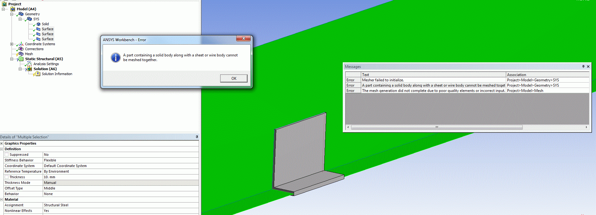

SubscriberHello! Can you help me a tell about this problem? There are surface T-element with a solid part, while the Share topology is set in the Spaceclaim. How do I customize the mesh? Help please.
September 23, 2020 at 2:02 pmCheta Rathod
Ansys EmployeeThe error message is pointing out that multibody parts of solids, sheets, and line bodies are not allowed. This is pointed out in the help manual here: https://ansyshelp.ansys.com/account/secured?returnurl=/Views/Secured/corp/v191/wb_msh/msh_Conf_Mesh_Within_Part.html?q=a%20part%20containing%20A%20solid%20body%20with%20sheetnnCan you not apply shared topology in SpaceClaim?.Viewing 1 reply thread- The topic ‘Mesh_error_solid_and_surface_contact’ is closed to new replies.
