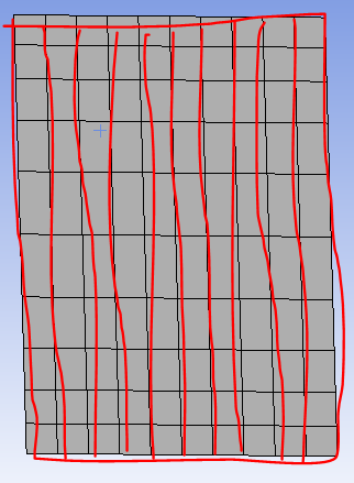

      Hi guys,
      I would like to ask that how to control the mesh. I want my mesh to look like the red line indicated and I set 2 edge sizing: 1 is for division on x, another is division for y (as seen in the images). Also, I set a face meshing on this plan, but I still got this 10x10 mesh, instead of the one I need 1x10 mesh.

      Click on Mesh in the tree. In the settings below, make sure you change it from Soft to Hard (I forget what it's called). Hopefully that's it.

      Hi Yo should mesh by sweeting. after you do sizings for top and bottom side, then chose the upper side as the source and the down side as the target, in sweet option.
