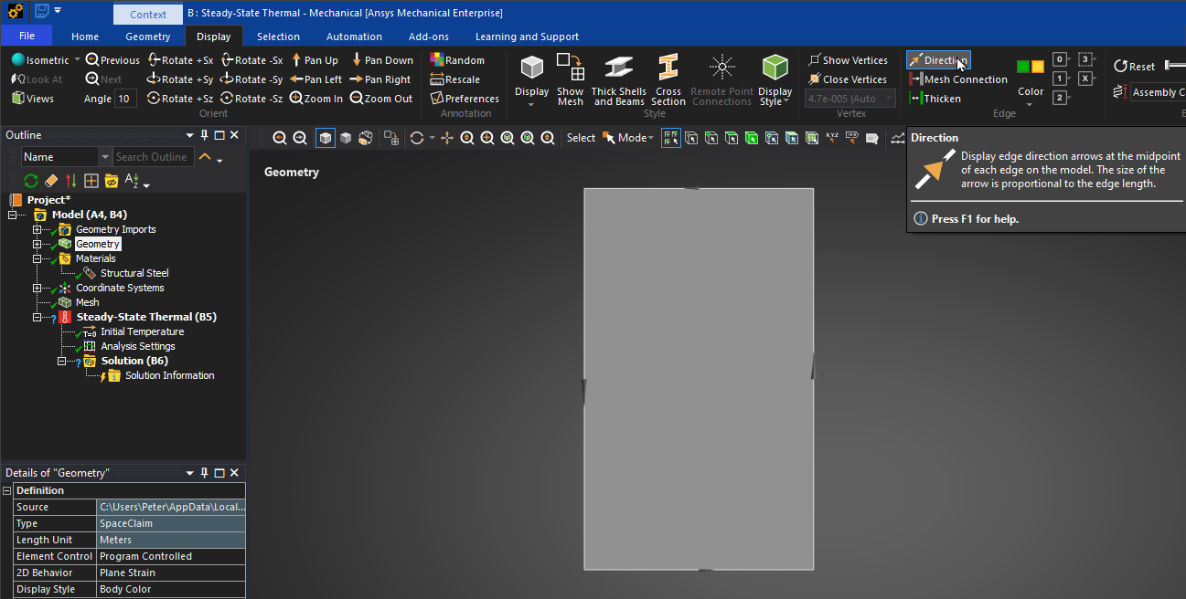

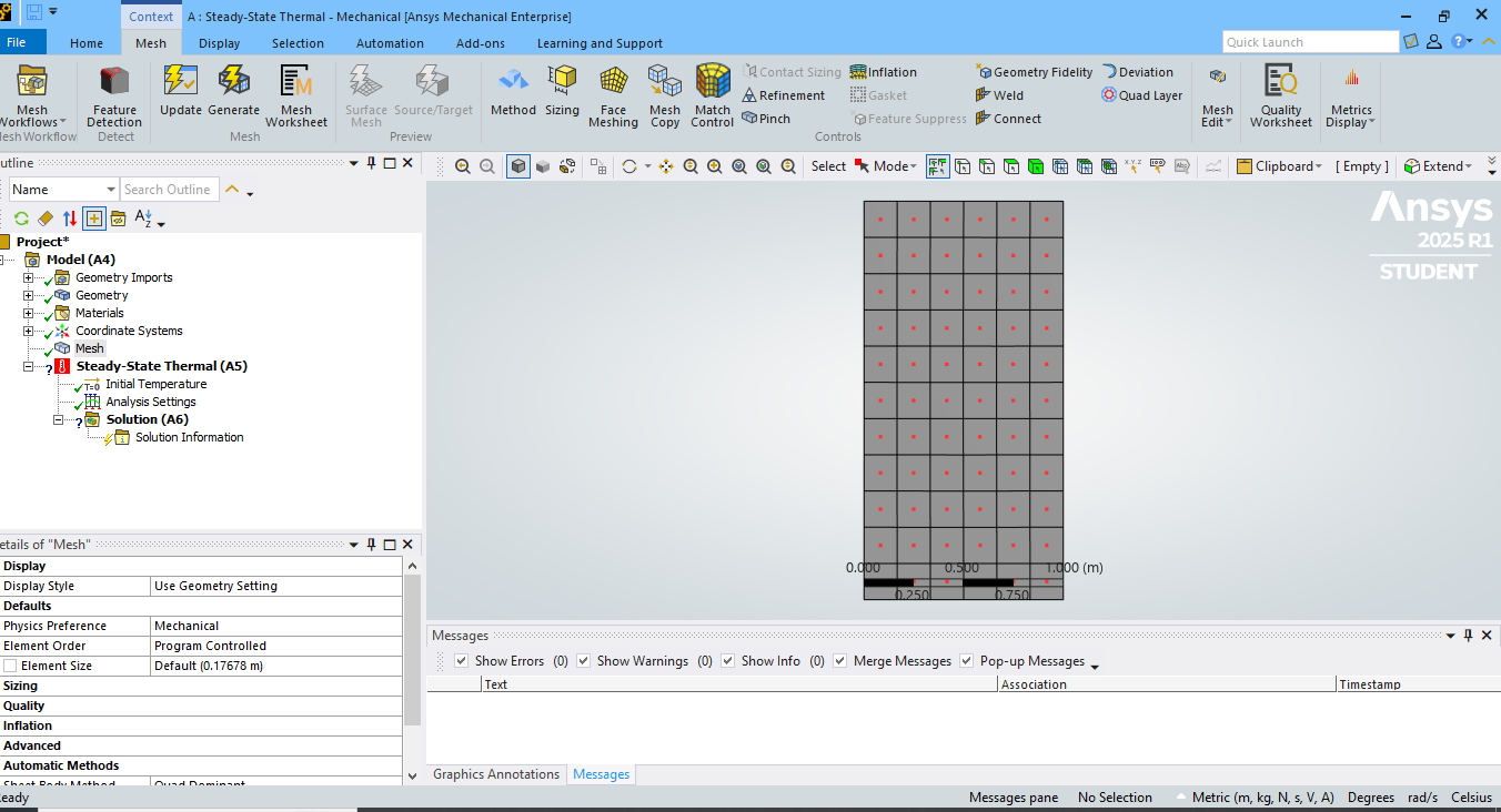

      I'm back again with problems. The two pictures attached below are the issues I'm facing, first picture is once I launched mechanical, and the second is once I update the mesh. Wasn't like that until I twerked something in the mechanical that I don't remember when trying to fix an outline problem that I had.
      Any idea how to fix the issues?
    • okanichidimma1203
      This is attachment of the second picture, thought I can add more than one picture at a time.
    • NickFL
      Are those things in the red circles you drew supposed to be there? Or are they just an artifact of the graphics? Because they are not showing up in the mesh (in your second post). Do you have a 2D geometry? Or are these 3D elements?
    • okanichidimma1203
      No NickFL, it wasn't suppose to be there and disappear once I update the mesh. It's a 2D geometry. I believe the issue is from the Ansys mechanical settings that I touched, the problem is find which of the setting caused all these. It wasn't there the first time I opened Ansys mechanical.
      • NickFL
        If it is not in the mesh, and you don't want it, there is really nothing to do. The solver is only going to see the mesh and the mesh does not have these folded features.
      In the first image, you clicked the Direction button to turn on the direction arrows on each edge.
      Click the Direction button again to turn that display feature off.
