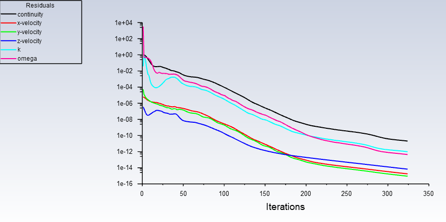

I first started with a 552K cell mesh with Y+ <1 , and the residuals converged very well. which is according to the following figure:Â

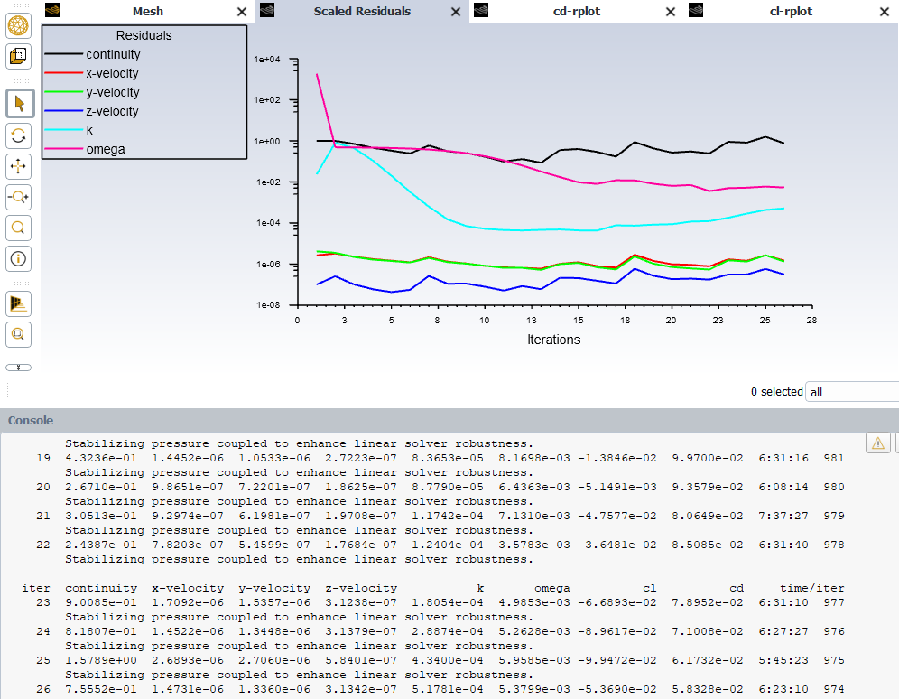

Now, I increased the number of grid cells to 1,263,000 cells, but unfortunately, this time, the residuals fluctuate strongly and do not intend to converge, and I also receive the message (Stabilizing pressure coupled to enhance linear solver robustness.) repeatedly when solving, which is as follows:
I really wonder why this is happening. To create a new mesh, I did not change the growth rate of the block lines at all, and only increased the number of nodes of the block lines, and at the end, I checked the mesh quality parameters, which were very good.
Mesh 1: Â (has very good convergence)
Aspect Ratio: 1-5700
Determinant : 0.87-1
Orthogonal Quality: 0.82-1
Quality: 0.87-1
Skew: 0.69-1
                      Mesh 2:  (has very bad convergence)
Aspect Ratio: 1-5660
Determinant : 0.895-1
Orthogonal Quality: 0.837-1
Quality: 0.87-1
Skew: 0.674-1
If you pay attention, you can see that even the quality of the second mesh is a little better than the first mesh, but its convergence is much worse and full of (Stabilizing pressure coupled to enhance linear solver robustness.) messages.
