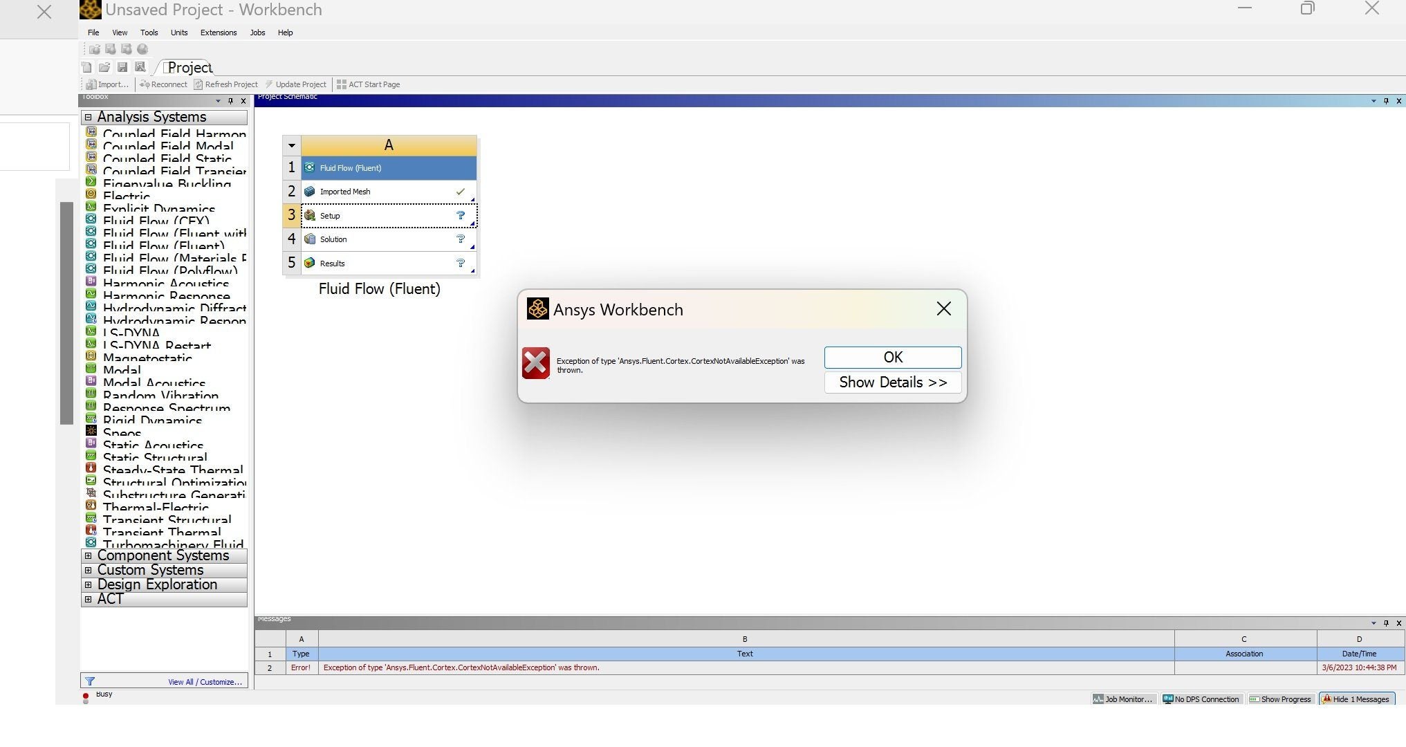

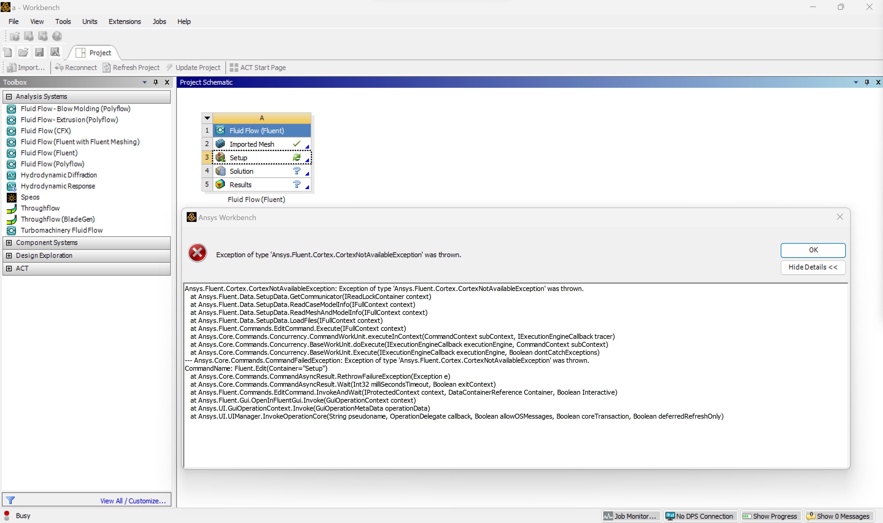

Forum ModeratorWe've seen a few issues with Gmsh output on here. Try reading it into Fluent Meshing as that might fix whatever is causing the problems.Â
March 21, 2023 at 3:42 am
March 21, 2023 at 9:54 am
Rob
Forum ModeratorOpen Fluent outside of Workbench and open in Meshing mode. Try and read the mesh in. If it works, switch to solver. If it doesn't you need to find out what's wrong with the Gmsh export - we can't help with that part - or rebuild the mesh in Ansys products.Â
