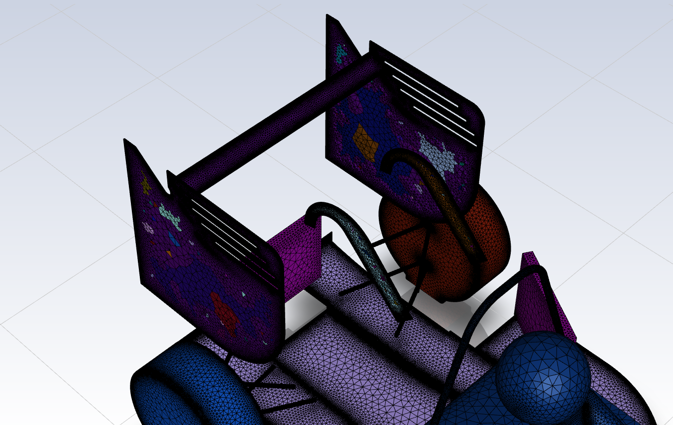

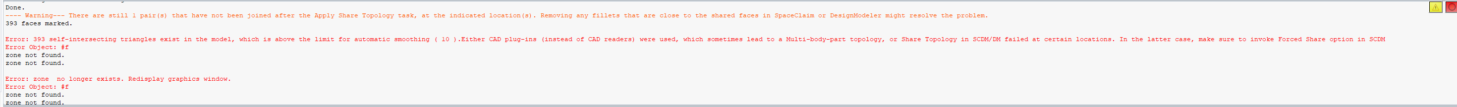

Ansys EmployeeI assume you are using watertight workflow.
Please check geometry in SpaceClaim.Â
Select geometry in structure tree --> Use right click --> Select Check Geometry. (Or Tools - Fault Detection in DM)
The geometry should be error free to proceed.Â
If geometry has any errors, please modify/recreate geometry at those places.ÂTry to split any highly curved face into more number of faces.Â
Please make sure that you define correct sizing.Â
https://ansyshelp.ansys.com/account/secured?returnurl=/Views/Secured/corp/v221/en/flu_ug/tgd_user_workflow_guided_tasks_setup_mesh_controls.html?q=curvature%20sizing
Please go through help manual for more detailsÂ
