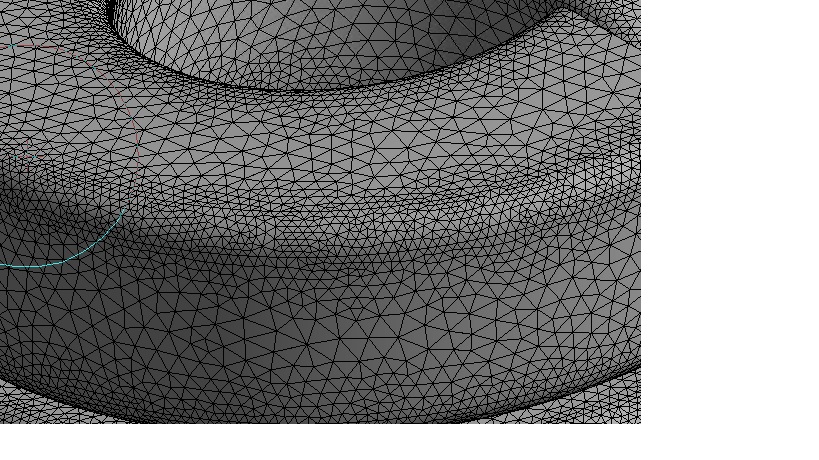

March 1, 2019 at 3:07 am
March 4, 2019 at 4:24 am
Keyur Kanade
Ansys Employeeok. this image is from mesh.Â
its all tri mesh. looks like you have all tetrahedral mesh.Â
if you have inflation defined then you may have some prisms.Â

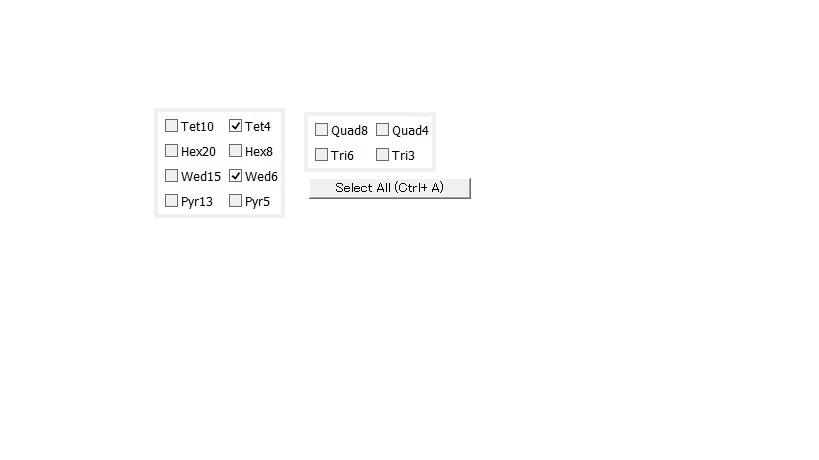

March 4, 2019 at 6:13 am
March 5, 2019 at 4:07 am
Keyur Kanade
Ansys Employeeit is wedge element i.e. prisms.Â

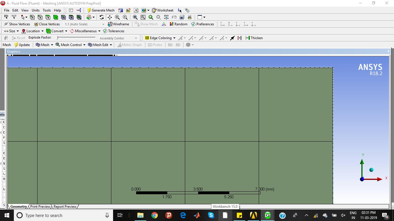

March 11, 2019 at 9:06 am
namratha98
Subscriberhi , i am unable to perform edge sizing .
it simply creates the nodes at edges but doesnt form elements.
i had done edge sizing before for various other geometries. but now, even for simple rectangle, it doesnt work. what would be the problem?
i had attached the zoomed image where u can see nodes created on the edges but it did not create respective mesh elements. can someone help me out please?

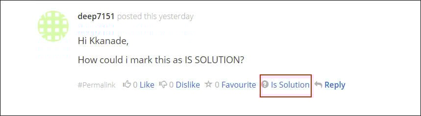

March 12, 2019 at 4:39 am
deep7151
SubscriberHi Kkanade,
How could i mark this as IS SOLUTION?
March 13, 2019 at 5:43 am
March 13, 2019 at 5:44 am
Keyur Kanade
Ansys Employeesame way you will find it below my post.Â
March 13, 2019 at 5:49 am
deep7151
SubscriberThere is no such option showing on my tab.Â
March 14, 2019 at 4:42 am
Keyur Kanade
Ansys Employeeplease log out and login again and check.Â
