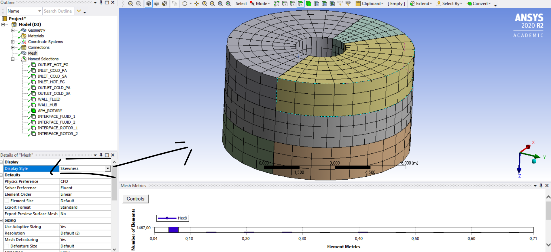

Subscriberhello, i'm sorry for some ridiculous question, i have a problem with the display style within the mesh setting that cannot display the skewness, the aspect ration, or any other display style in the mesh setting...
i thought when you activate your display style, you will see the colour variant of the different skewness in the mesh, but it doesnt change the view or anythin else...
any suggestion or advice?

Ansys EmployeeCan you please upgrade your version to 2020R2.nHere is link nhttps://www.ansys.com/academic/free-student-productsnLooks like you have section plane ON. Please remove section plane. nBy changing display style, you can see element quality. Here is simple example. nMore details can be found at nPlease try on a simple case first. nIf you want to see bad elements, you can use Quality option. As you have selected CFD, please select ortho quality. Make sure that your min ortho quality is more than 0.1. nRegards,nKeyurnGuidelines for Posting on Ansys Learning ForumnHow to access ANSYS help links

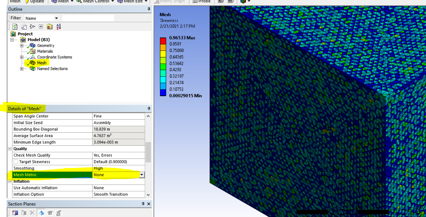

SubscriberHello Colleague;nIn order to get the color plots of element quality, Go to the section Quality in the Details of “Mesh” window down there, the Mesh Metric must be set to “None”, as seen in the figure here. Then you can go to the Display Style section of Details of “Mesh” and choose the style as you wish.nnn
