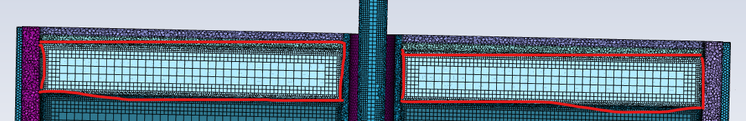

      I am using Fluent Meshing and I wonder how I can change the marked area so that it has the same, smaller cell size in the whole region. The whole area is critical so I don´t want the cell growth in the middle.
      Best regards, Johanna

      Hello, you can make use of Add Local Sizing task of Ansys Fluent Watertight Geometry Workflow Meshing to refine mesh in the particular region.
      For getting the mesh cells of same size in the region, you can use Body Size as Size Control Type in the Add Local Sizing task.
      To know more about the Add Local Sizing task of the Ansys Fluent Watertight Geometry Workflow Meshing, please have a look at the video lesson of Ansys Innovation Course on this topic whose link is given below.
