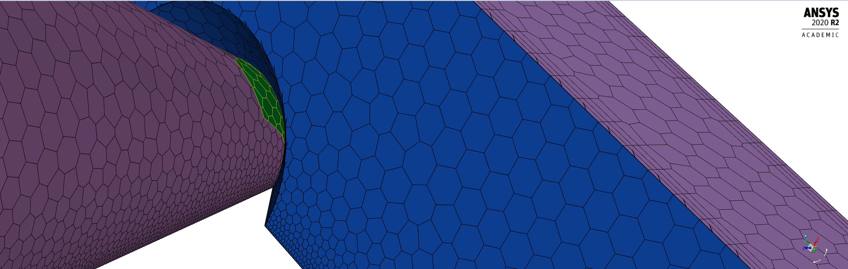

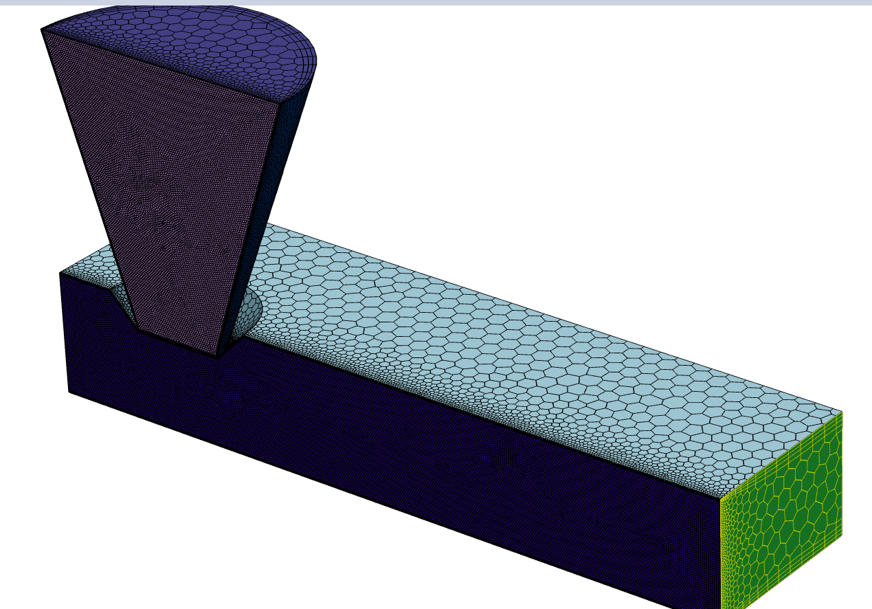

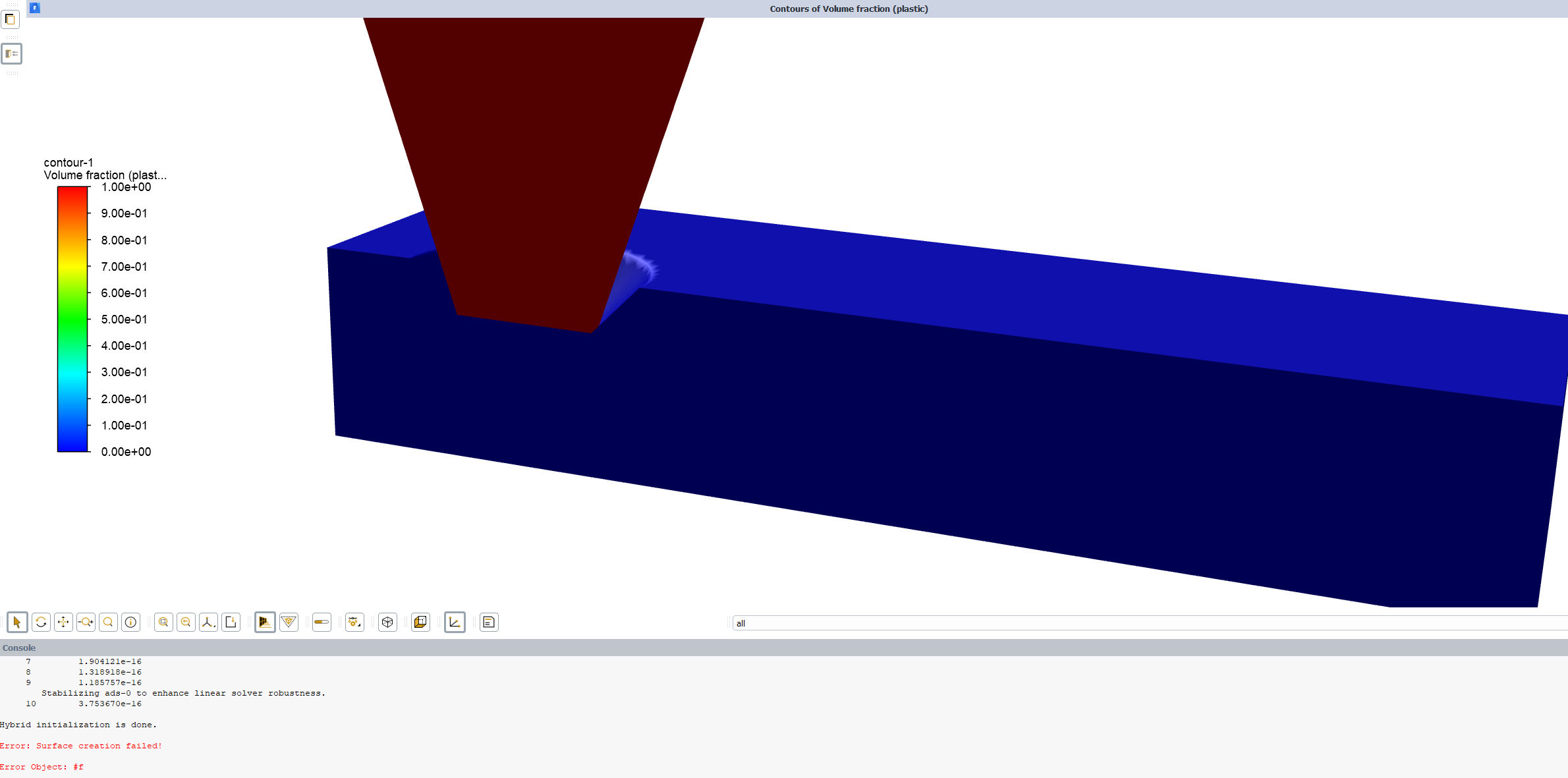

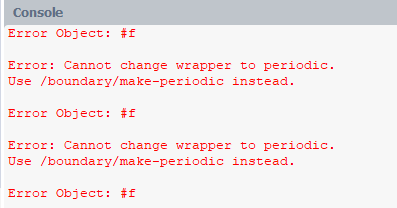

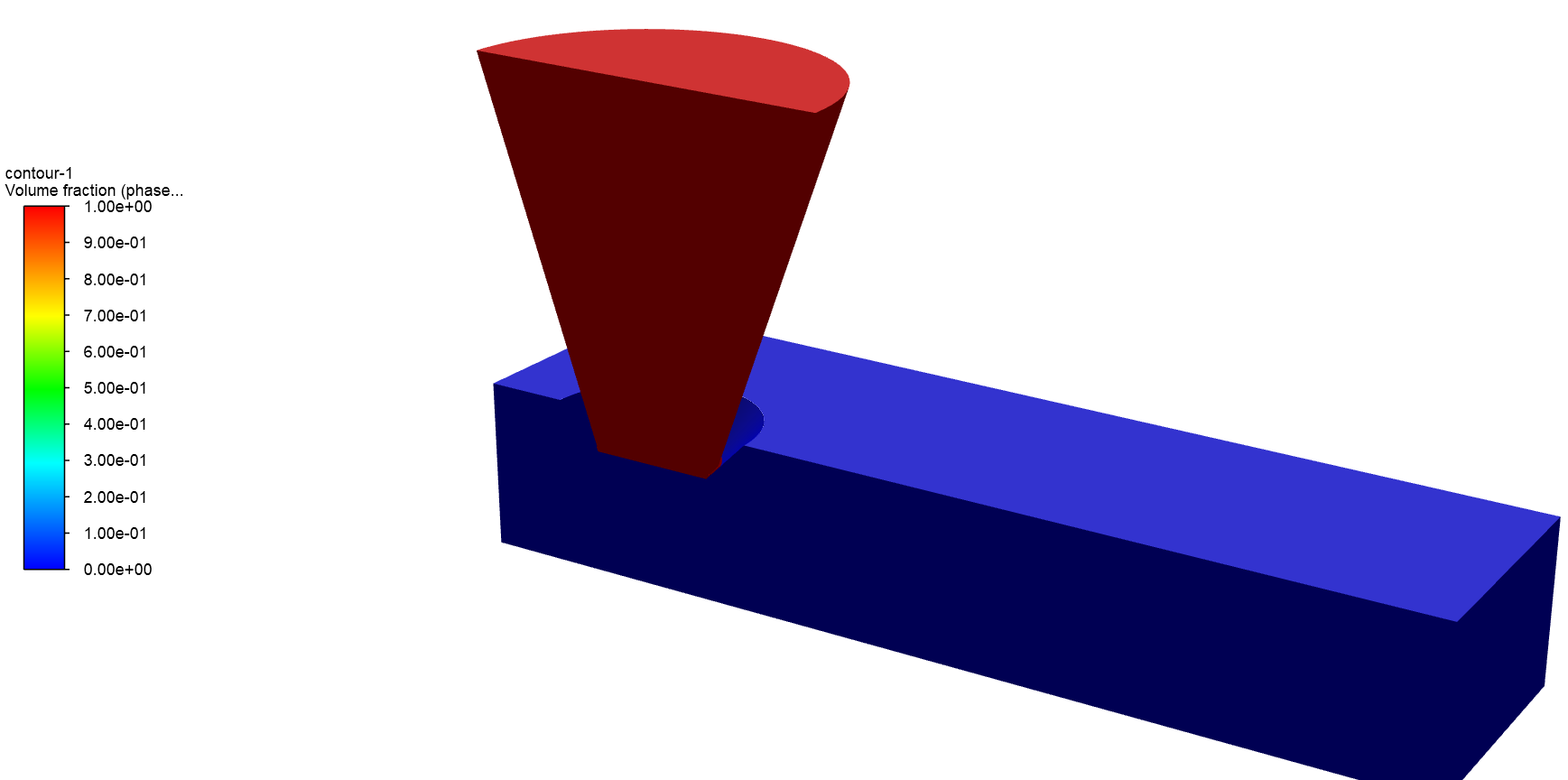

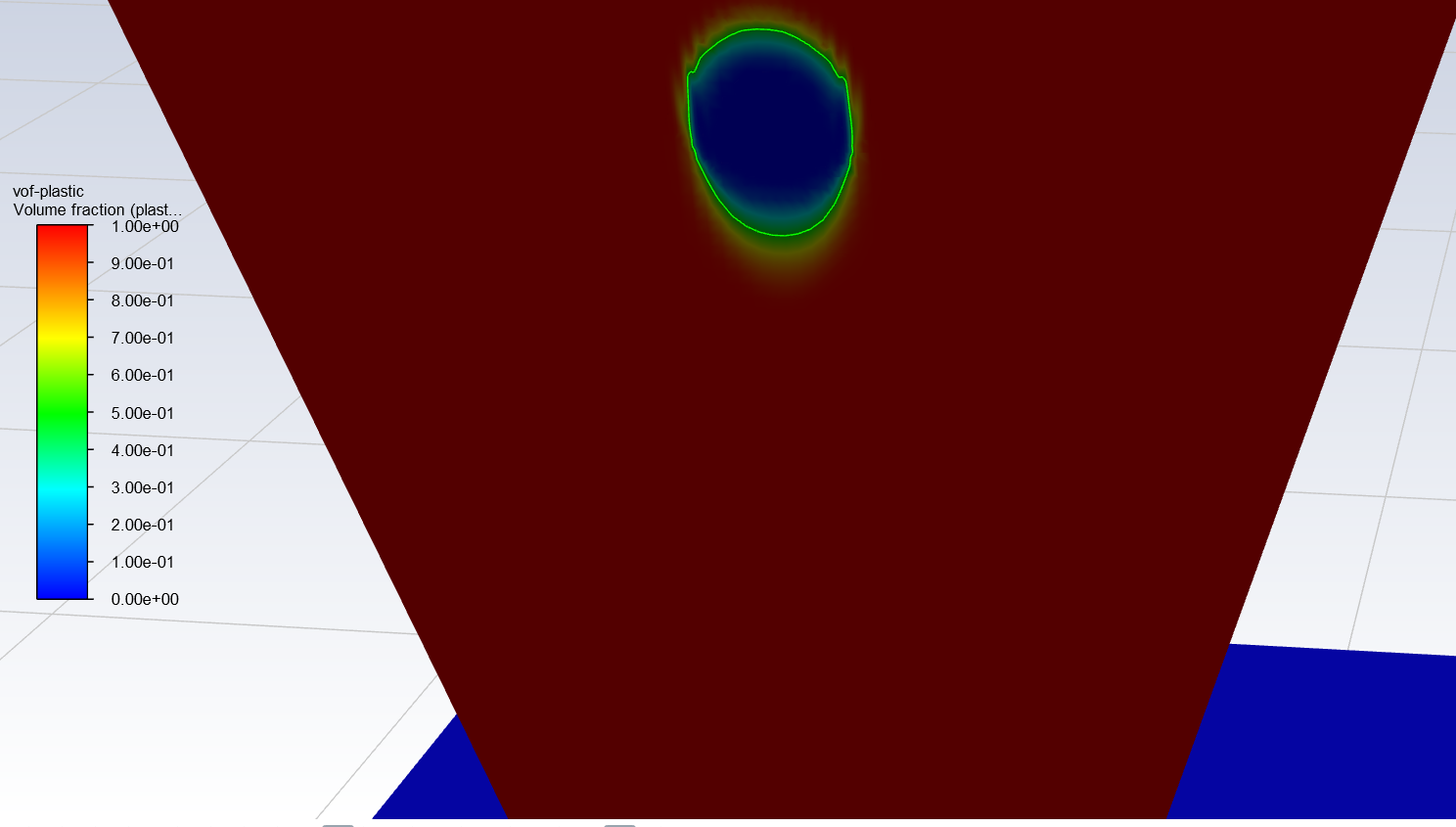

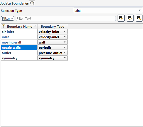

Thanks for letting me know about this. I think I have figure it out to an extent. Although, I am making a mistake somewhere, but I am not able to figure it out. When I patch the phase in Setup, even though I see the phase, there is no interface line and I do not think the phase is being initialized properly.

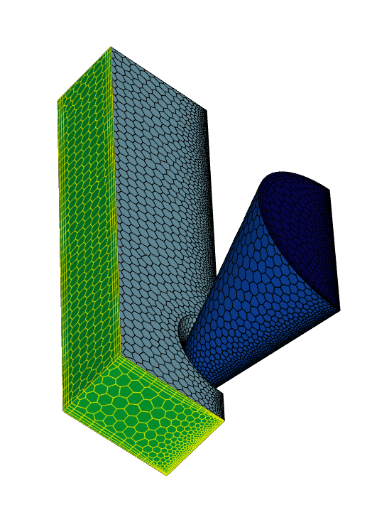

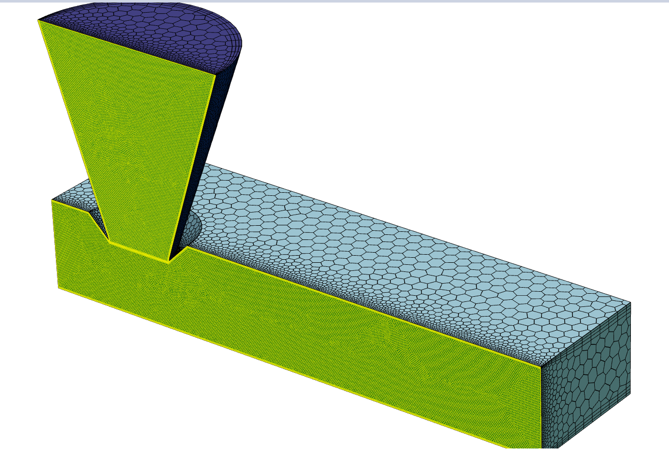

The converging section is the plastic region and the cuboid part is the air region. I am simulating plastic deposition on the bottom moving plate. As seen in the image below there seems to be some region between the two zones. I do not understand why this is happening. The first four images are plastic inlet, air inlet, outlet and symmetry respectively. The last image corresponds to some patches between the two interfaces, that seem to appear for some reason.
And there seems to be something called "periodic" appearing the BC.
Can you please help me out with this ?. Does this have anything to do with the "describe geometry" option?
Thanks for the help.
May 6, 2021 at 11:00 amRob

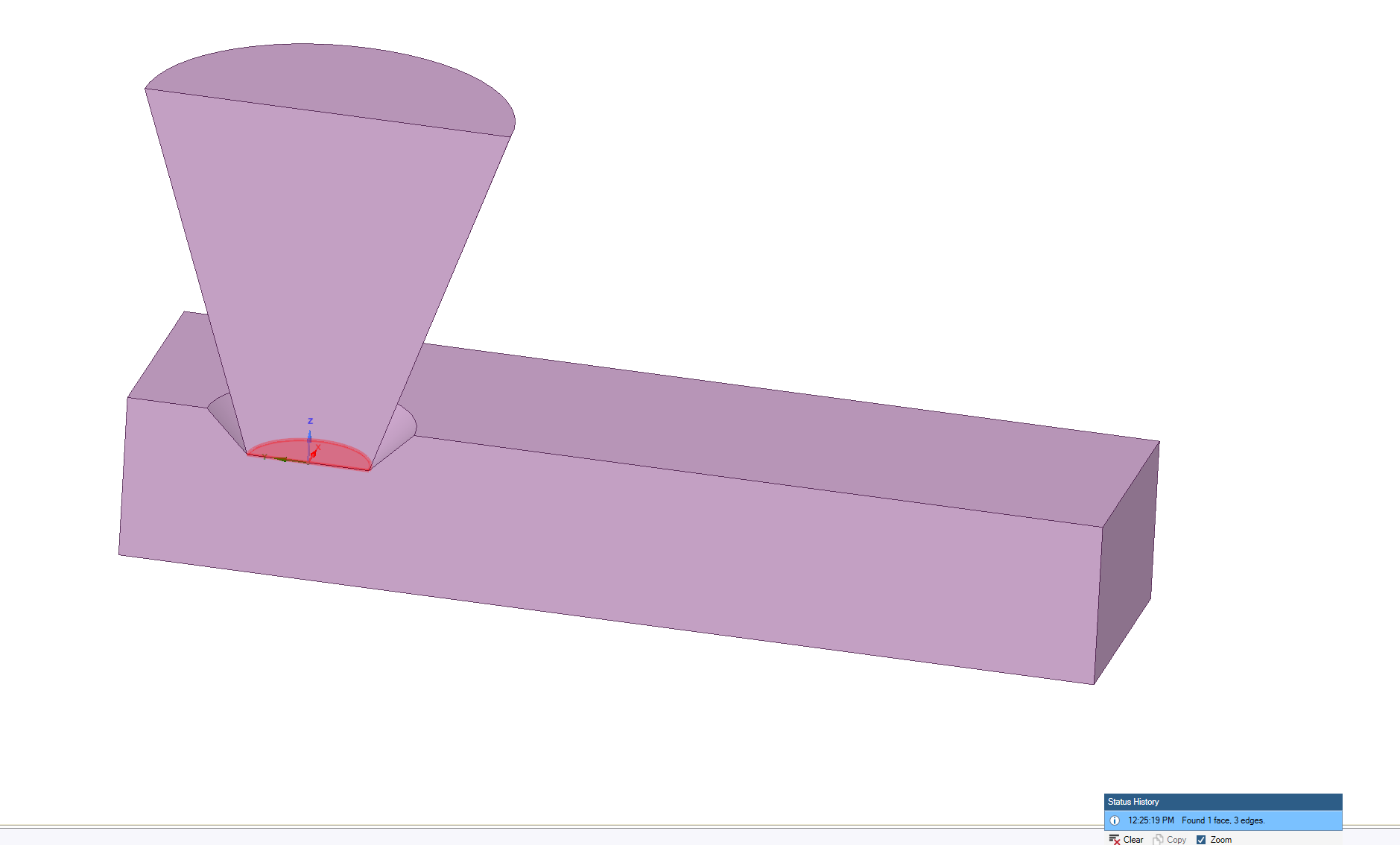

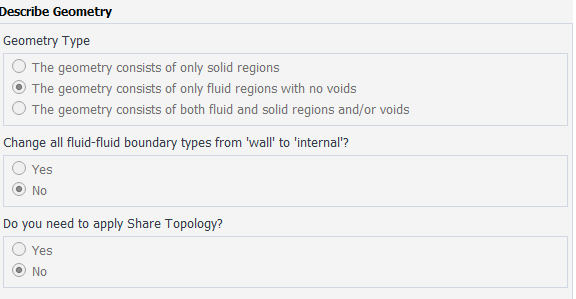

Forum ModeratorDid you do Share Topology in SpaceClaim before moving to Fluent Meshing? The periodic setting may just be the mesher being too clever as the face proximity becomes low, change to wall and it ought to work.
May 6, 2021 at 4:29 pmharshabharadwaj1
SubscriberUnfortunately I still have the issue of the interface line not appearing between the two zones.

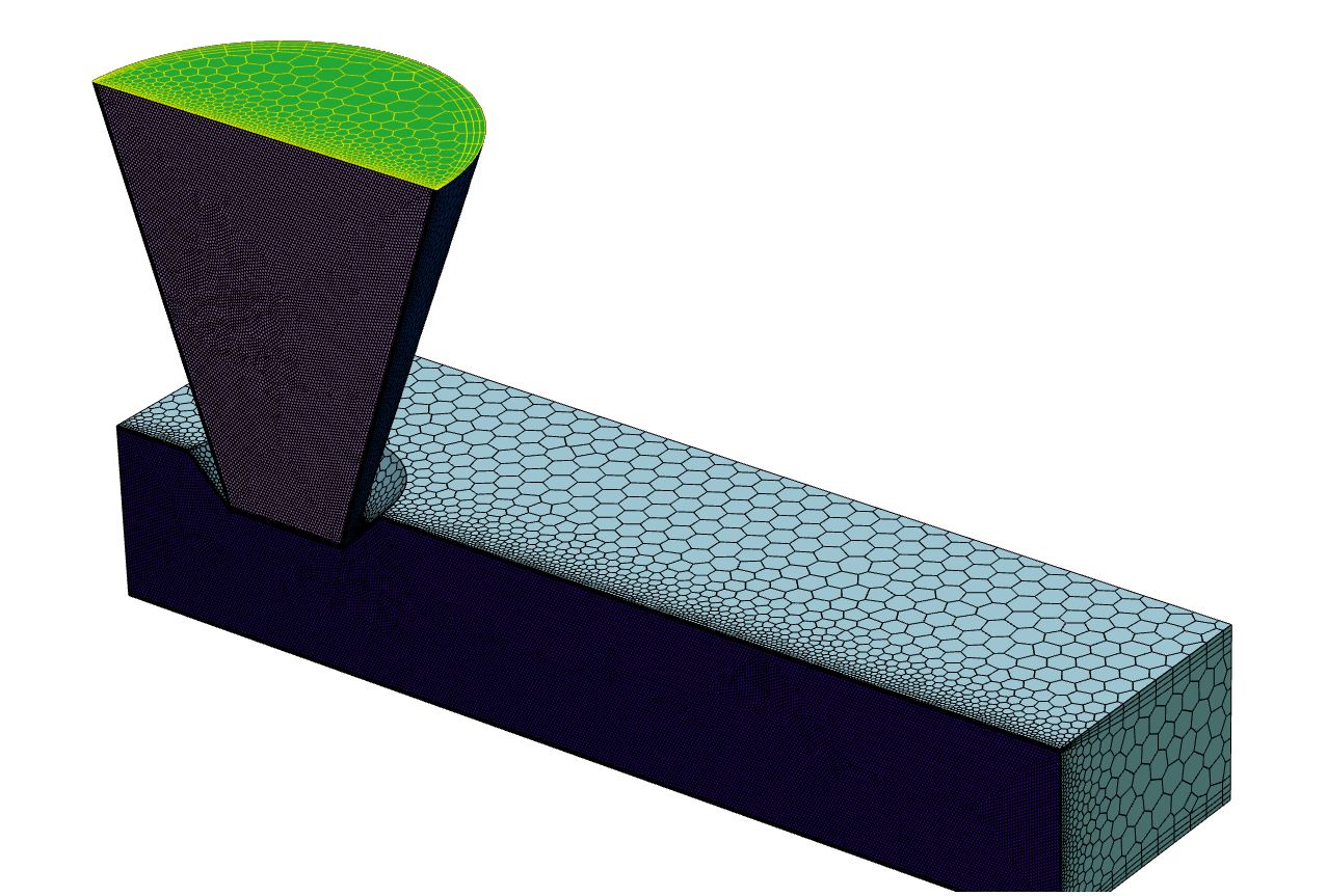

I was not sharing topology. So I went into SpaceClaim and just clicked on Share Topology. One face and three edges got selected. Then, I click on the green check mark to share it.

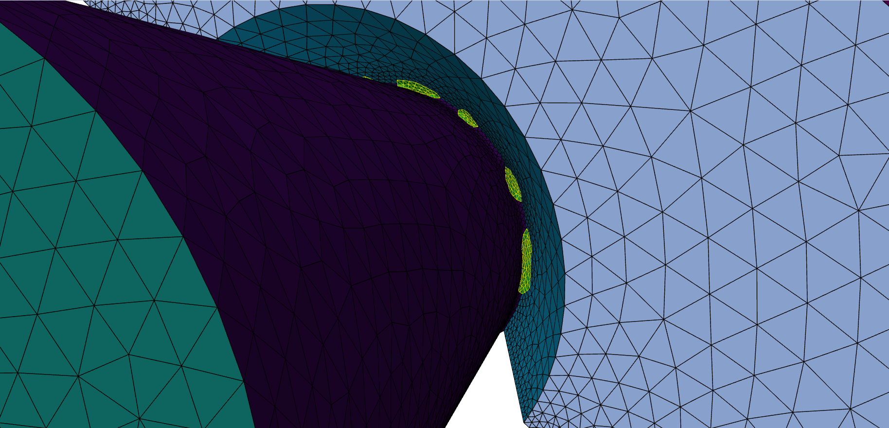

I do not see the periodic setting appear now. But, I still see the region highlighted in the image below. Is it supposed to be like that?. I set that whole face to be a wall.
May 7, 2021 at 11:14 amRob
Forum ModeratorSet the fluid-fluid boundary as INTERNAL in the above. You don't want a wall there. Not sure what's happening with the green face, what boundary zones have you got?
May 10, 2021 at 5:30 pmharshabharadwaj1
Setting the fluid-fluid boundary as INTERNAL resolved the issue. Thanks a lot for the help.
