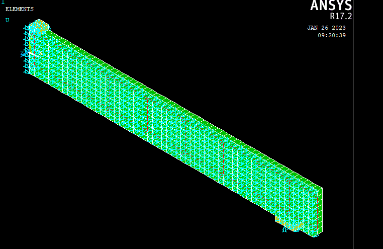

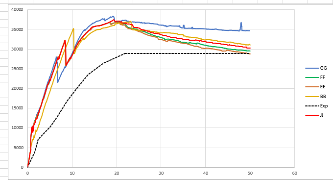

      I've carried out a simple model of a static monotonically loaded reinforced concrete beam using a script. The model runs successfully, however it appears the load carrying capacity of the beam is excessively high, when compared with the experiment. For context, the experimental beam failed at 29kN & 50mm displacement. I have modelled one quarter of the beam due to double symmetry.
      My script uses the legacy solid65, link180 (rebar) and solid 45 (steel support/loading plates). It also utilises the CONCR model, with crack shear coefficients of 0.1 & 0.4 for open & closed cracks, respectively. The script also uses the MELAS curve for the concrete. I've also played around with the stress-strain curve for the concrete, using a idealised curve that stops at the ultimate compressive strength. Use of a full curve with the descending branch makes the model fail prematurely (around 18mm) before the reaction loads turn to a negative value i.e. fail.
      I've attached the script here and wondered if there was anything blatently obvious error wise? I've double & triple checked various parameters...
      Even with use of the idealised stress-strain curve, my highest load is around 8-10kN too high, with the load-displacement curves being quite far apart.
      The script is as follows:

      Many thanks if anyone has the time to read - would be greatly appreciated.

      Hi
      Even though I cannot comment on this (results and apdl snippet - perhaps some other forum users that use this element can), I would like to suggest the current elements (solid187) and using the Menetrey-Wilam or DP concrete models, for modelling this type of structure and failure.
      Menetrey-Willam (ansys.com)
      (Solid65 is an old legacy which is mesh sensitive and can produce different results for different meshes)
      There are many posts in this forum on using this approach and I have written it in an old post (it does not exist anymore as it was in the old forum) a small tutorial on how to do a punching shear example.
      Also in help we can find some examples tech demo 49 and 52
      49.1. Introduction (ansys.com)
      For reinforcement use the reinforcement element/option in workbench.
      /forum/forums/topic/reinforced-concrete-with-shear-reinforcement/
      Hope this helps and all the best
