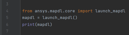

      currently, i'm trying to use Python in combination with Ansys 2022 R1 for the first time using all the packages that falls under PyAnsys. This is the program in question......
      However, i'm running into an issue. When I run this program, it shows a new window saying "Mechanical APDL Batch running with 2 cores requested" but in task manager, its listed as "not responding". Furthermore, when I try to click on this new window, i'm met with the following System Errors:

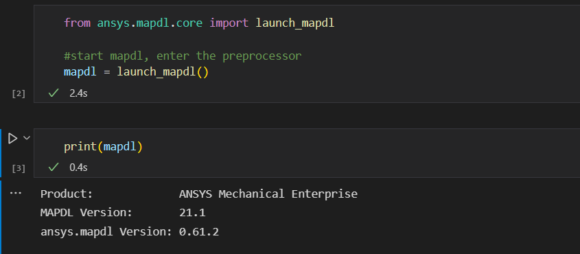

    • Vigneswaran Sridharan
      When you do a pip install pip install ansys-mapdl-core, you should be able to get the installed version using 'print(mapdl)'.
      from ansys.mapdl.core import launch_mapdl
      mapdl = launch_mapdl()
      This automatically searches for the latest local version of MAPDL, launches it as a background process, and immediately connects to it. You can then start sending python commands to MAPDL.
      A successful connection returns:
