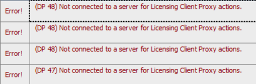

    • rrockxxi
        What is the meaning of these errors?
    • Dennis Chen
      check your client license setting.  you can find this inside your ansys folder by search in the search bar in windows and type in "client licensing".    Once you are there, check the license server setting.
