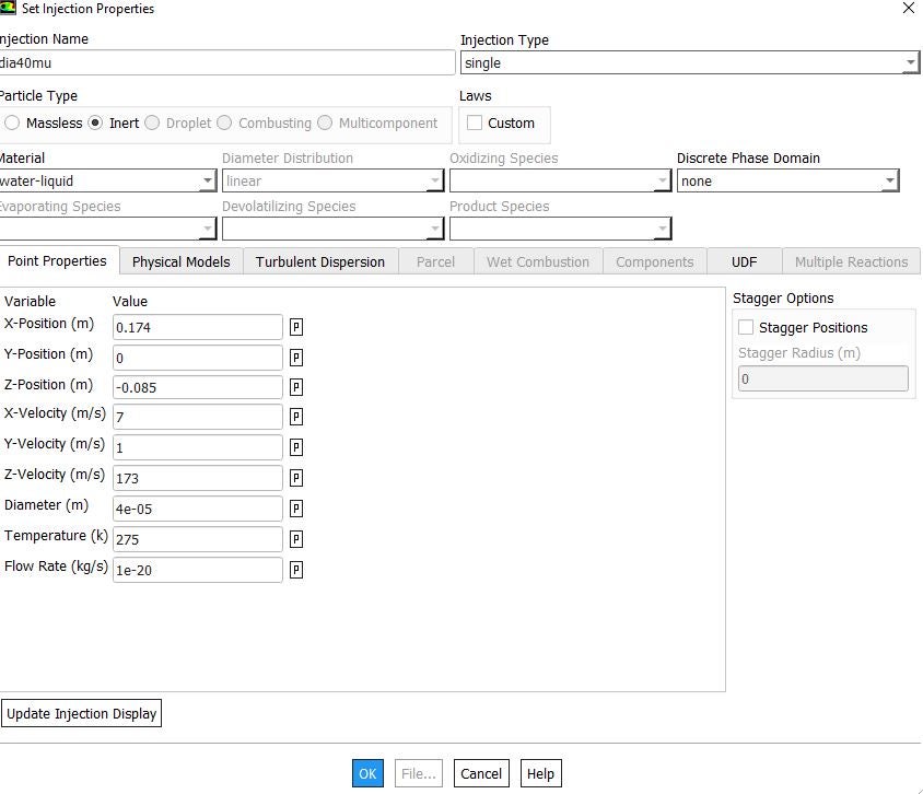

      (3) In order to setup the injection of discrete phase of 'single type', I need to give the values of particle initial x, y, z positions and velocities. Like below figure from ansys fluent:
      (4) I need to set zero-slip velocity at the inlet. I have already got the fluid solution of my case in ansys fluent and so I can easily get gas x, y, z velocities and relative gas x,y,z velocities at the injection location of the inlet.

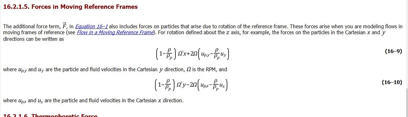

      (5) According to 'ansys fluent theory guide', when rotational (moving) reference frames are enabled, the additional forces are added in particle tracking due to the rotation of reference frame.
      (6) Question 1: My understanding is that 'when rotational (moving) reference frames are enabled, DPM is solving and reporting particle velocities relative to the rotational reference frame. Am I right?
      The theory guide is not giving details of this. It's confusing me. It doesn't tell whether the velocities are stationary or rotational. See figure below from ansys fluent theory guide:

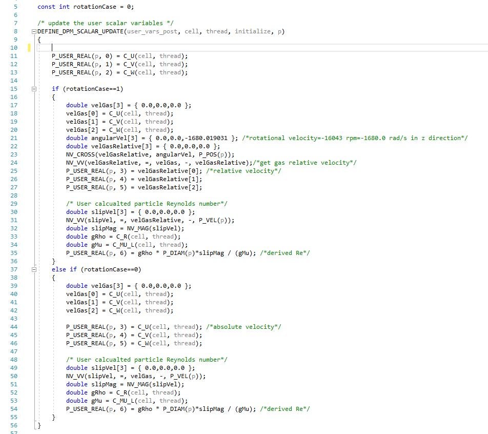

        (1) I use a udf to get the gas absolute velocities at the injection point using 'C_U(cell, thread)', 'C_V(cell, thread)', 'C_W(cell, thread)'.
        (2) As there is no data access macros for gas relative velocties, then I transfered these velocities into the relative velocities using 'Vector_velocity_absolute=Vector_velocity_relative+ Vector_angular_velocty * Vector_position'. The transformation should be correct as I double checked the formulate by comparing the absulte velocity and relative velocity in Ansys fluent fluid solution. I can get almost same relative velocities to the values provided in the fluid solution.

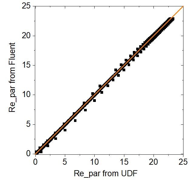

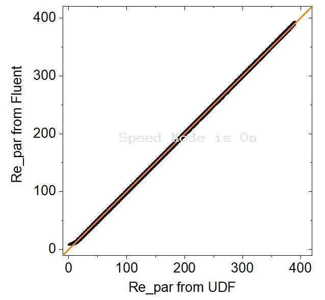

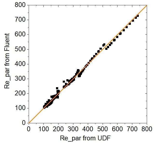

        3> Comparison between Rep by Fluent and Rep by UDF.
        I tried two cases to compare the Rep calculated by UDF and Rep output by Fluent.

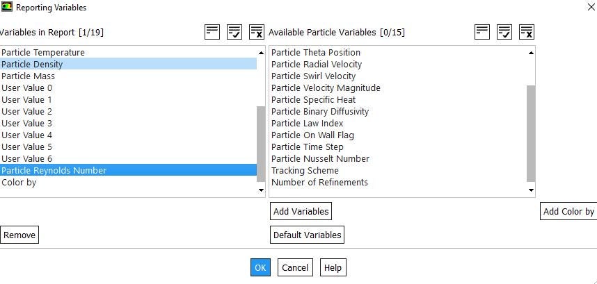

        'Rep output by Fluent' means: Rep is obtained from here:
        Case 1: no rotational reference frame. See figure below:
        Case 2: rotational reference frame (not a 'zero-slip' velocity at the injection location in order to remove 'incomplete' particle tracking).
        As you can see in both figures, the Rep output by Fluent is close to the Rep calculated in the UDF, but they are not equal to each other. I was expecting they should be equal or the difference within 1%.
        4> This is the udf I wrote to calculate relative gas velocity and particle Reynolds number:

        Rep Figure of case 2 (roational reference frame) is not at a condition of 'zero slip'.  This is because if I set zero-slip at the injection location for this case, the particle tracked is 'incomplete' so I changed the velocity.  It is aimed to understand whether I can get same Rep in UDF to Rep reported by Fluent.
        Please see figure below Case3. Case 3 is 'zero-slip' and all other settings are same to case 2.
