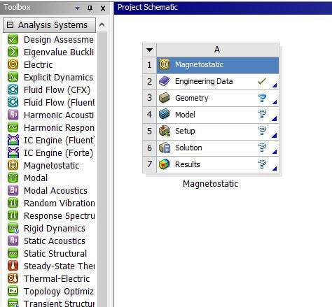

      I downloaded Ansys Workbench 19.2 and as shown in the picture there is Magnetostatic tool in the toolbox, does this mean that this Magnetostatic tool uses the Ansoft Maxwell solver or the Mechanical APDL solver. I'm asking because I found an online help of how Mechanical APDL handels magnetic analysis.

      No this is not the Maxwell solver. You will also have to install the matching version of the ANSYS Electromagnetics Suite. After this installation you will see options in this list for 'Maxwell 3D'.
