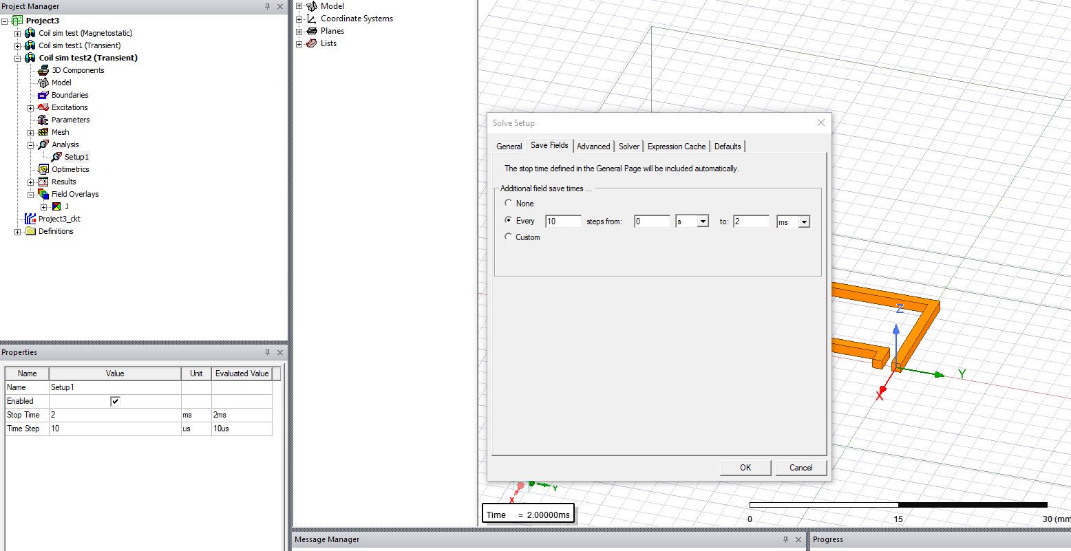

SubscriberI want to generate an animation for the J field in a coil. However when I try to create the animation, only the last point of the simulation is available (see screenshot below)

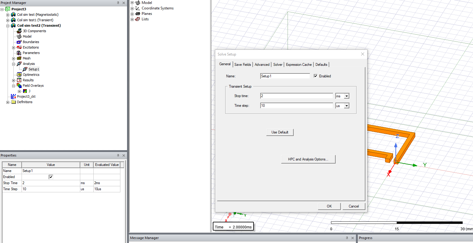

Forum ModeratorHi @MaI_21 I am getting all step values for animating the J plot.
Cross check the general tab in the analysis setup.
Please go through ÔÇ£transient setup (3D)ÔÇØ section from Maxwell help document for more details.

Forum ModeratorHi @MaI_21 I didn't face any issue with the same analysis setup as you have posted.
Please try deleting the results, Copy and paste the Maxwell design and after analysis, plot J field again.
Thanks Chinmay.

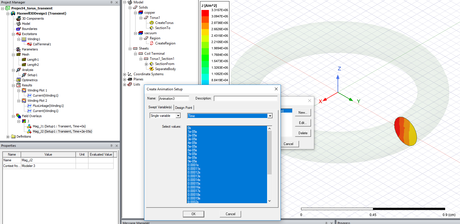

SubscriberHi Chinmay I insisted and finally it worked out. I do not know if the problem arose due to a corrupted model or because the coil was with open terminals and external excitation. Now I realized a simple torus with internal sinusoidal voltage excitation. This results in the picture below and correct animation of the J field. I am also able to select any of the samples to show the field at any time instant.
