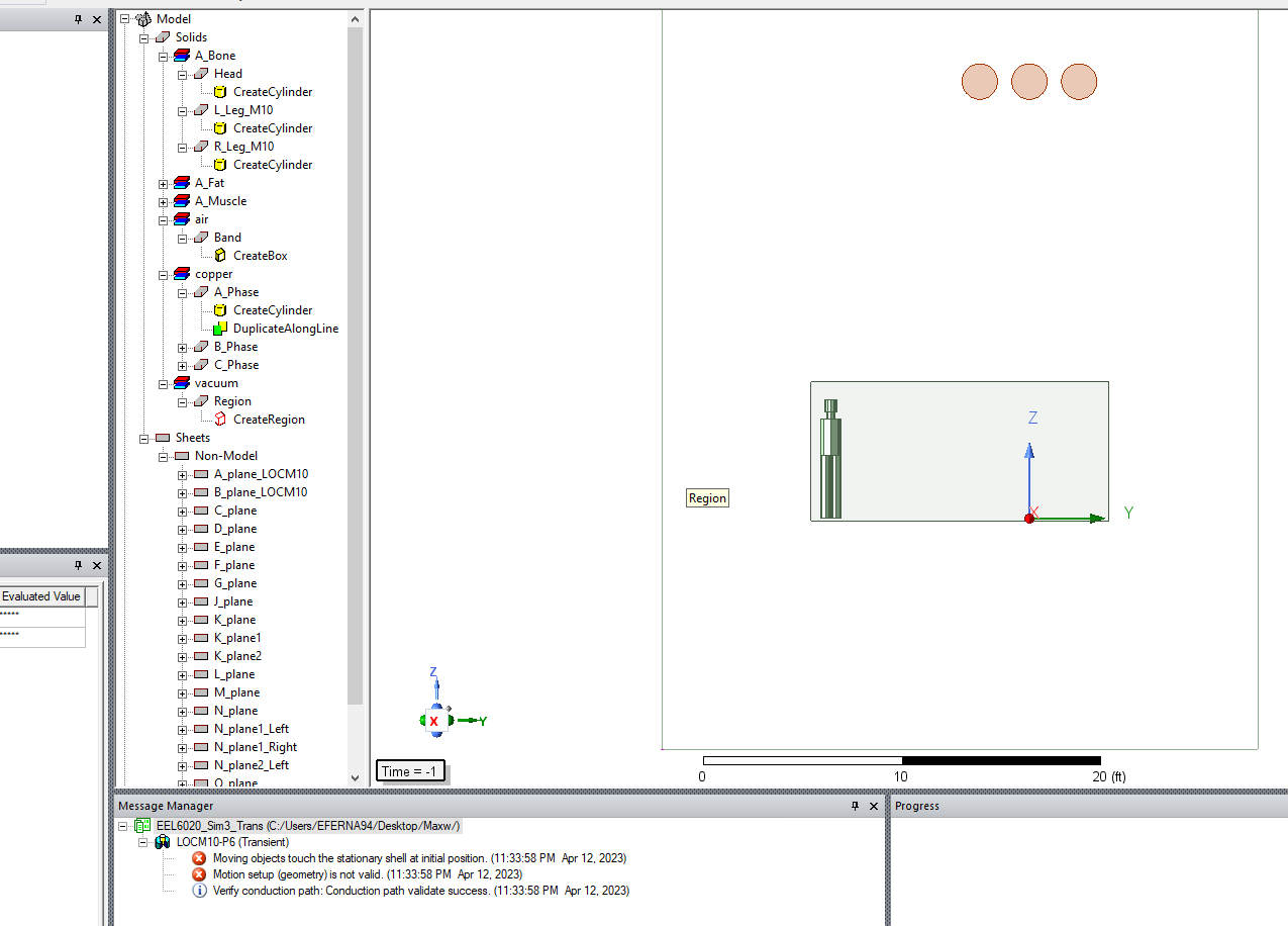

      I am using the Magnetic Transient Solver and I am getting some issues that prevent the tool to run. I am trying to simualte the movement of a body(in this case a person under Tramsmition Power lines. There errors are   moving objects touchs the stationary band at the initial position and  motion seet up is not valid. Any tips? I am leaving a snip
    • DELI
      Hi, all moving objects need fully be fully nested inside band object and there should be some gap to band boundary.
